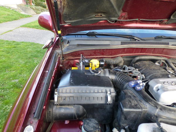

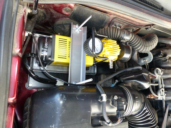

Here are a couple of pics of what it looks like installed.
Overall, I am very happy with the setup and it was super easy to install. I keep the alligator clips and hose stored in the cabin and I can quickly get it setup to inflate tires (primary use right now). The TJM has rubber feet and fits perfectly in the battery tray. When tightened down with the battery bracket it stays in place and doesn't move at all while running.
Just thought I would share. I will post a few more photos of the mount and battery tray later. I'm happy to answer any questions regarding the setup.

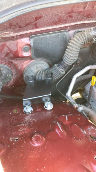

Here is what the Z bracket looks like installed in the Fender. I needed a few extra spacers to level this out and raise it to the height I wanted.

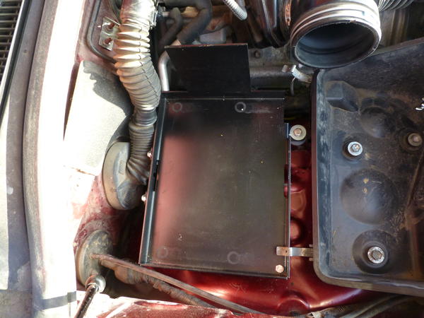

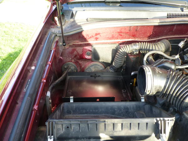

Here is what the battery mount looks like by itself. Note the raised edge on the right hand side is what I cut down ~1" to be able to fit the compressor.
