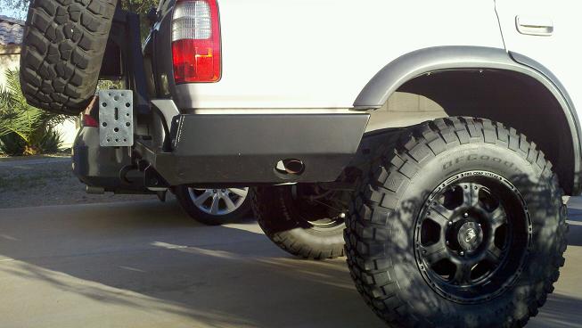

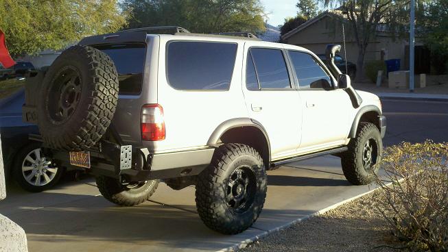

I try not to toot my own horn, but my truck build has most of the modifications that you would want for this type of travel. Armor, relatively close to factory specs, some lift, and upgraded systems. My sig line contains a link to my build thread.

That truck looks familiar!
Well its nice to see what my truck would look like with a rack and winch bumper on it. When I first read your post I was immediately interested because I am slowly building my own expedition vehicle. When I scrolled down and saw that you had photoshopped MY picture with MY truck I was quite surprised. I am flattered that you chose my pic to "modify". I am currently waiting on a Shrockworks bumper (and already have the winch) to install later on in Feb. and will be sure to post pics when it is finished. I WILL say that the Sonoran Steel 1.2 suspension set up I have works flawlessly so far for the wheeling I do. I have a CBI rear bumper with a tire swing out, 60" extreme high lift, and gas can carrier installed and the added weight seemed to smooth out the rear suspension. You should go to http://www.sierraexpeditions.com and check out what they have for some of the "list" of things you describe. Will and his employees are passionate about 4wheeling and have a great knowledge of what works and what doesn't. Feel free to PM me if you would like to discuss more in detail, otherwise, do what most of us do and visit different forum sites, including this awesome site, with questions and gain some knowledge and ideas of what to do with your future purchase. Good luck and I look foward to seeing your progress!
That was your truck? Lol to that...
I did a google image search and found that...
Its a very nice truck. I saw it as a perfect platform to add the things I wanted, Funny you say shrockworks as the one I put on there is shrockworks aswell. I bet My truck will look exactly like yours as I build it up. You are a few phases ahead of me. and yes definitely we will keep in touch as we hit obstacles during these rig projects, since our purposes are aligned.
