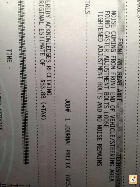

After doing research and inspecting my truck today, again, i think i found the problem. Will confirm tomorrow, but I think Upper Ball Joint went bad:jaw:
Here is an update. I finally got pissed and went to stealer. Frkn alignment shop!!!
What he said^^^
Glad to hear you got it figured out... Too bad it cost you what an alignment would though. Thanks for the heads up. Hopefully I don't run into the same problem, but if I do at least now I know where to start.
Thanks guys! I will go and ask at least for free alignment. The problem is that the time between the alignment was done and noise fixed are too far apart. They might say why you didn't come back sooner.
