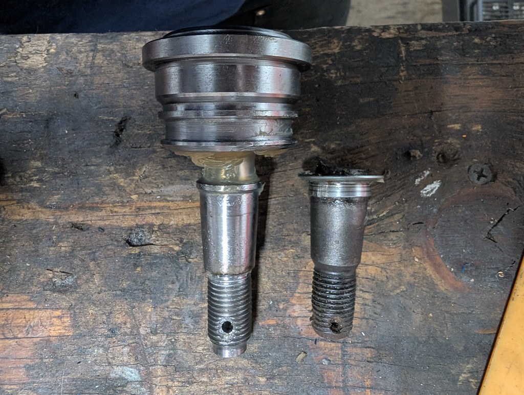

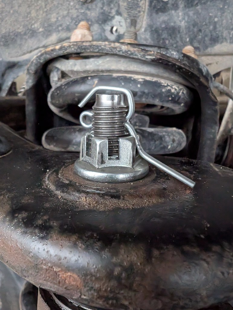

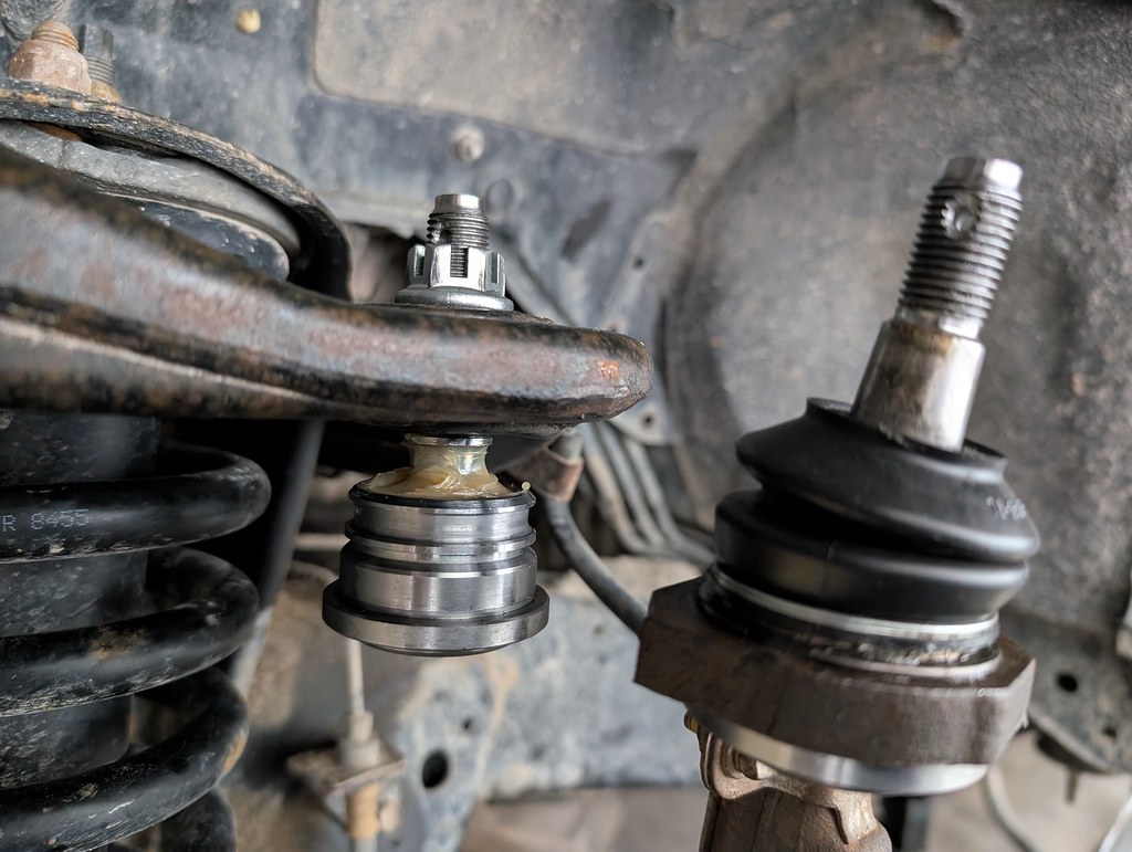

555 LBJ (SB3561) Cotter Pin Above Nut?
Personally? I'd torque it to spec, shove the cotter pin in there and call it done.
It's a safety tether, not something maintaining tension. I would avoid washers.
I wouldn't consider 555 Aftermarket as they make the part for Toyota aren't they considered oem?
Though this is the upper ball joints - the lower ball joints from 555 direct have long been known to be different (and inferior) than the OEM lower ball joints - even if 555 makes them (which we don't know for sure). Seems reasonable that the upper ball joints might be the same situation.
Just seems like a penny-wise, pound-foolish way to save $$$. The factory upper ball joints last 200k+ miles and 20 years - why risk aftermarket? (half that for lower ball joints, depending on use...)
-Charlie
Get different ball joints.
The cotter pin going through the castle nut is important.
The cotter pin is soft metal.
In a fight between a loose nut and cotter pin, the cotter pin will lose.
