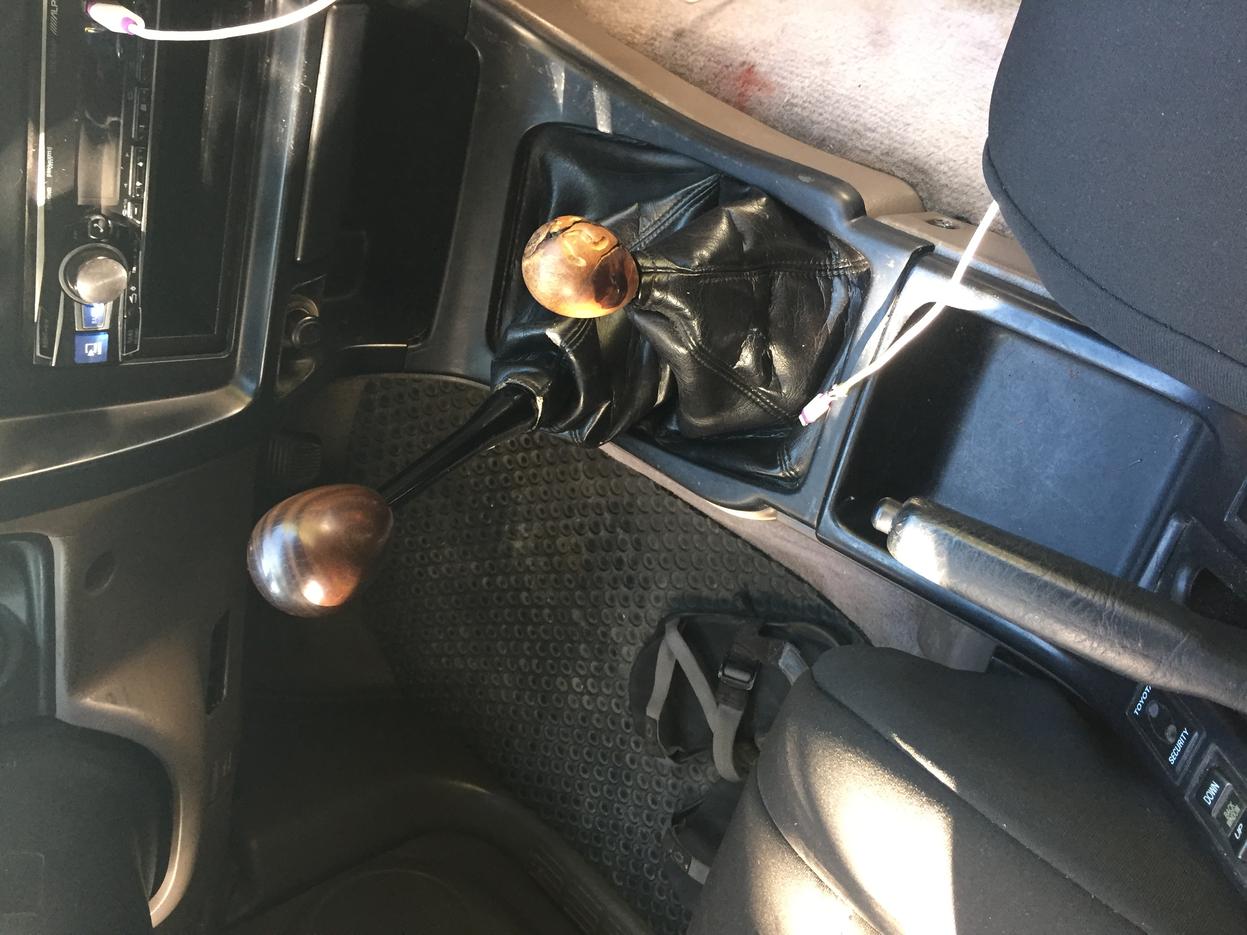

I actually had to cut out a little more of the shift lever hole to get the manual and J-shift to fit. The manual cover went completely over the hole. Remember that you are going to either have to ground the starting circuit wire or run it over to the clutch to get it to start
If I were to cut the exact hole needed I'll have 2inches on the back side open to the elements the cover won't cover it
did you cut the front of the whole or rear? i know you have to cut the middle to make it one big hole thats a given. but as i measure it up it looks like the hole needs to go forward more? correct me if im wrong

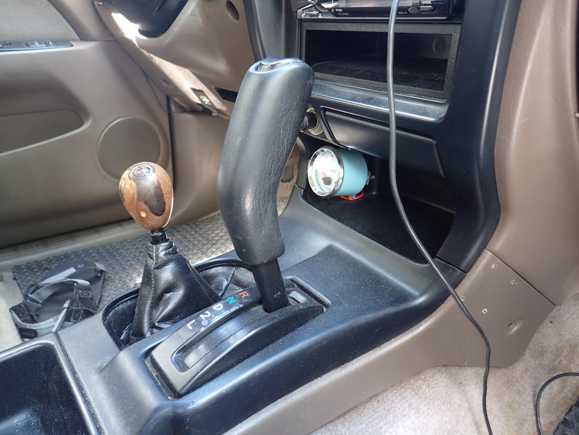

I juist had to cut out the middle for mine. I would just cut out the middle for now and then install the transmission(without the gearshifts obviously), Then try to install the gearshifts once it is in place. Then you would only have to trim the minimum. I have a memory in my head of flipping the j-shift lever 180 degrees because the auto and manual transmissions line up differently but I would never trust my memory to actually chop your car up with! Some advise from someone who has chopped up way more things than i should have. Do not chop anything up unless you absolutely have too
Easier with pictures, the auto shift lever is on the passenger side with the j-shift on the drivers side. The manual shift is on the drivers side with the J-shift on the passenger. Same j-shift case, but the shift lever is angled in the opposite direction

Thanks I just winged it and made a rectangle. Just enough for the shifter cover to fit over!
