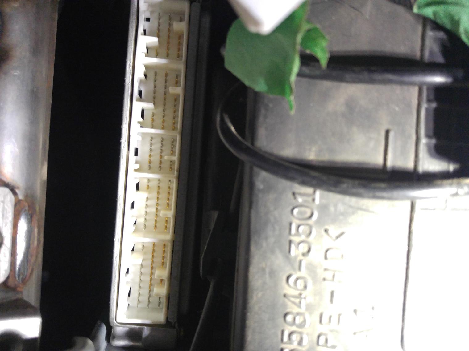

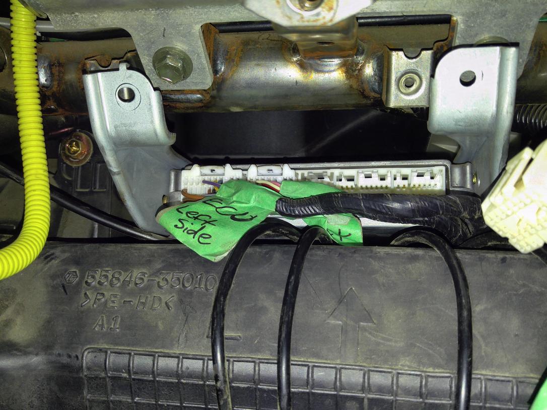

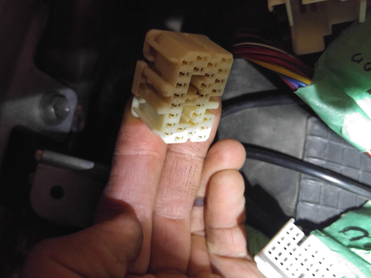

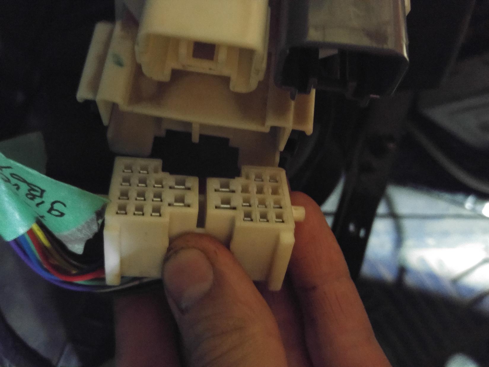

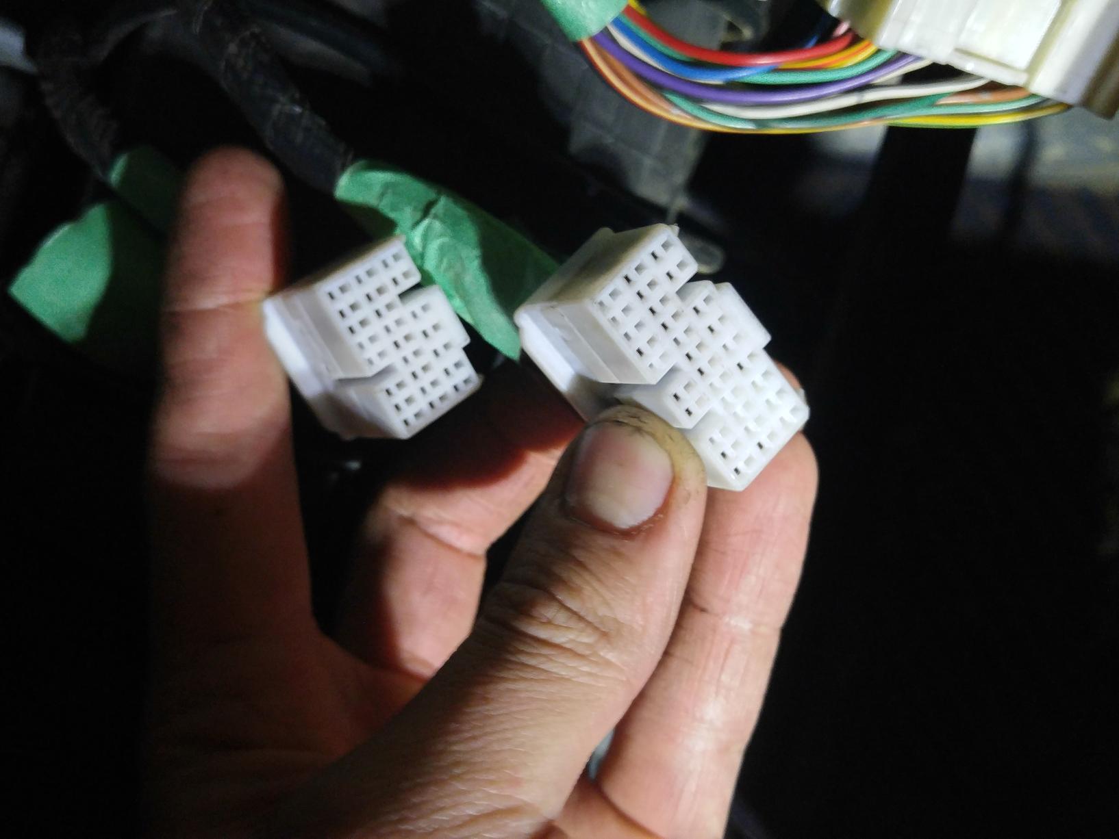

Okay here are better pictures.
First one is the 99 manual ecu
2nd one is the two plugs coming from the 99 manual engine harness that plug into the 99ecu
3rd one is the plug I have to repin to the two dash harness plugs from the 99 manual
4th is a plug from the engine harness going to the glove box (plugs in fine)
