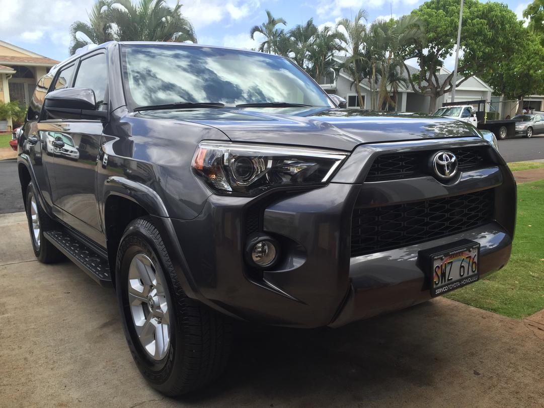

Sorry for the bump. Newbie here, got my 4runner SR5 last Friday.
I've been doing research and such before posting but I just want to get confirmation from other members.
According to what I've been reading, a 1.5 inch leveling kit is the most I should be going up front in order to level everything out and not have a reverse rake look. I found this kit, anyone have experience? https://www.amazon.com/dp/B0064U7IIW/ref=wl_it_dp_o_pC_S_ttl?_encoding=UTF8&colid=1V9LE6R5M5Y7V&coliid=I3B7VH9YFSN1AS
Next question is, as a hobbyist off-roader, I want to be certain the stock SR5 suspension will be fine for my purposes. Not doing anything too extreme, mainly novice/intermediate trails that are riddled with smaller rocks. I just don't want to be throwing in time and money into a leveling kit if I will need to upgrade to coils in the future. I found this post http://www.toyota-4runner.org/5th-gen-t4rs/143767-stock-sr5-suspension-limits.html but it never really got into the capabilities of the stock suspension.
Any information is helpful. Thanks!
You'll be fine. The 4Runner is very capable off road right out of the dealership. I only swapped springs after I began adding weight.
Roger that, thanks for the input. Now I need to decide if 1.5 level kit will be fine or if I should rock 1.5 spacer in rear and 2.5 spacer up front.

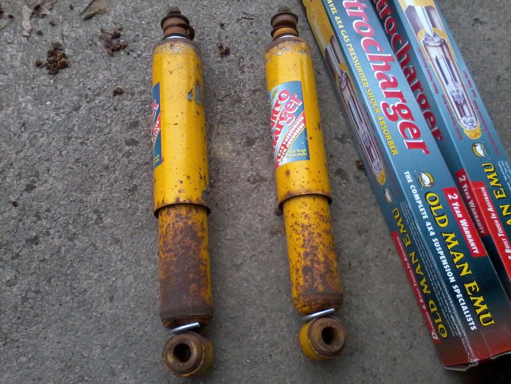

Been searching and maybe have not found it yet. But does anyone have any knowledge about climate, humidity, salt, etc. effects on aftermarket suspension components. I had a guy at a off road shop try to tell me that its a waste of money to put aluminum (more $, ICON, Fox, BP51) suspension on my truck and just stick with the steel bodied components. He was pushing the OME yellow bodied shocks and OME coils. He said the more expensive are for dry desert type locations not for east coast humidity, snow, salt, etc. Does not sound correct to me. Please chime in if you have seen reliability compromised based on environmental conditions for the different suspension options.
The Yellow paint on the OME gives way much faster than the CAD plating on these aluminum suspensions. We suggest coating either shock type with a thick layer of heavy duty carnuba wax before install and after rebuild to add an extra protection.
FK also makes coilover protection spray but its hard to find. Its just a thick waxy type spray.
Thank you for the response. And the pictures to show the rusting. I knew something was not right about what I was being told. Maybe he was pushing them for a different reason??? I am mainly wanting to get a very reliable overland type set-up that meets the following:
