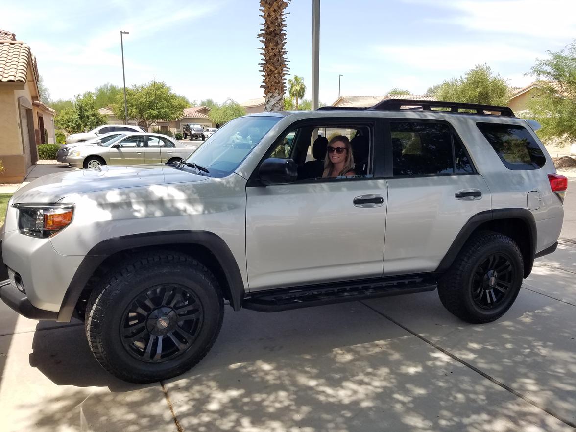

Just picked up a 2012 TE with KDSS a couple weeks back that currently sits stock. If I get the Bilstein 5100 Complete Set is there anything else I need? Just looking for a smaller lift (maybe 2.5" - 2") to throw on a little meatier tire and give myself a little more ability for my camping trips and Arizona exploring with my wife and dogs. Any advice or recommendation would be cool.
Dont get the 5100s! Get the 6112s which are made for 4Runners are MUCH BETTER shocks for the front and come with the srpings too. Get them from Total Performance.
The way you lift the rear is your preference... you can get a spacer for the coil spring, or get new coil springs, ... just make sure the rear shocks are longer,... a lot of people use Icon 2.0 rear shocks for the rear.
