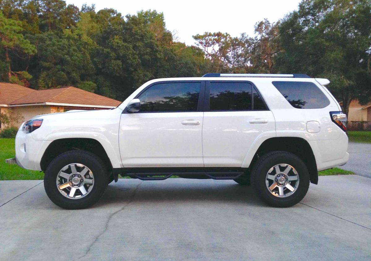

Thought this picture might help in your decision making process.
I assumed so. Don't have the cash for bigger tires yet so don't want to lift too much or else it'll look stupid. Just going to level the front... I assume to change the adjustment it's the same process as just replacing the strut. Except instead of putting a new strut in, you just take the strut out, reset the collar and put the same strut back into the coil and reinstall?
T4R - 8:24:16 - After Lift.jpg
I think it looks pretty good at 2.5F/2.0R, and I won't have to change a thing when I go with new tires.
  • T4R - 8:24:16 - After Lift.jpg
