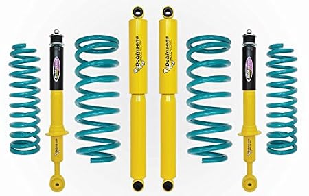

Has anyone tried or have experience with Dobinson Suspension? They seem to be made in Australia and similar to the OME kits, but they offer 2" of lift instead of 3". This seems like a better option for what I am looking for and may be able to aligned without new upper control arms?
The front spring are pretty much the same rating as the OME Medium kit (~580lb/in stock?, 590 OME 2884, 585 Dobinson C59-300) and rears seem like a good compromise between stock and OME heavy (180lb/in stock?, 260lb/in OME 2889, 220lb/in Dobinson C59-325).
The kit comes with gas charged shocks as well and they do offer heavier springs.
Personally, I like the stock ride, a tad bit stiffer and more controlled is ok with me. I like the rake, I am not looking to eliminate it as I like the vehicle to sit flat when loaded/towing, not sagging.
I had an OME kit on my prior LC80 and really liked the way it sat and rode, albeit just a touch firm.
Just curious, but the kit seems very temping (other than the spring color :p).
https://www.amazon.com/Dobinsons-To...d=1475237708&sr=8-4&keywords=ome+4runner&th=1
Hey dude, we have 2" and 3" lifts. Just not all the parts are in for the 3" yet, so it's not up on Amazon yet.
You can customize this, and order whichever coils you want to get the right combination.
