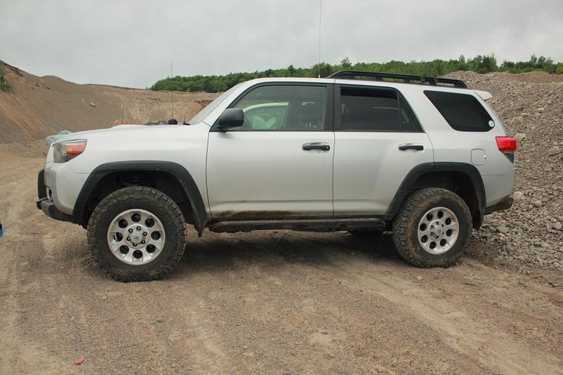

I have the Toytec/Eilbach on 5100's. You can do it for sure.

Why don't you do what I did and get a 2" OME kit? 883/895E provided 2" of lift, maintained factory rake and rides much better overall (stiffer for sure, but better). Might as well go with what you have experience with.
I did get Camburg Balljoint UCA's just to be safe, but according to others you don't NEED them.
I like that idea as well. I've read about using the 895E in the rear to level the stance, I missed the 883 front though. Thanks for the info.
I see you are running that setup, do you have any pictures of how it sits? Are you happy with the UCAs? Any noise or negatives with them?
I've only had the lift on for less than a week but so far I'm thrilled with it. UCA's are great, I got 3.5 degrees of caster dialed in no problem and they don't make a sound. Like I said I got 2" all around and at worst I'll have a level truck or still a little rake when I load it up with camping gear/dog.
