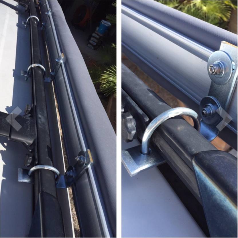

Good job. I’ve been considering an awning but I thought it wouldn’t stand so high off the roof. How’s the awning bracket holding up to wind and vibration at highway speeds?
246281d1491258453-awning-mount-directly-16-trail-oem-roof-rails-image003-jpg
(Not my pic)
Well my awning came in Friday so I had to crudely rig it up similar to this for my weekend camping/wheeling trip.
Fine on the road but on the trail it would wobble pretty bad. The L brackets are stout but just on the one rail isn’t that stable.
Now attached to the new setup it’s night and day difference. Doesn’t wobble at all. 70mpg no noise although I’m going to have to come up with a wind deflector. These bars are howling pretty loud. Tilted my sunroof open and it stops.
