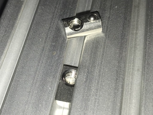

Haha, I've built a lot of stuff out of 80/20, and I don't think I've ever managed to get all my slide-in connectors inserted without having to disassemble part of my project after forgetting them! The roll-in connectors solve the problem most of the time but some of the special connectors have to slide in.

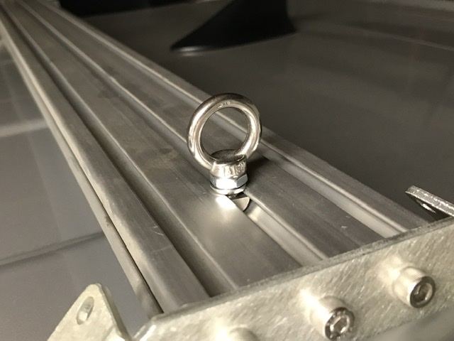

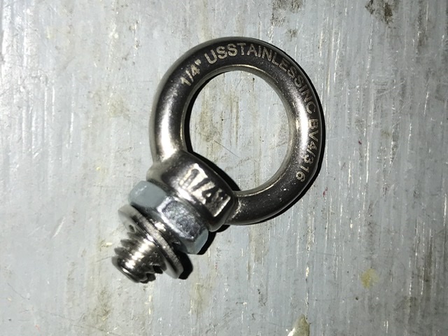

To add some additional capability for light duty mounting of items I used your idea of “roll-in” slot connectors to attach eye bolts to the top of the rack.

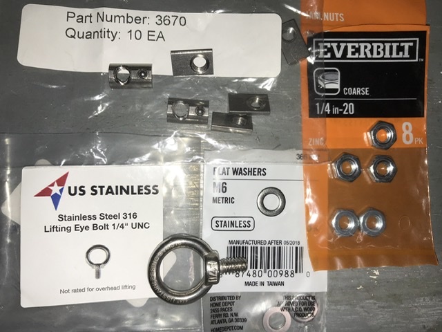

Parts:
- 80/20 Inc, 3670, 10 Series 1/4-20 Roll in T-Nut with with Ball Spring (10 Pack)
- US Stainless Steel 316 1/4" Lifting Eye Bolt 1/4" UNC Marine Grade Qty 4
- M6 or 1/4 inch flat washers
- 1/4in-20 jam nuts Qty 4
You can slide them anywhere you want in the track, and you can remove them. The jam nuts allow you to adjust the position and snug down the bolt. I would not use this for strapping down really heavy items, but it’s good enough for attaching things like tarps or traction boards.
