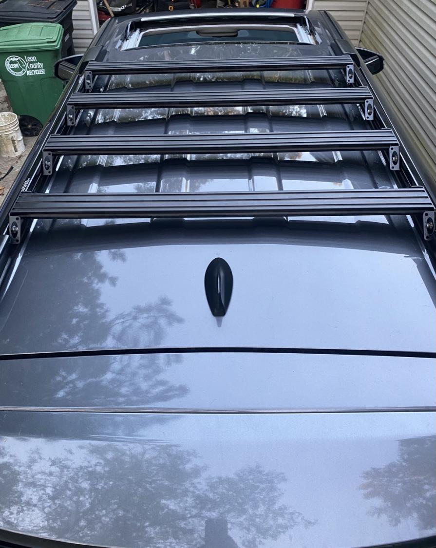

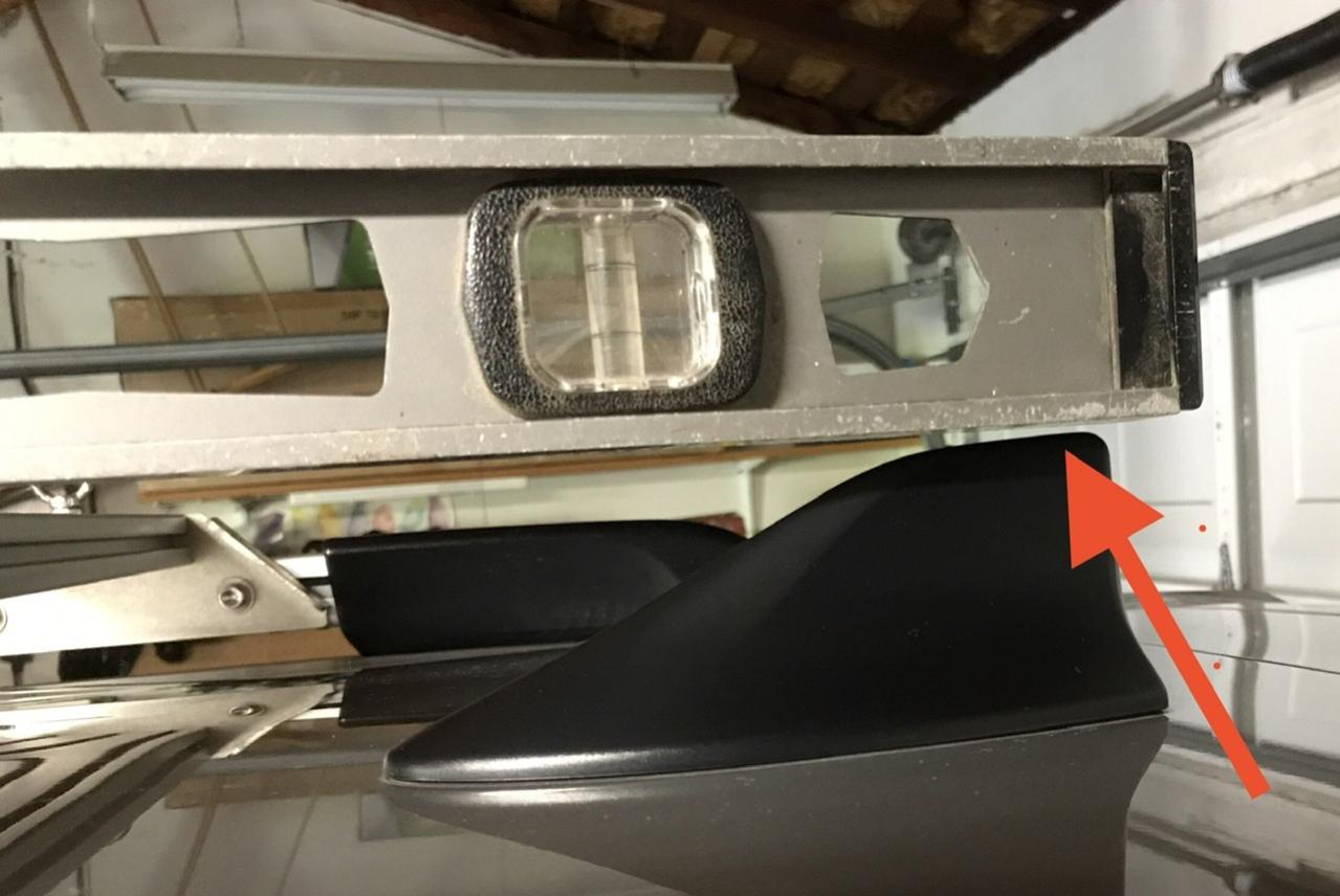

Love the look and design of these crossbars — very nice work. One question I had was, are they higher than the antenna fin? In other words, for example, would a load of lumber sitting on the bars clear the fin?
Another question: if I wanted spray the hardware black, what’s the best paint to use?
I set a level across my rack (on a 2018 ORP). The top surface of the rack is about 1/4 inch higher than the fin.
Since I wanted to keep the silver color I rattle can sprayed them with a gloss clear coat. I used Krylon Color Maxx, but any good indoor/outdoor spray paint would work. The brackets have a fine wire brushed swirl pattern on them, so all you really need to do is get them real clean before spraying. I used isopropyl alcohol to wipe off any remaining oxidation and oils. Then let the paint cure for a day or two before installing them.

Thanks for the measurement. Seems maybe a little too close for comfort if you need to have something extend off the rack over it.
Thanks for the paint info as well.

You could always put a 1/4 or 1/2 inch strip of wood on top of that last crossbar, then lash down your load, to give you more room above the fin.
Thanks for highlighting that as a concern. I actually thought of that because I don’t own a truck and I do a lot of projects. When I do haul wood it’s mostly lumber and I have a tendency to strap it on one side or the other and not the middle.
Also, to deflect the bar enough to touch the fin with what you are carrying it would have to be very heavy. I stood on one of the bars and it deflected just a bit. I weigh around 270.
As Electoboy mention, you could always put a board under the load to increase the height.

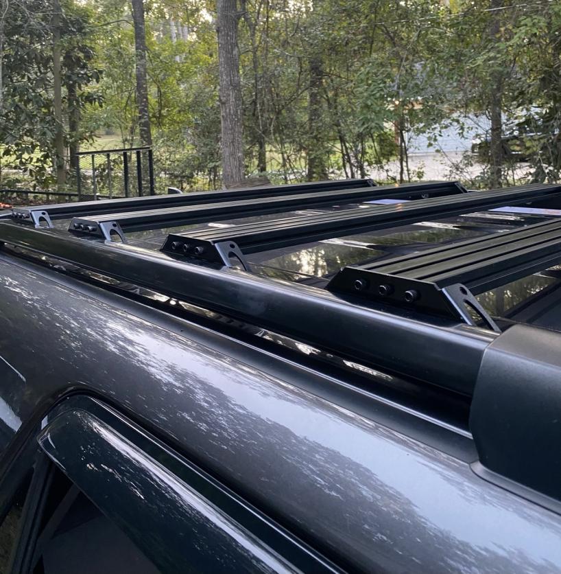

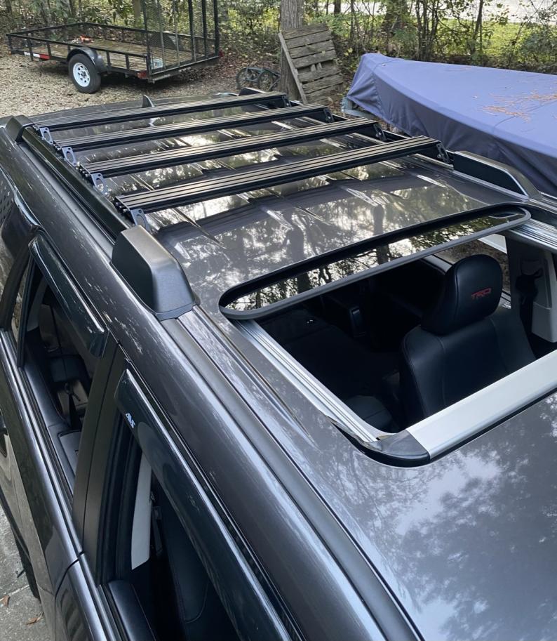

Put mine on today. I painted the brackets/hardware with Rustoleum gloss. I can’t wait to use it
