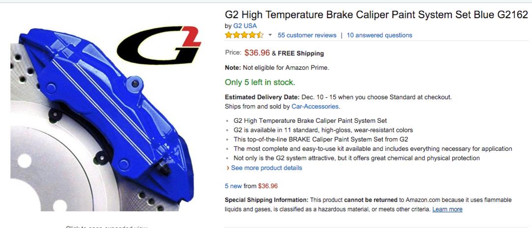

I've since ordered a set of G2 brake caliper paint for $37.00 from Amazon (photos attached... see here for some caliper paints for sale on Amazon) . I seems to be a good paint system, but my impression is that you need to follow the directions carefully (multiple thin coats of paint, proper cleaning beforehand, and also pay attention to the recommended working temperature range of 50-70 degrees F when you paint and let the calipers cure for 24 hrs).
So I'll need to find a weekend to put the truck up on jack stands, clean everything with the brake cleaner that comes with the set, then remove the calipers, bring them inside to the basement, let them warm up to at least 50 degrees F, and then paint them and let them cure for 24 hrs inside the basement.
The directions state to paint and let the paint cure for 24 hrs at a temp range between 50 and 70 degrees F, (and it's much colder outside this time of year).

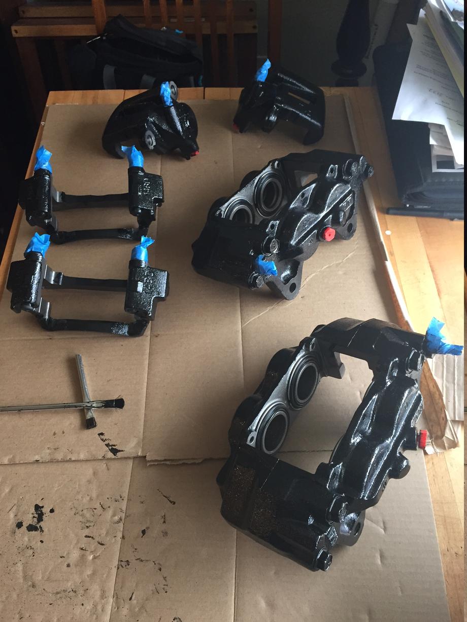

Preview of tomorrow's project
The brake upgrade has commenced. A little preview of what I've done today in prep for tomorrow's project:
