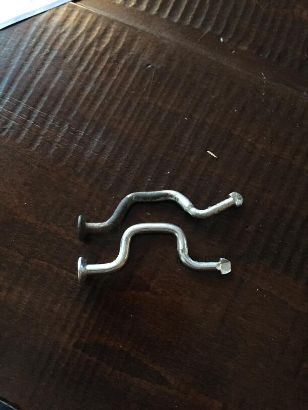

Right rear aft parking brake shoe retaining pin was somehow bent. This allowed the shoe to not be retracted far enough (even with the adjuster at full contraction).
So I'll order that up. In the mean time I've removed the majority of the components in there and zip tied them secure and I'll be without a parking brake until I get the parts.

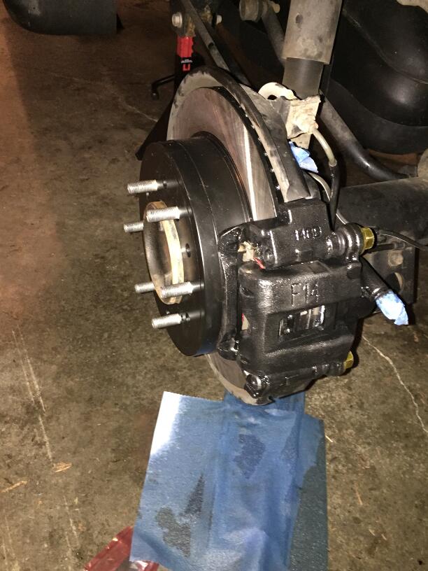

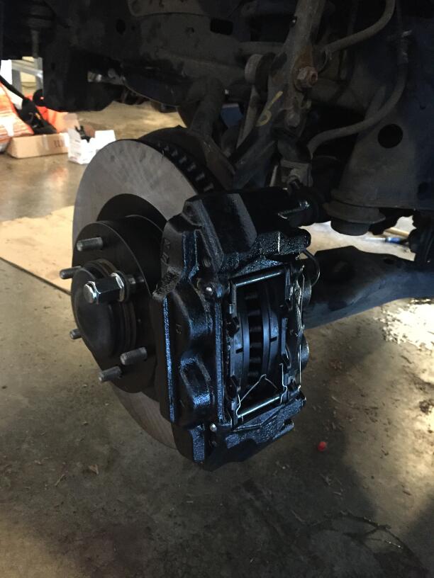

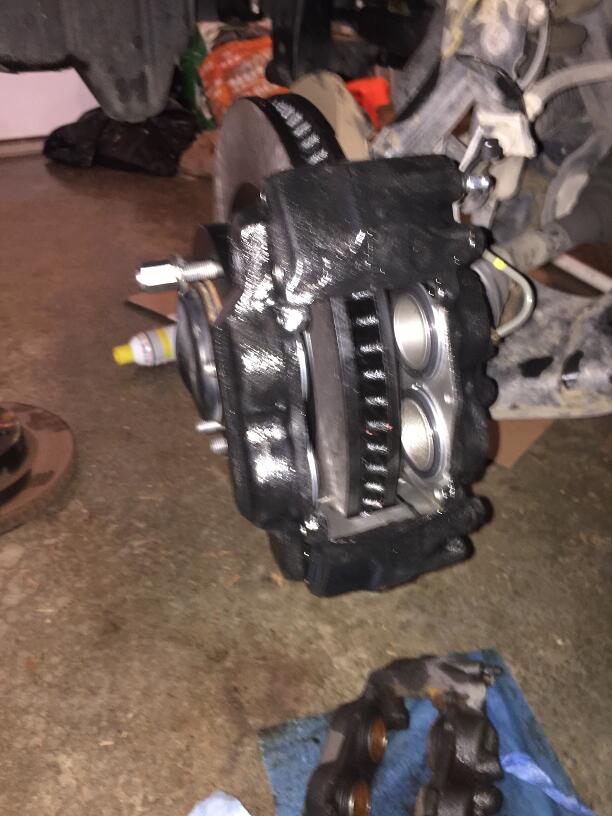

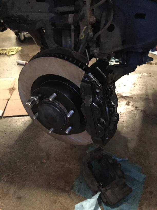

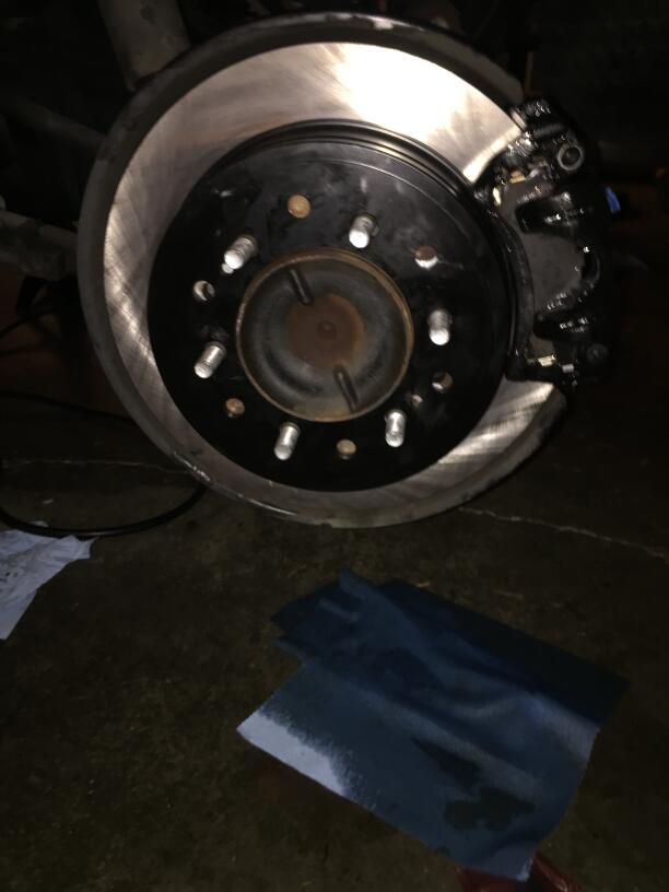

Well this is finally done! Couple words of wisdom:
I went with the G4 Caliper Paint system to try and apply some rust deterrence before install. Easy system and there's a LOT more paint there. I got 3 light coats on all 4 of the new calipers and there was several ounces of product remaining.
Make damn damn damn sure the parking brakes are FULLY released before attempting to remove the rear rotors. My right rear was not and I bent the shoe retaining spring pin (picture below) and make for one hell of a troubleshooting episode.
My old rotors popped off with ease but I was prepared with several different devices to get them off. Surprised with how easy they came off.
I went with the Centric products already listed in this thread. 5th Gen Calipers and Rotors all the way around. Found a deal on Hawk LTS pads on Amazon and pulled the trigger.
The braking action is superior. Now. . if that's because of the bigger calipers/rotors or aftermarket pads? Who knows. But I am confident I will enjoy stopping my 6500lb boat much more than previous years.
Should have been an easy 4 hour job. Turned into a few days with that damn parking brake. What a retarded design. I nearly just removed the whole thing. Finally got it working with the new hardware.

Well the clicking returned from the rears. . but only in reverse. I am taking it in to my local shop tomorrow to help diagnose. I STILL think it's coming from the parking brake assembly. . . but sure hope there isn't something wrong with the hub flange.
when the weather gets warmer here I think Ill do proper video on how to do it.
it took me 3-4 weekends to figure it out. I left my car on jacks for 4 weekends. when i finally got it right. where it held, on both sides, I was putting back together and my lug nut snaped for the 2nd time. I wanted smash the brakes to pieces. I had to engage the parking brake when at 5mph a few times. It clicked and everything snapped into place and no more touching noise. (I assumed it seated itself correctly)
Once I got it right it, it held in drive reverse on flat surface, and in nutrual on a steep incline.
I gave up on taking the car apart again. I found out it was the lug nut that was causing the stud to brake. anyway, i had mechanic upgrade to 5th gen calipers and redo all the studs. I bought a new parking brake (Cheapo one)
anyway when he did, it does not hold in reverse at all. So i know the trailing shoe is not releasing properly. granted it could crappy rebestos brakes.
in any case in the spring when i go in there and reset the parking brake I think I should do a proper video.
also do yourself a favor and get new hardware kit. the one I got from autozone was good enough for me. You can test it to make sure both sides engage (use it to replace the springs only!, keep the rest of it OE)

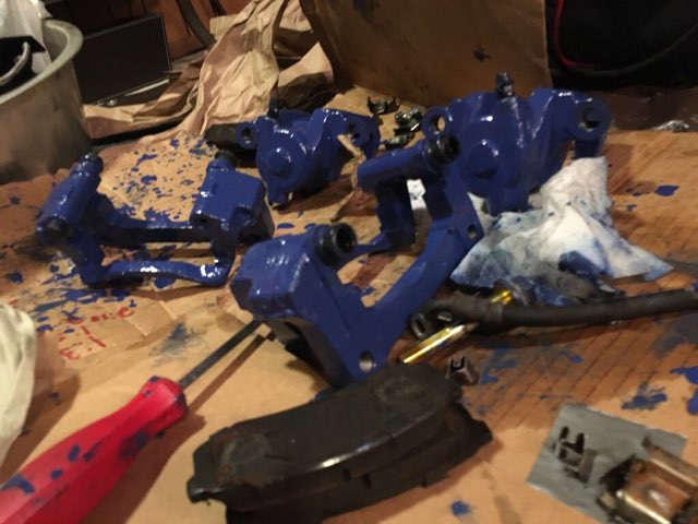

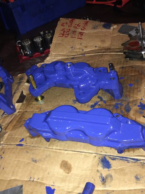

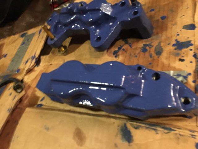

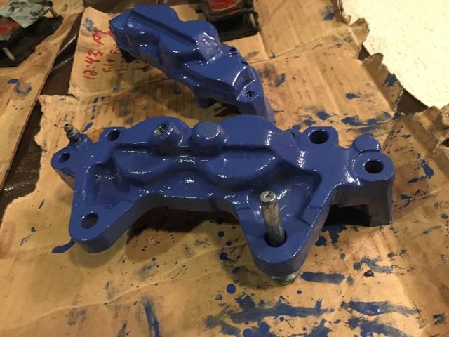

I just finished painting my calipers using the G2 paint system.
I also ordered stainless steel speed bleeders for when i reinstall the brakes.
I tried the regular ones that are made of brass, but i broke them all off... They were hard to screw in, and I couldn't tell when they were seated. I hope the stainless ones perform better. I'll also be very careful not to over tighten them.
Photos of paint job are here. ImageUploadedByTapatalk1456130797.667296.jpgImageUploadedByTapatalk1456130844.702827.jpgImageUploadedByTapatalk1456130900.724325.jpg
Now i have to let em dry and wait for my speed bleeders to arrive.

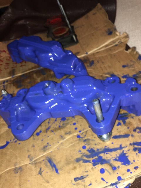

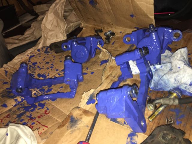

More photos of the g2 paint job. In the previous photos, my camera's flash made the color appear lighter than it really is.
ImageUploadedByTapatalk1456131688.159439.jpgImageUploadedByTapatalk1456131711.809645.jpgImageUploadedByTapatalk1456131738.211263.jpg
After i removed all of the calipers from the truck, i spent about 1 hrs disassembling and cleaning them, and about 3 hours painting them. Everything got 2 coats all around on all sides. I had just enough paint left to pit a third coat on just the portions that will be most visible once everything is installed.
It's been time consuming, but the calipers rusted within 6 months or less, and i hated the look, especially because my wheels have large open areas, so the rusty calipers really stood out and were a real eyesore.

Hey I would not paint the area in which the caliper mounting brackets meet the pad (on the rear calipers). there is only a few mm of room where they are supposed to slide along. if you add too much paint you risk causing them not to release when letting go of the the brakes....
if it went in easy without forcing the pads in there you might be okay. but my 4th gen calipers seized because there were a few mm of rust, preventing the pads from sliding correctly. Other wise nice paint job.

you bent the parking retaining pin. there is a star adjuster you need to dial back to get the rear rotor off. if you don't you will bend the retaining pin and it will start to make that scrapping noise. or you
chances are your shoes are fine, mine were and the local shop was wacking away at it. Just need a new hard ware kit to properly mount them.
