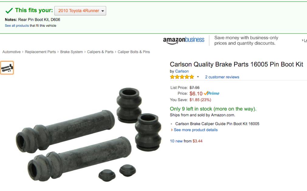

Anyone else notice that this pin seems to be missing a seal/cap? On my 4th gen caliper, both pins were sealed at the back. I'm wondering if this is going to cause this pin to seize once dirt and water inevitably get in there.
mine were missing, but it was left in the box. so i just pushed it in. Definitely don't go without it. if you dont have it call centric see if they can ship it to you, or tell rock auto its incomplete.

call up rock auto maybe centric first and tell them. maybe they can get it to you asap
Just look up a guide pin boot kit. They are only a few bucks and will come with that plug.
What he said. I picked one up locally-should be $10-$12 and will have what you need.
Thanks all. I found them at amazon for $6.10.
$6.47 delivered (with tax) via Amazon prime.
I ordered them today (Saturday) and they'll be here Monday. You can't beat that!
