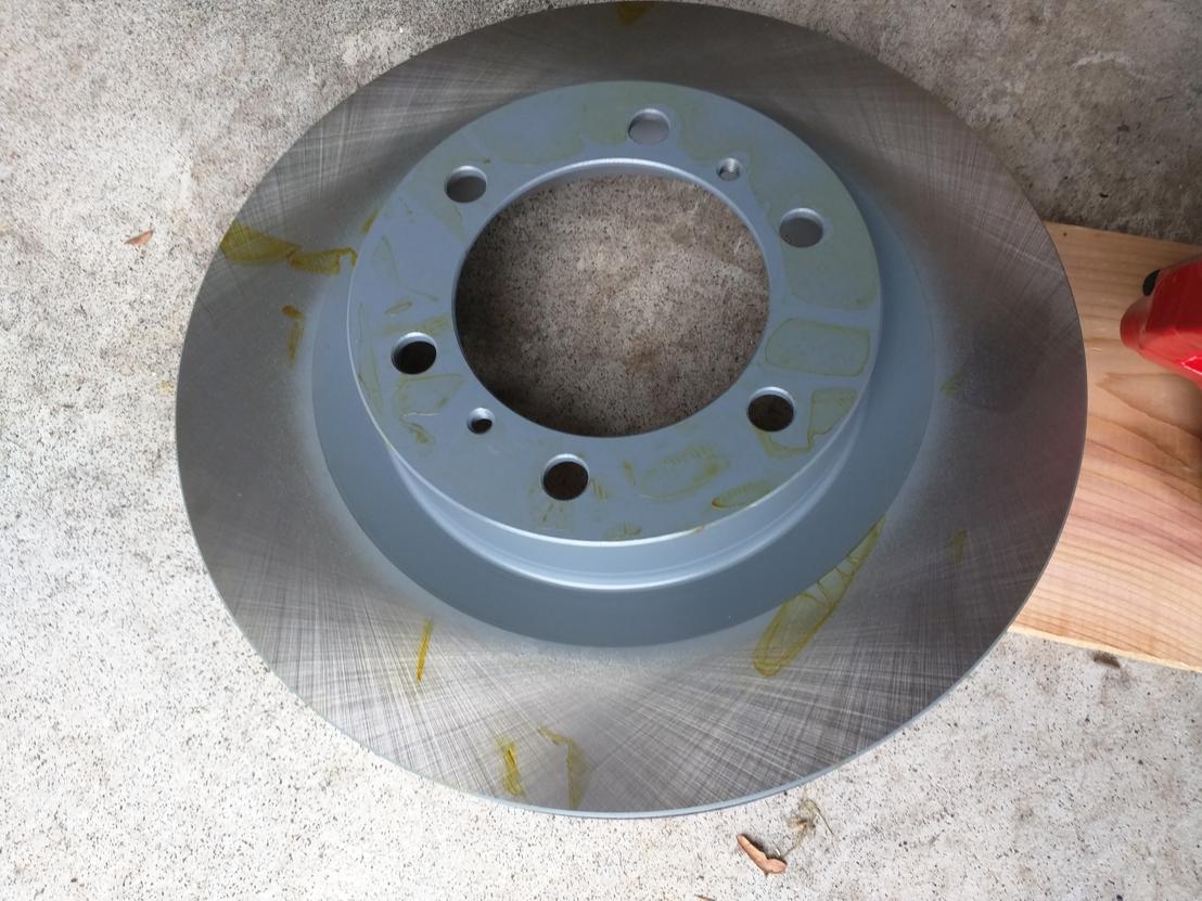

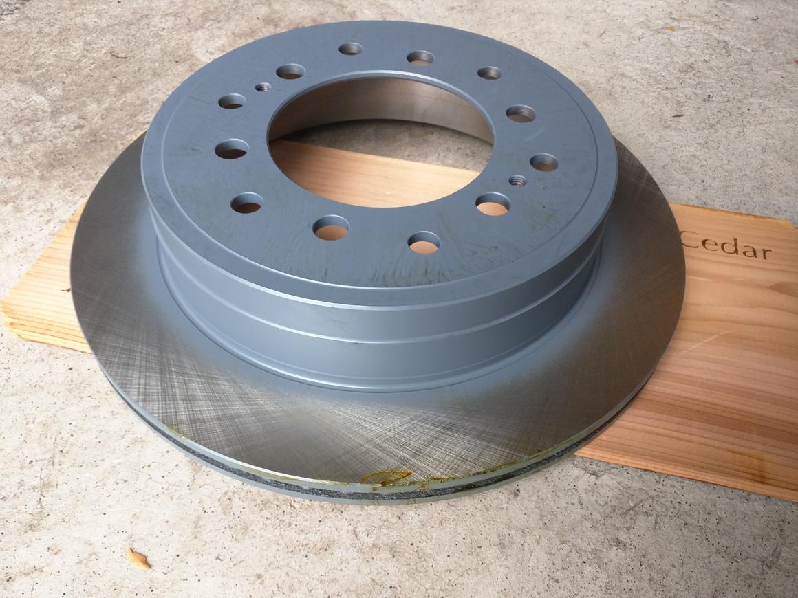

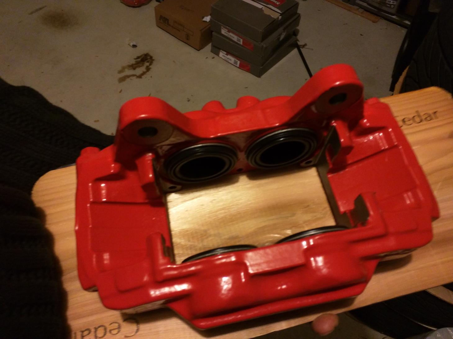

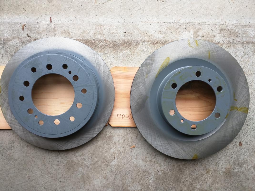

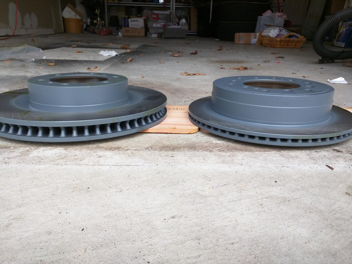

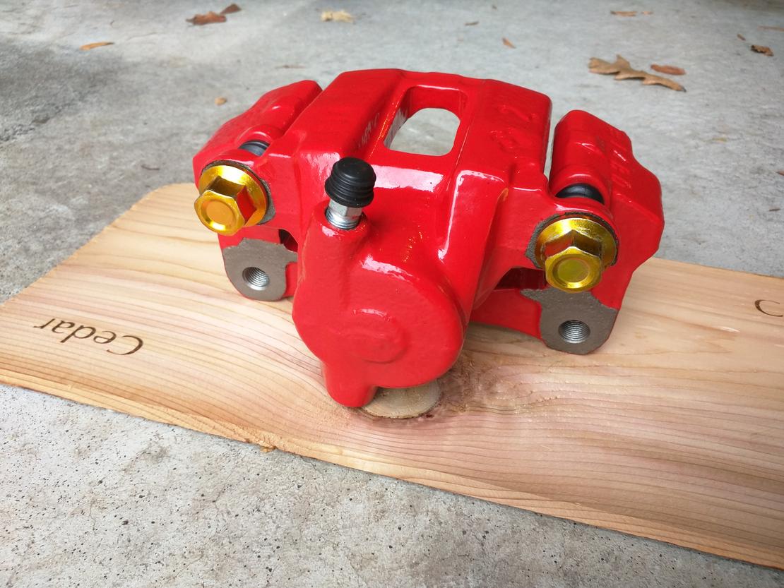

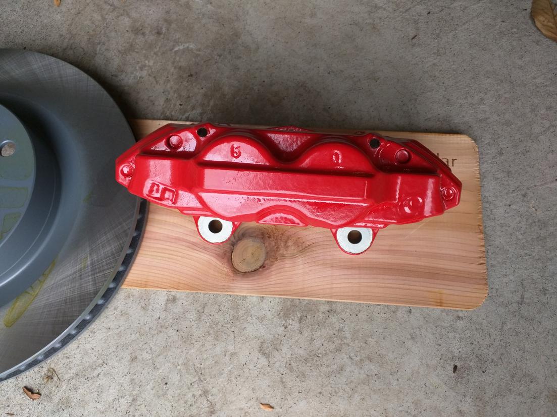

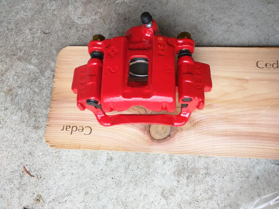

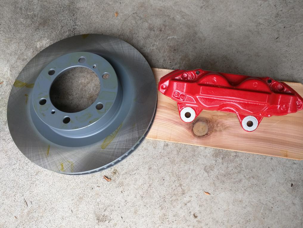

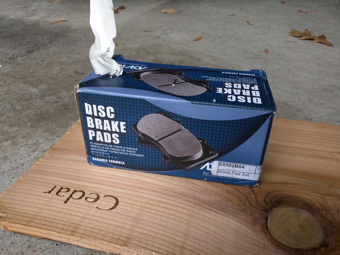

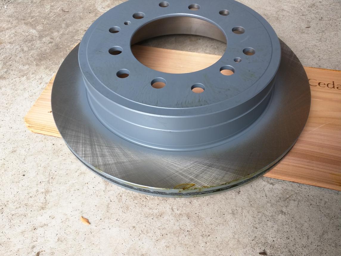

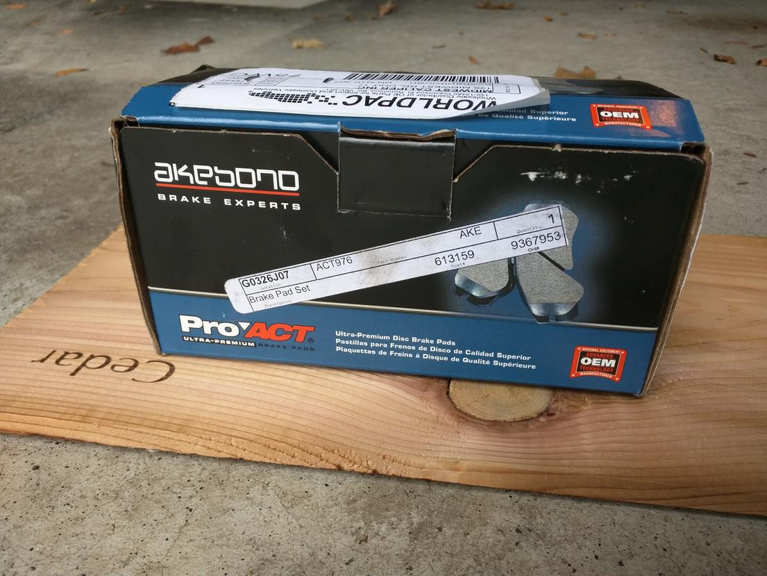

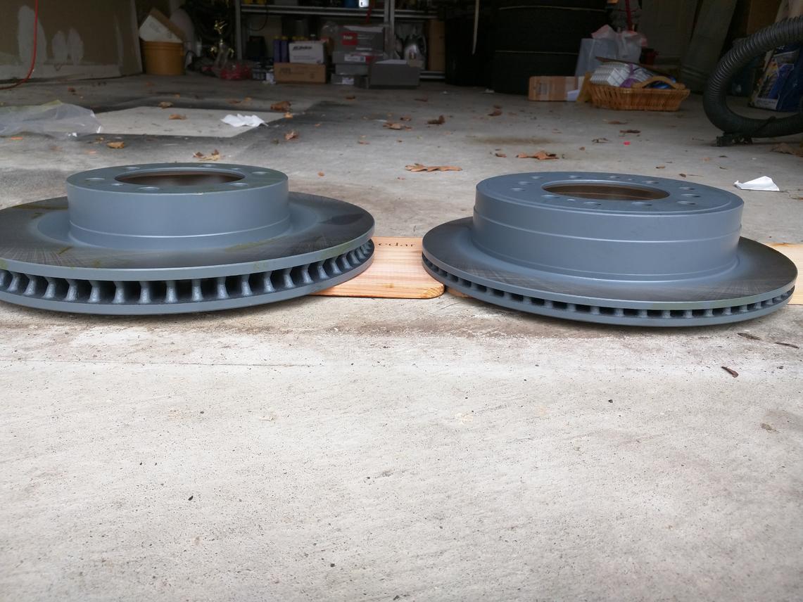

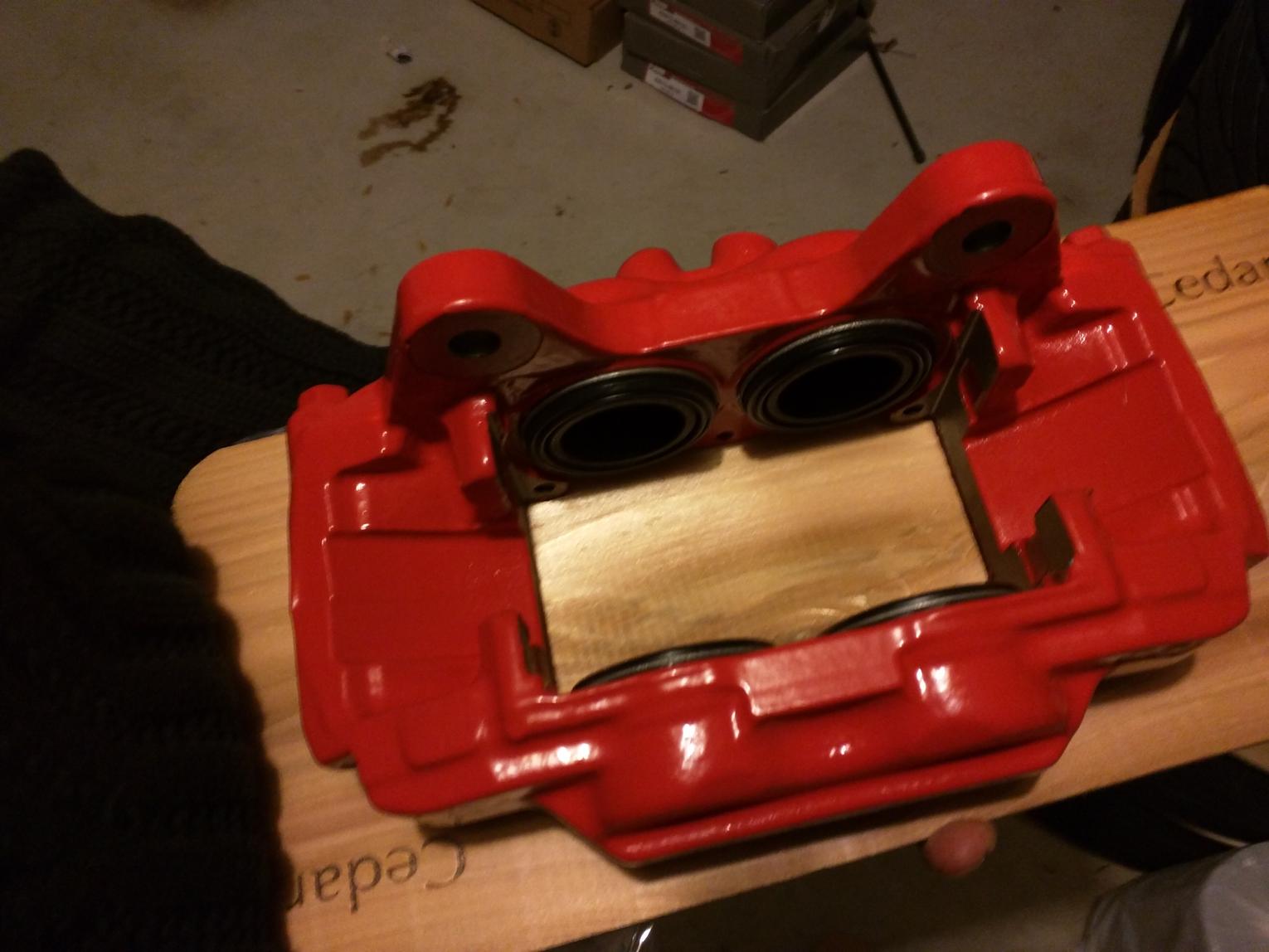

I ended up getting rebuilt calipers - 5th gen 4Runner front and back and then new rotors (5th gen 4Runner spec for the fronts and 4th gen 4Runner spec for the rears), Stoptech stainless steel braided lines from Rockauto and Motul synthetic Dot 4 fluid from Amazon.
The calipers and rotors and pads I got from a local shop that specializes in rebuilt calipers - Midwest Calipers and got them powder coated in red and then clear coated. They turned out great.
See parts below:
