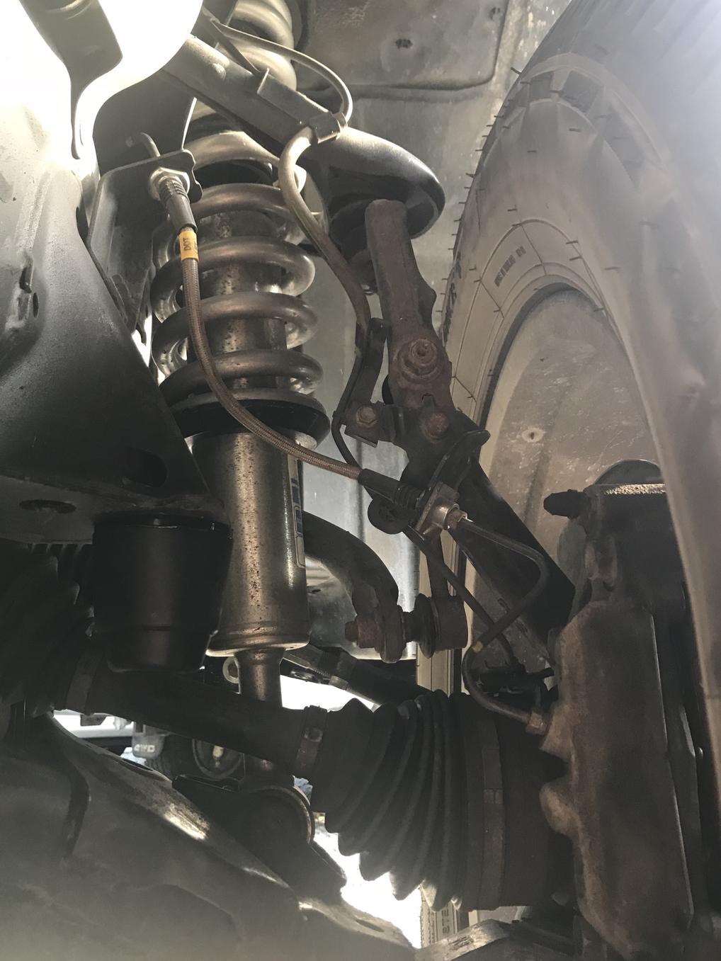

These appear totally symmetrical, base and rubber. I am pretty sure they bolt on in no specific orientation.
Tacoma Gen1's have a notch you are talking about.
No notch on 5th gens, got mine yesterday and put them in after crackin a beer!

All of the 4th and 5th gen 4runner bump stops are symmetrical. They bolt on in no specific orientation.
It is only the 3rd gen 4runner/1st gen Tacoma that has a notch in the casting. These bumps are a completely different beast in comparison. diffrent suspension geometry and diffrent mounting location. they also have an angle built into them that is needed to make even contact on the frame. The notch just helps with easier installation and perfect alignment.

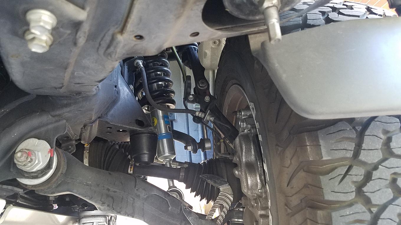

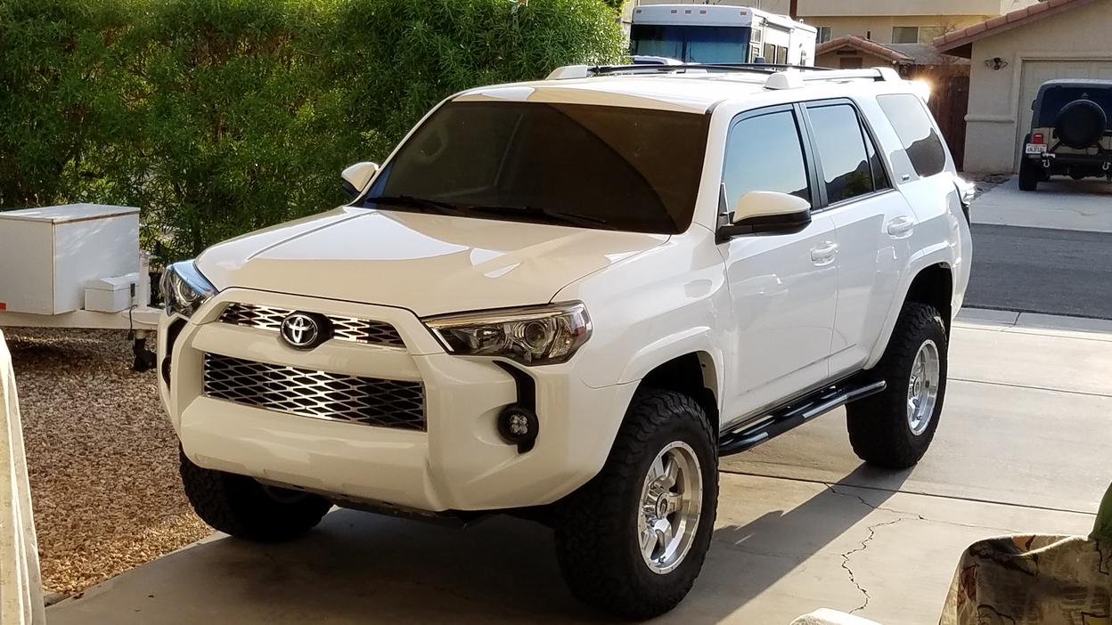

http://www.toyota-4runner.org/attac...nt.php?attachmentid=309692&stc=1&d=1535308436 Great quality with top notch hardware and a shot of Lock-Tite included! 1/4 turn with the Godzilla Water-pumps and the old one's were loose. Get some droop on the arm and put the bolt into the new bumper. Only tricky part was to bring a deep 14mm and use it alone to thread the bolt all the way in and THEN slip the ratchet on to tighten as the clearance on the A-arm is tight for the wrench. 15 minutes, start to finish! Thank You Plastics Guy!:hungry:

I wish my undercarriage was as clean as yours. Unfortunately they salt everything here. 2 Utah winters in and I've got rust spots everywhere. I'll have put some sort of protective film/spray/treatment this year.
On the plus side I did get and installed my [MENTION=146407]Plastics guy[/MENTION] bumpstops. They look so much better than the OE ones and much better buy than the overpriced Timbrens. These should fit the bill perfectly and I look forward to a rear set :D
I suffer from the OCD with vehicles.......they CANNOT sit overnight if they get muddy! I wash once a week and that includes scouring the underside and no oil or grease can be on it anywhere! My Motorcycles are on another level and look new the day after a ride.......it's a disease that I caught at age 10.:sick:

Nice rig, i used the same pliers to remove my old ones haha
