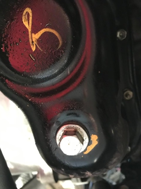

Have oil leaking here. Any idea of the source?

I have a 2011 ... was told after last oil change that I have an oil leak "seep" in the front of the engine. Going in Monday for diagnosis. Can't help thinking it could be a $2500 repair which I can't afford.
2nd Gen - 2005-2015 1GR-FE Tacoma's are known to leak at the timing cover. While the 5th Gen 4R and 2nd Gen Tacoma both use the 1GR-FE engine, they are not the same in all respects. I know that things north of the block are different, but believe the blocks are the same.

I just took it to an independent repair shop - he confirmed it's the timing cover. Estimate - $2000. Oh yay! Now I just have to decide if/when to do this. He said it's one of the worst leaks he's seen. Also, need to decide whether to cancel diagnostic appointment at the dealer - cost will be $130 and I already know what the problem is.
