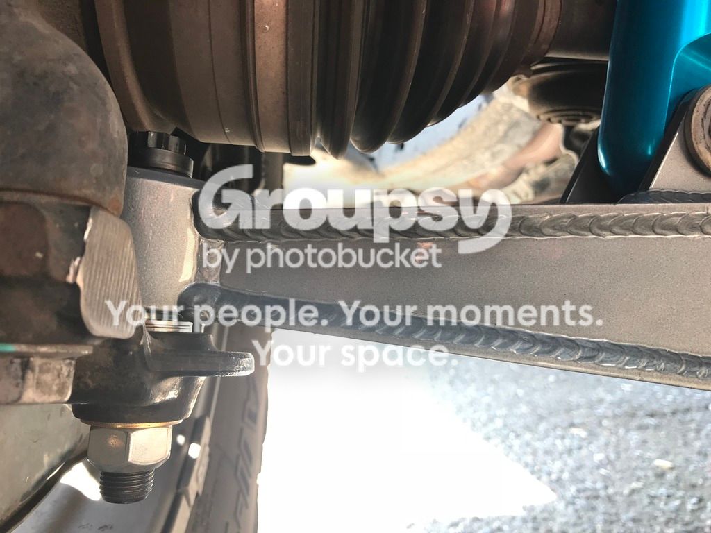

We just installed the stock length racing lowers on my 2016 TRD pro and have some rubbing at full lock right behind the uniball on the bottom. How much is normal?
Thanks
Josh

Stock length Racing require a 1.25" spacer. Do you have a 1.25" spacer?

[MENTION=99702]jrandom[/MENTION] Sorry about that. Total Chaos is closed on Fridays thought I would post here to maybe get a response. From what I understand the regular stock arms don't need spacers. Wheel doesn't hit, the knuckle under the uniball hits on the lower part of the arm even after cutting off what was recommended. you can see a small dent right after the uniball joint on the arm. The instructions do say some rubbing might happen just wondering what's normal and acceptable.

You first posted you had Stock Length Racing LCA's. They look like it in your photo too. If they are indeed stock length racing you do need a spacer according to TC. Can you confirm which you have?
[MENTION=99702]jrandom[/MENTION] I do have stock length racing LCA (non Kdss). Post number 4 by Total Chaos says single shock you do not need spacer. I have no tire or wheel rubbing just the metal “knuckle” that bolts to the bottom of the uniball contacting the control arm at full lock. I would assume this is the same on all the racing lowers with the uniball.

Ah okay, so it is only the dual tab, for whatever reason I thought I saw that non-kdss stock length race required a spacer. Sorry for my confusion!
