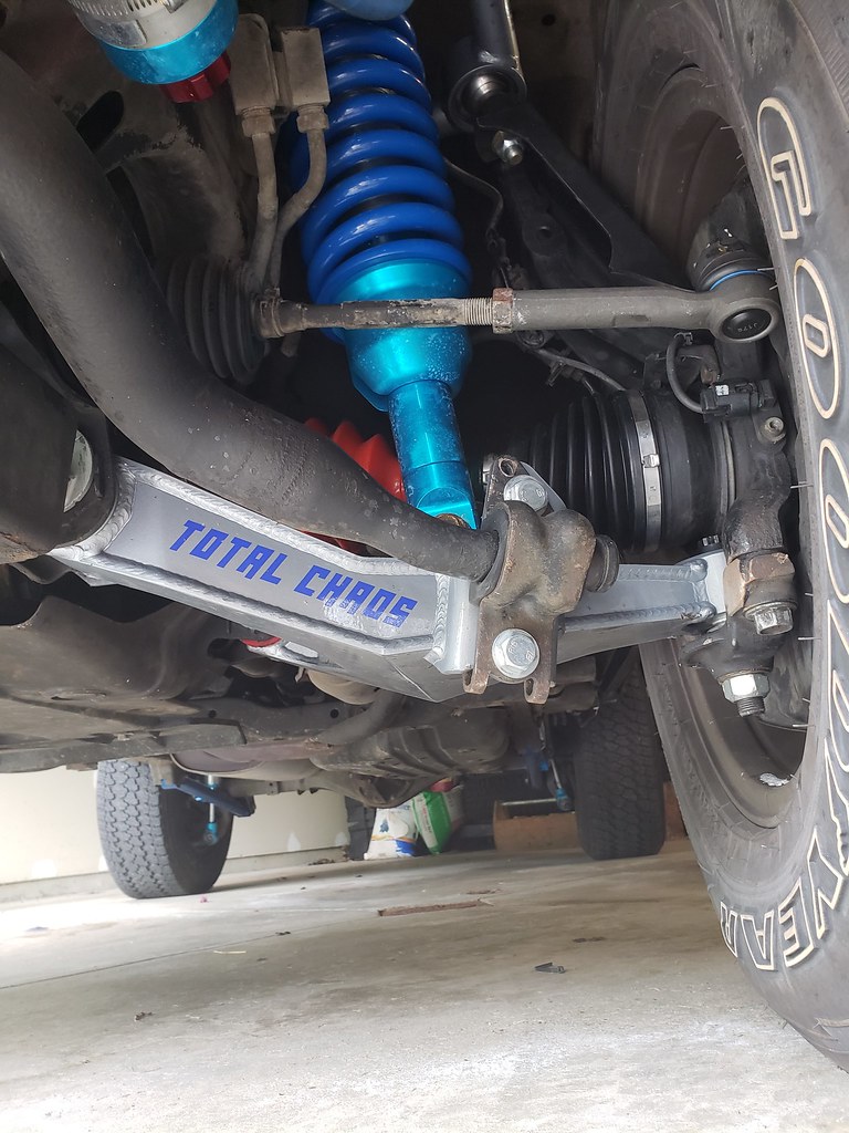

Thanks for posting up. That is a normal amount. Per our Installation Instructions, there may be some contact at full lock :)

Grinding off the steering stop won't potentially cause issues to the rack? I know the titan lift kits some companies sold had too big of steering stops which caused the rack to press against it and potentially blow the rack apart. Then again, i blew out 6 of those racks on no lift kit:wacko:
You will not have issues when trimming the steering stops and running TOTAL CHAOS LCA's. At full lock there is slight contact of the ball joint cradle and the arm. This prevents the rack from overextending. If you trimmed the steering stops with stock LCA's, there will certainly be problems.

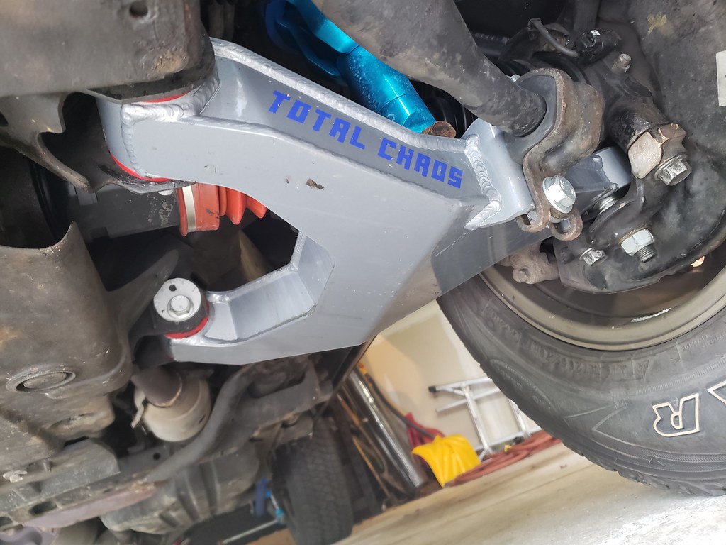

A few benefits that I know of over OEM are that you can service the poly bushings and the LBJ without having to replace the whole arm which is what the dealer will do with any excessive bushing wear, or lower ball joint failure. That and they'll play friendlier with the angles when lifted over stock, allowing more free movement and higher clearance at the LCA bottom. I like the fact that if you have a LBJ issue with these on the trail, you can easily have parts for a replacement versus needing to carry an entire OEM LCA because you cannot service the stock LBJ.

Speaking of stock width! We are still working on getting photos of these arms INSTALLED on a KDSS equipped 4Runner. Mostly close ups of all of the components. We released these not too long ago and don't have customer shots yet. Thank you for your patience!
