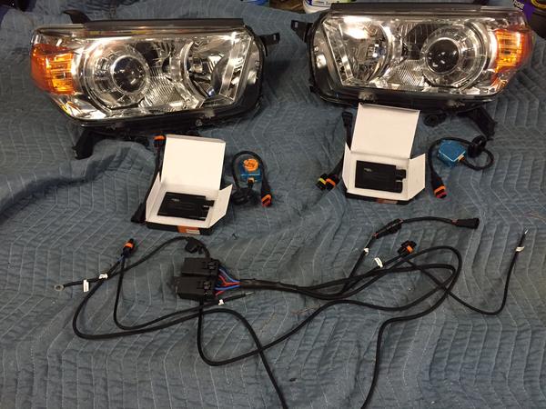

Big thanks to TRS (The Retrofit Source) for supplying the parts listed below:
2 LS460 Bi-Xenon Projectors with STi-R lenses
2 Morimoto XB35 Ballasts
2 Morimoto XB Igniters
2 D2S: Phillips 85122 Bulbs
HD relay Harness

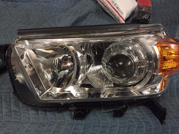

Decided to go with new OEM headlights from Camelback Toyota, and had them sent directly to Caesar. Used these part numbers for stock 13 limited lights.
Left: 81170-35520
Right: 81130-35520

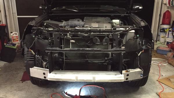

Big thanks to philsey for his write up! On to the pictures which were taken by my iPhone. Please disregard the messy garage.

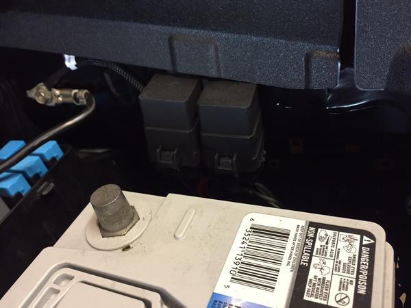

Decided this was the best place to mount the relays for the harness.

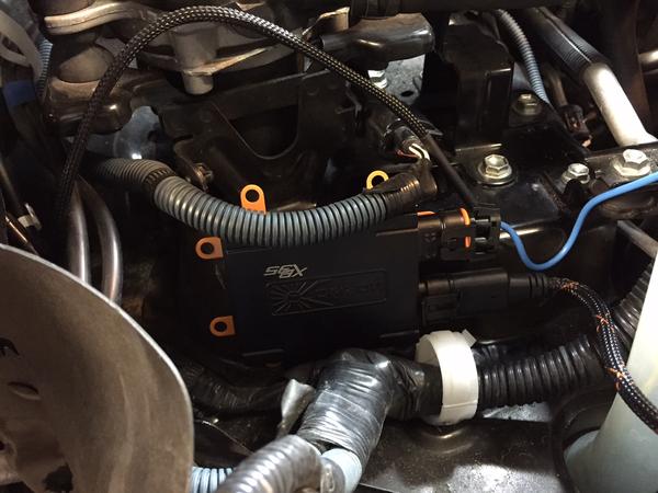

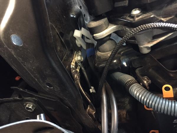

Mounting the passenger side ballast and ground wire was a bit of a pain do pump? Not sure of the technical name for it. Used double side tape to mount the ballast on the ridge and unbolted a couple of bolts to get my fingers to reach the factory ground bundle.

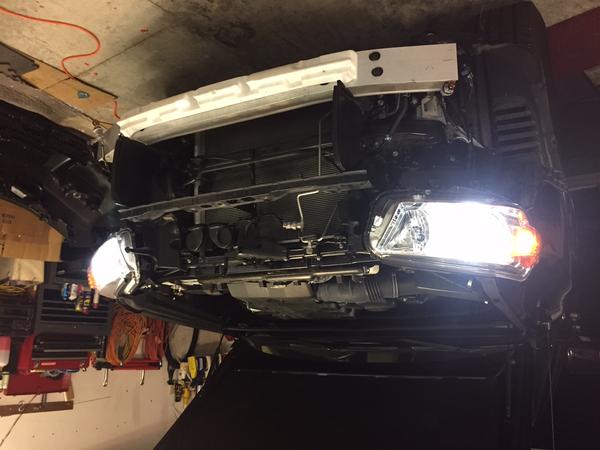

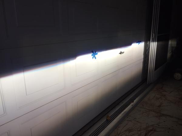

Testing before reinstalling the bumper. Somehow the image got flipped.

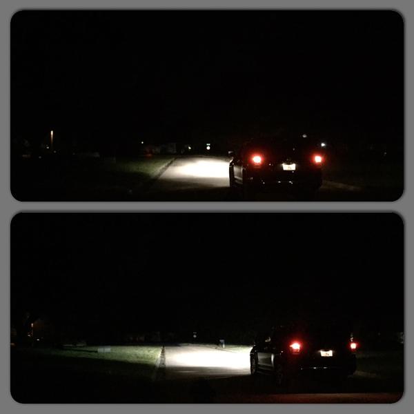

Last but not least, before and after photos!
