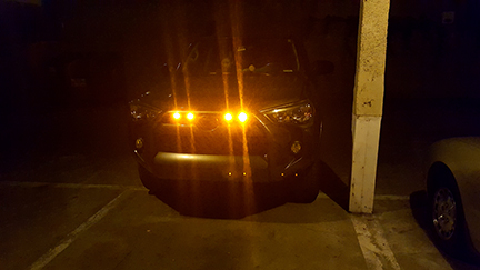

At first i told him, i wanted them ON when i turn the headlights ON. Then i went to grab a cup of coffee, then approached him. Asked him how about we add a switch to it. Thats what transpires the conversation above. It was my fault.[emoji20]

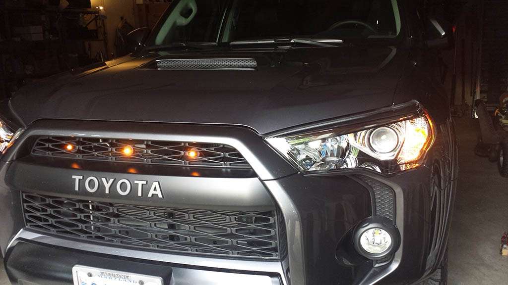

Another markers from Amazon.

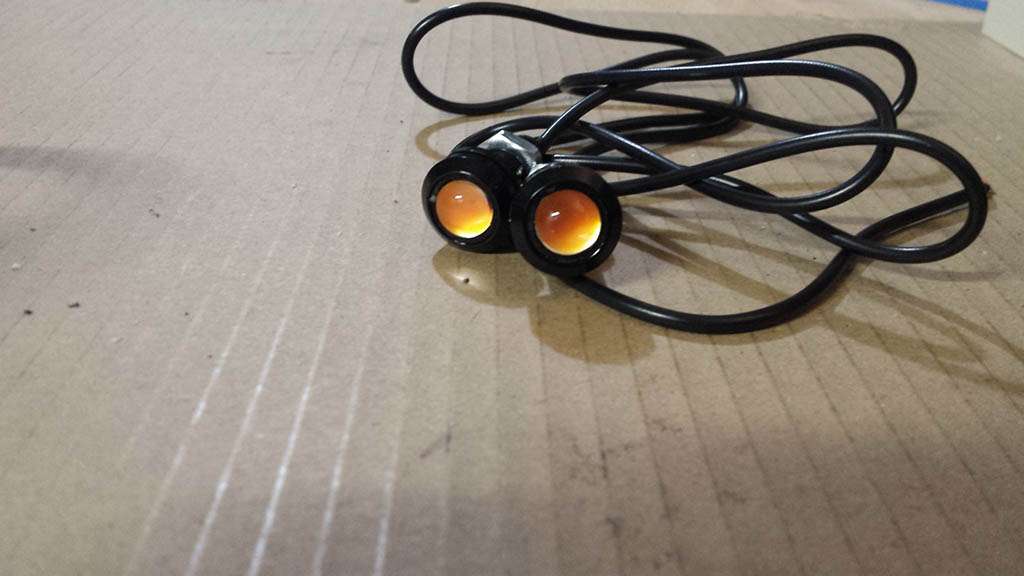

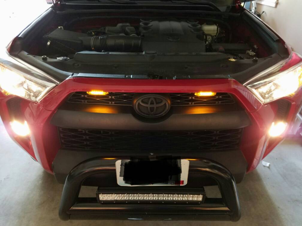

I used these cheap amber LED "eagle eye" bolts from ebay, about $3 each when purchased in bulk. They have clear lenses with an orange shine.
When turned off, they reflected the sun and looked like shiny white spots during the day. They were also ridiculously bright at night when turned on, totally outshining the factory marker lamps.
To tone it down, I spray painted several layers of matte black Plasti Dip over the lenses, using a tiny strip of blue painters tape to partially mask off the middle...
The result is somewhat of a dark "stealth" look, but plenty bright when turned on.

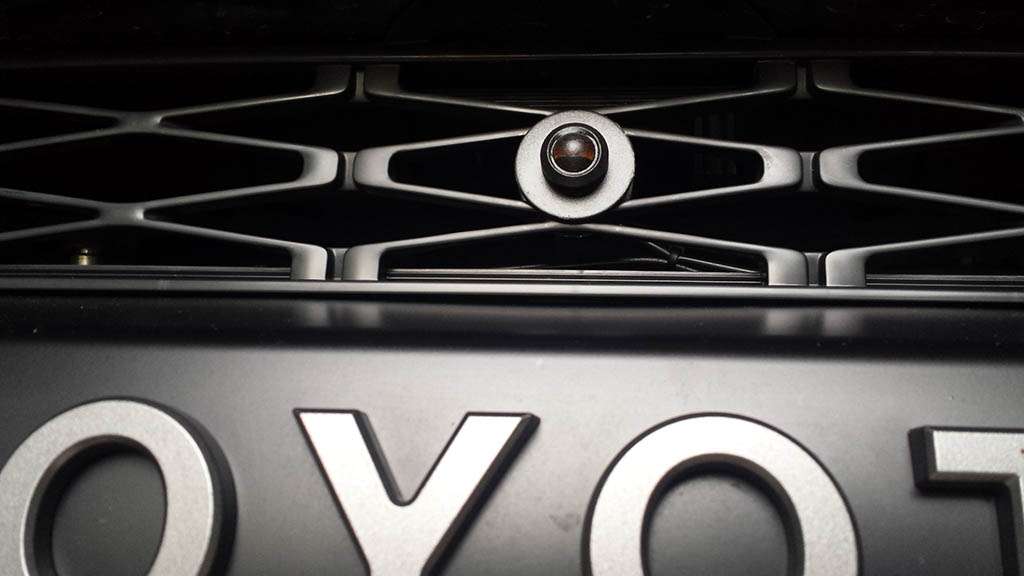

Here's the view from afar:
Turned on:

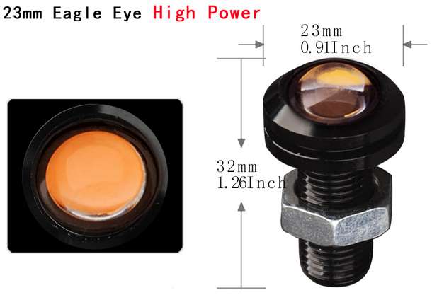

Are those bolts threaded to fasten from the rear? Could you provide a link? I looked up Eagle Eye on ebay but it is difficult to tell how they fasten.
secretskwirrel
Here's a link to some on ebay. Looks like they're getting cheaper... less than $2 each...
10x 3K Amber Yellow 23mm 12V Motor Car 9W LED Eagle Eye Fog Driving DRL Lights | eBay

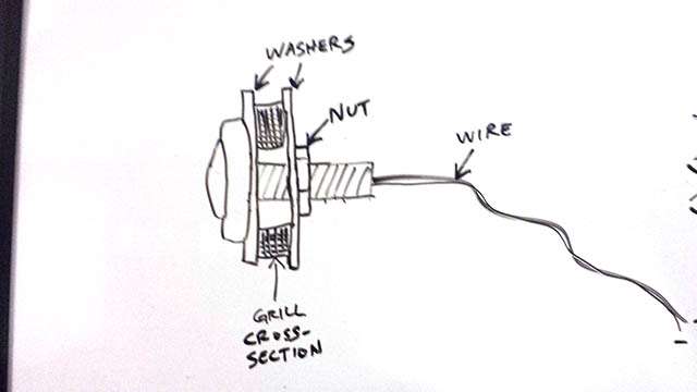

As far as mounting in the grill, for the two side LEDs, I used the head of the LED bolt against the front of the grill and a stainless steel washer (Plasti Dipped flat black) against the back of the grill, secured with a hex nut.
For the center LED, the head of the LED bolt didn't have anything to contact, so I added a black washer in front of the grill as well as the back. Here's a quick whiteboard diagram:
I also used same size black polyurethane washers where the stainless steel washers meet the grill in order to help absorb vibration and give the bolts and washers some extra grip. You can get them from the special hardware drawers at the hardware store or at a hobby shop.

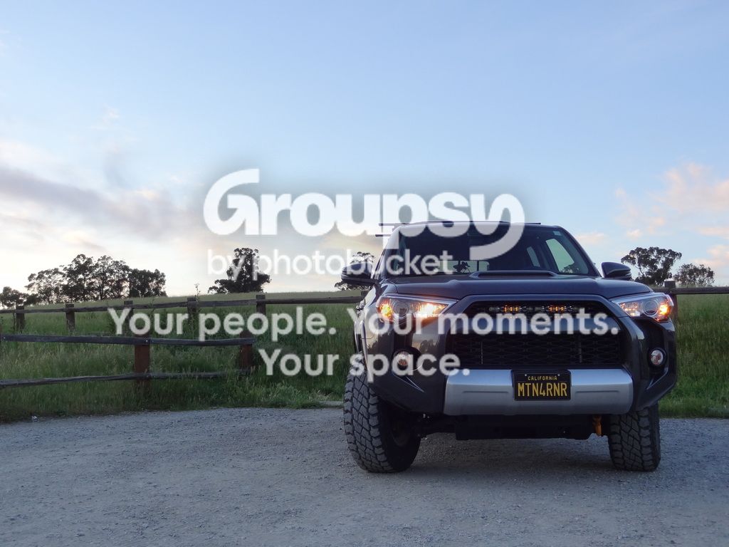

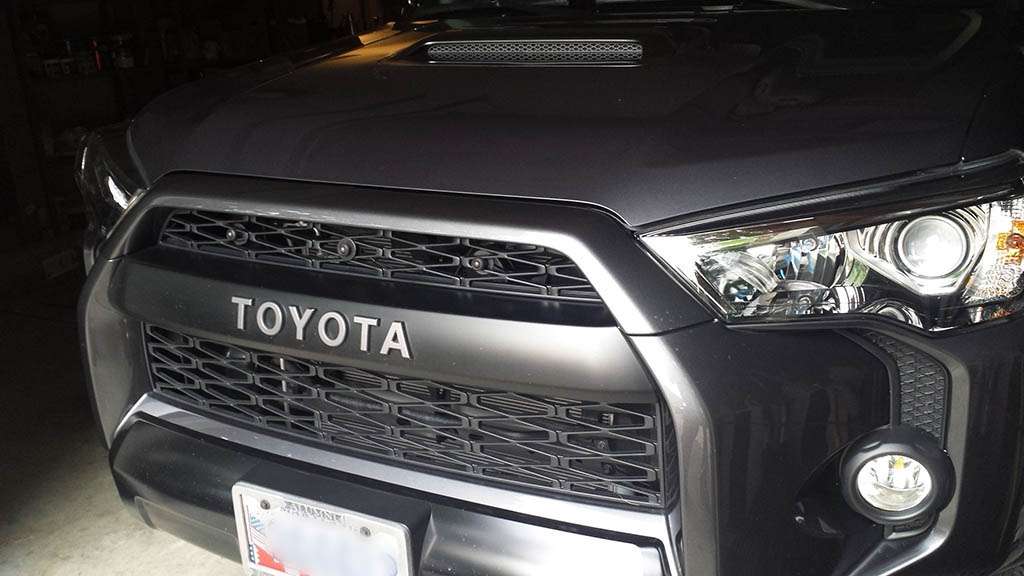

A bit late to the game as many know I installed this a while back, but my version of the marker light mod is by using a [MENTION=87816]Baja Designs[/MENTION] S8 light bar with built in amber backlighting. Same effect as the amber lights shown here on this thread, but with the added benefit of having a light bar behind the grille.

can you please post a picture much closer of the grille and lights? did you use the factor upper garnish or is that the TRD Pro garnish?
