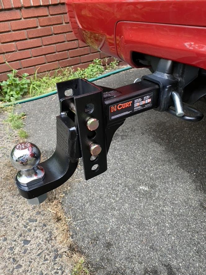

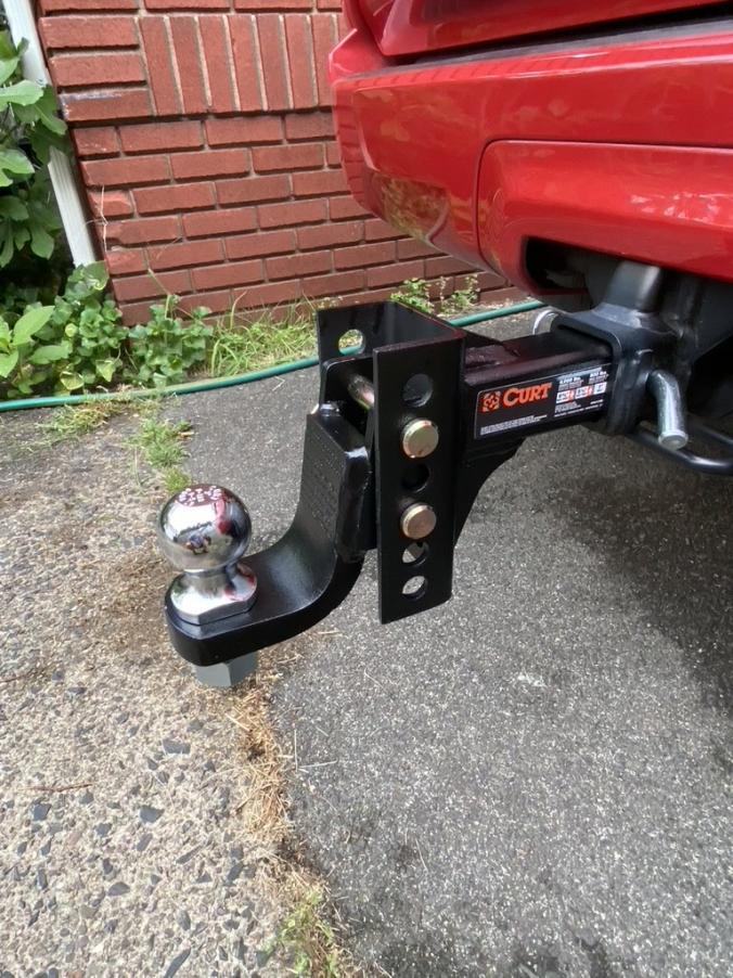

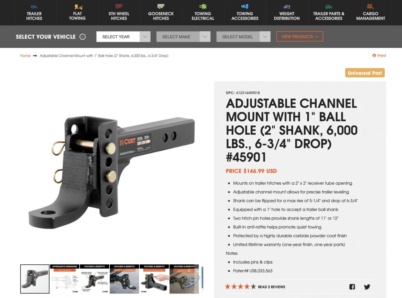

From my 4R towing experience I have found that I always needed more drop than I initially thought. I couldn't even hook up my 6x12 enclosed trailer with a 2" drop hitch initially because the jack wouldn't go high enough. I'd imagine somewhere near 4" drop would work. Or go with an adjustable like you've posted.
Also, get airbags. These things squat horribly.
