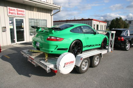

Try to find a used Trailex. There's some around, but they go fast. They're not cheap, but they hold their value and they look great. Also fit in the garage. Most Trailex car haulers are under 1,000 lbs, so with your bimmer on board you'll be under the SAE tow limit of 4,700 lbs. The 4R won't object to that, especially if it knows it's going to the track.

I would LOVE a Trailex, but they're just so damn spendy. A used one would be great, but I haven't seen any around.
