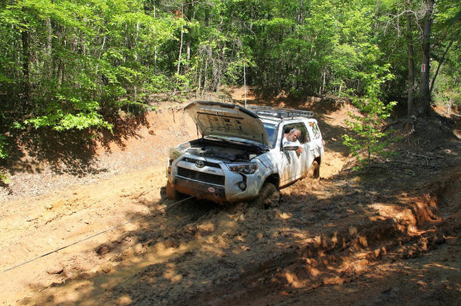

I haven't had any issues the 5 or 6 times I've used my 9500 lb winch. But I've really only put a hard load on it once (FedEx Mercedes Sprinter van in a ditch). The rest of the times have just been pulling forward 10 feet or so out of mud.

Basic winching: You shouldn't run the winch in idle since it pulls direct from the battery.
You should be in Neutral (NEVER PARK when winching, never ever). Lay on the brakes if you're pulling someone else out or drive if you're winching yourself out. And you should rev the engine to 3000+ RPM. A higher idle really isn't an issue.
