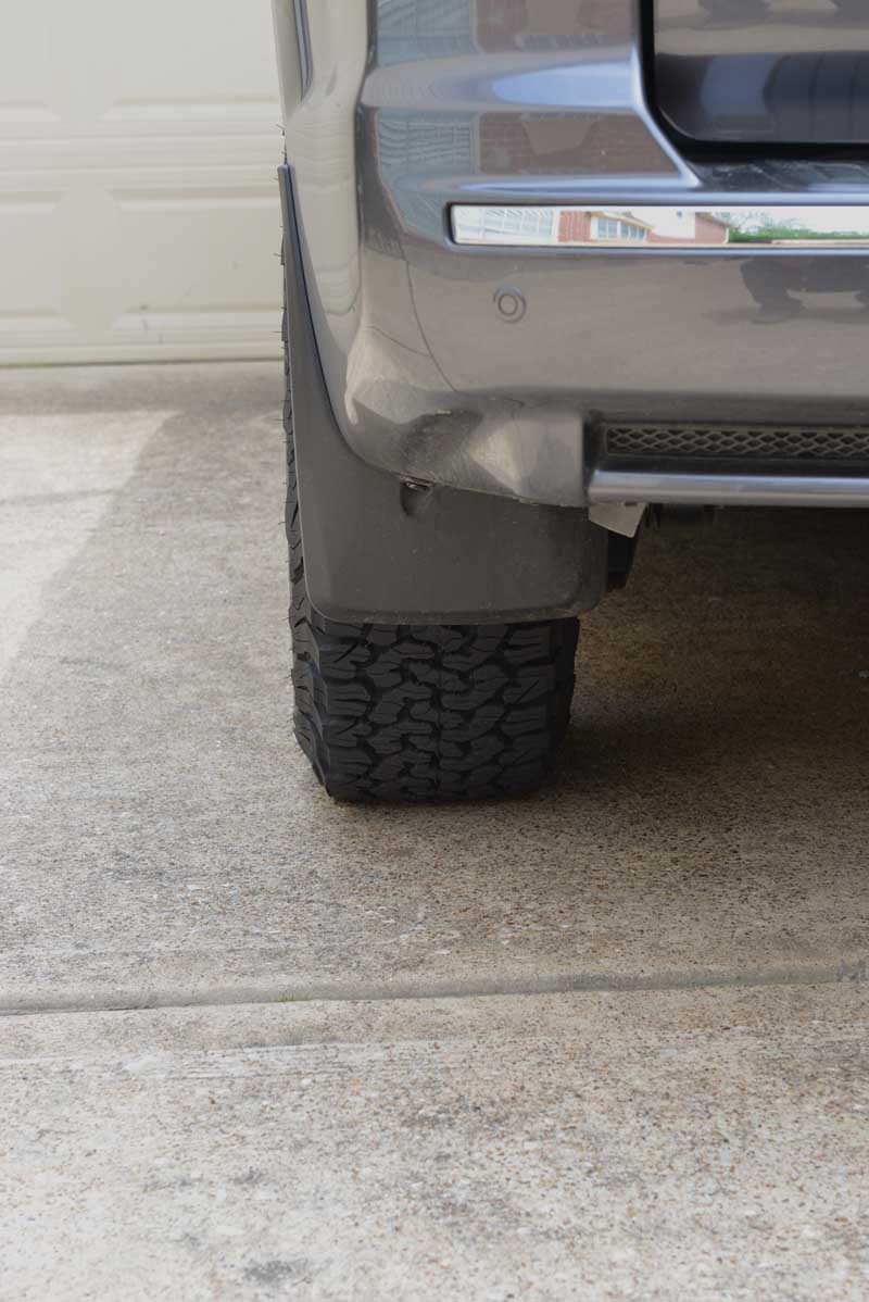

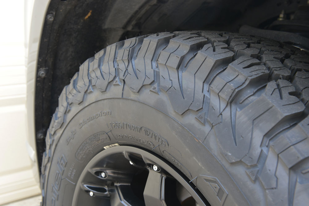

Previous posters have stated that the 265 70 R17 did not make a difference vs. the stock limited pizza cutters. In my opinion this is not true at all. My 265 KO2s completely transformed my 2015 4x4 4Runner Limited into a much meaner, cooler vehicle. Now to contemplate a lift.
Note: Even with the 265s I do get a very slight rub on the front tires when in reverse. Looks like it is rubbing on the part of the plastic wheel liner closest to the bumper and should not be hard to heat up and deform.
Tire and wheel novice so I have to ask. How can 265-70-17 tires rub when they are a stock size? Offset difference of the wheel? Larger wheel width (this should actually decrease the chance of rub, no?) I have a brand new 18 LE 4WD and I want to fit 17" in wheels and "slightly" wider and more aggressive looking tires but want ZERO rub. Please enlighten me.

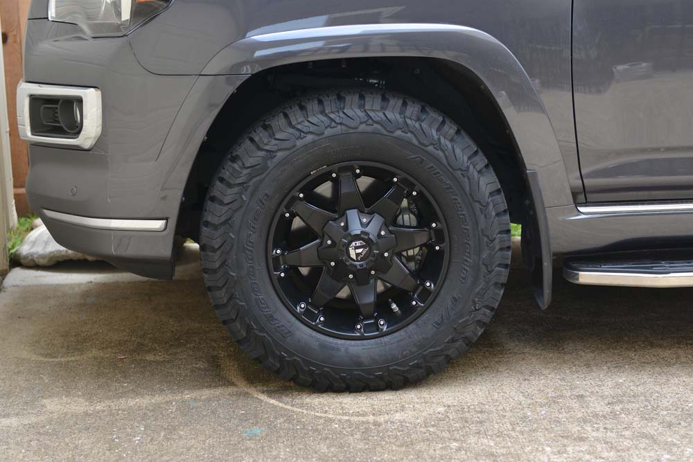

Wheel: TRD Pro 17" Matte Black 17x7 with 4mm offset
Spacers: BORA 1.25" spacers
Tires: Goodyear Wrangler Duratrac OWL C series 265 70R17
Suspension: Standard KDSS
No body mount chop, but we did relocated the fender liner and trim the front bumper and remove the front mud flaps, which I am going to modify with a heat gun. No rubbing now.
I'm assuming that the rub on these stock sized wheels and tires was caused entirely by the 1.25 spacers?
rzgkane: Without a doubt.
Im sure that is the problem since the tires are stock spec. The rubbing was so minuscule but enough for me to not want to hear it anymore so we pulled the flaps off. In the spring when we get a chance to drive terrain where the suspension will encounter more articulation I suspect I will get some rubbing again.
