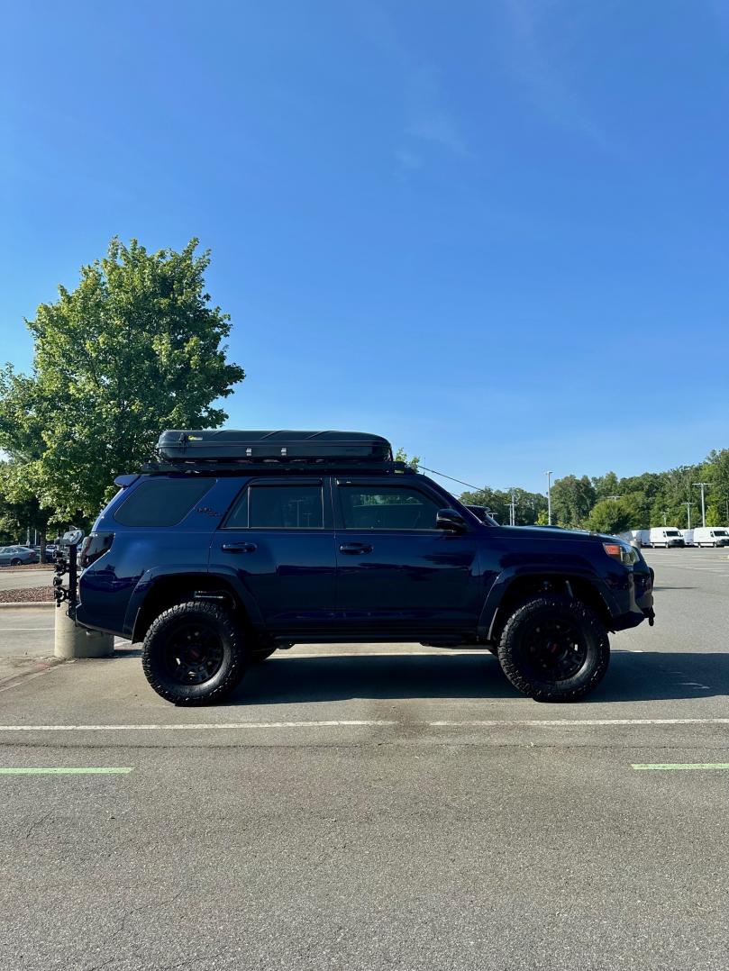

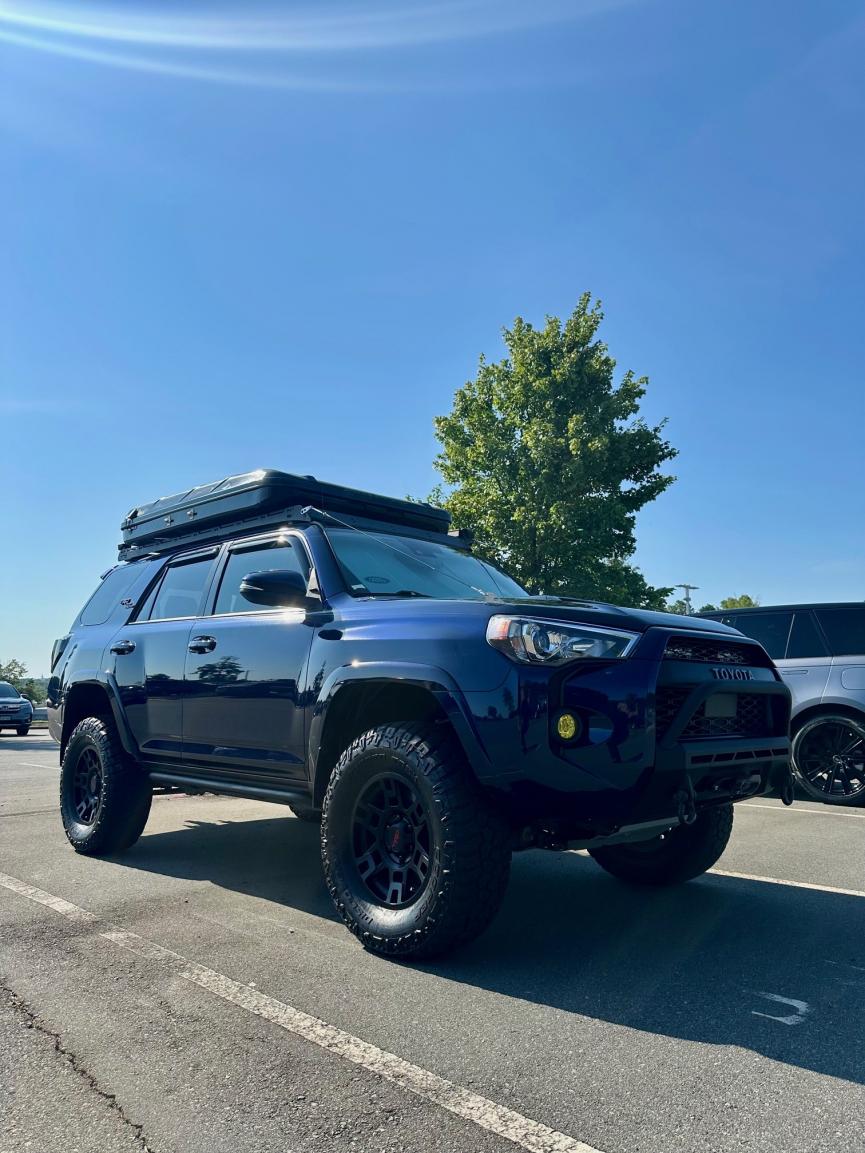

TRD wheels. 285/70/17 Cooper Rugged Trek
Kings with OME springs (3 inch lift)
SPC upper controls
No rub, just trimmed mud flaps and made them "shorties"
