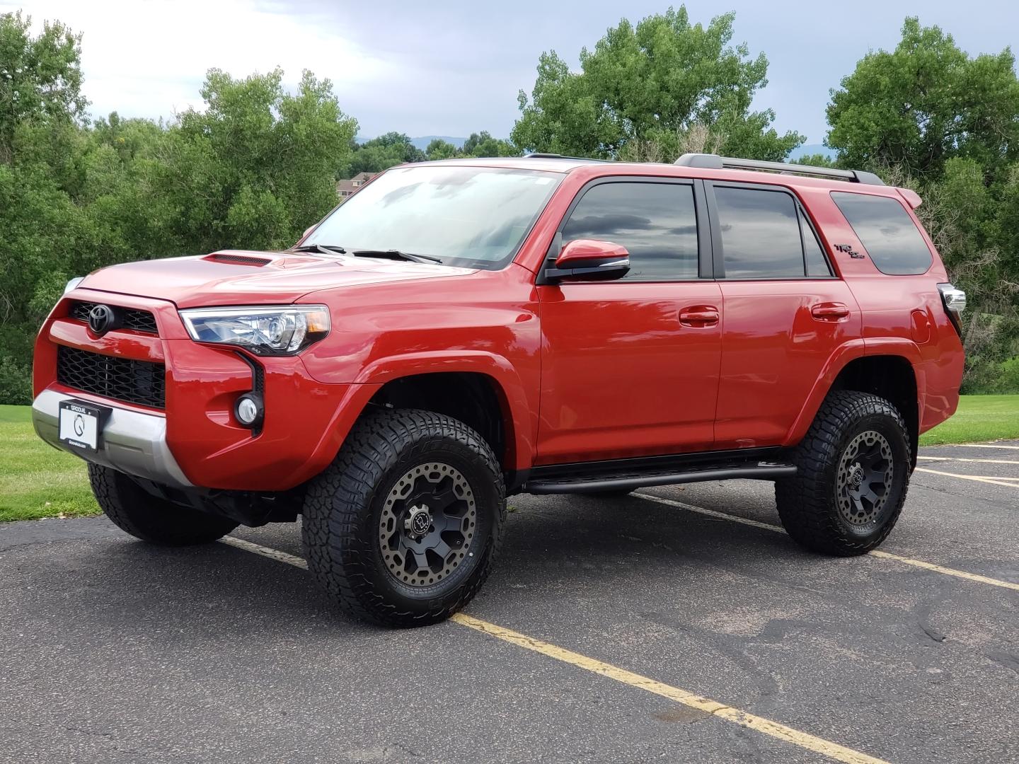

bilstein 5100s @ 1.75 front, rear no lift 265/70/17 falken wildpeaks at3w - TRD wheels
shoutout to discount tire, they were fast getting the tires in and at the last minute I was on the fence about the wildpeaks and wanted to compare them to cooper discovery tires and they mounted one and put it on the 4runner for me to see and in the end the wildpeaks price and looks won me over...so far KNOCK ON WOOD absolutely no front end shimmy or balance issues...ride seems smoother than old tires with no added road noise

With your set up do you think the Falken in 275 would fit without rubbing? I know they tend to run big but was just curious since I'm looking at Falkesn with 5100s at 1.75.

I think there is enough room with the lift that 275s will fit without rubbing with the TRD wheels

No. This is 285's on 5100's set at 1.75. no rubbing on or off road

Unless you're running spacers you could do the 285's

Looks great. I like the Victory rack. Could you give me your center of hub to top of fender arch measurements for both the front and rear. I would appreciate it. TIA

22 1/2 in front and 23 1/2 in back. Dobinsons 599 in the back for a 1 inch lift

Thanks. That’s what I have up front and 23 1/4 in the back.Looks like you still have your mud flaps which I want to retain. Any other mods to make the 285’s fit?
I did the fender liner mod before the install but it wasn't necessary. Provided more space but I'm pretty sure I wouldn't have rubbed anyways
