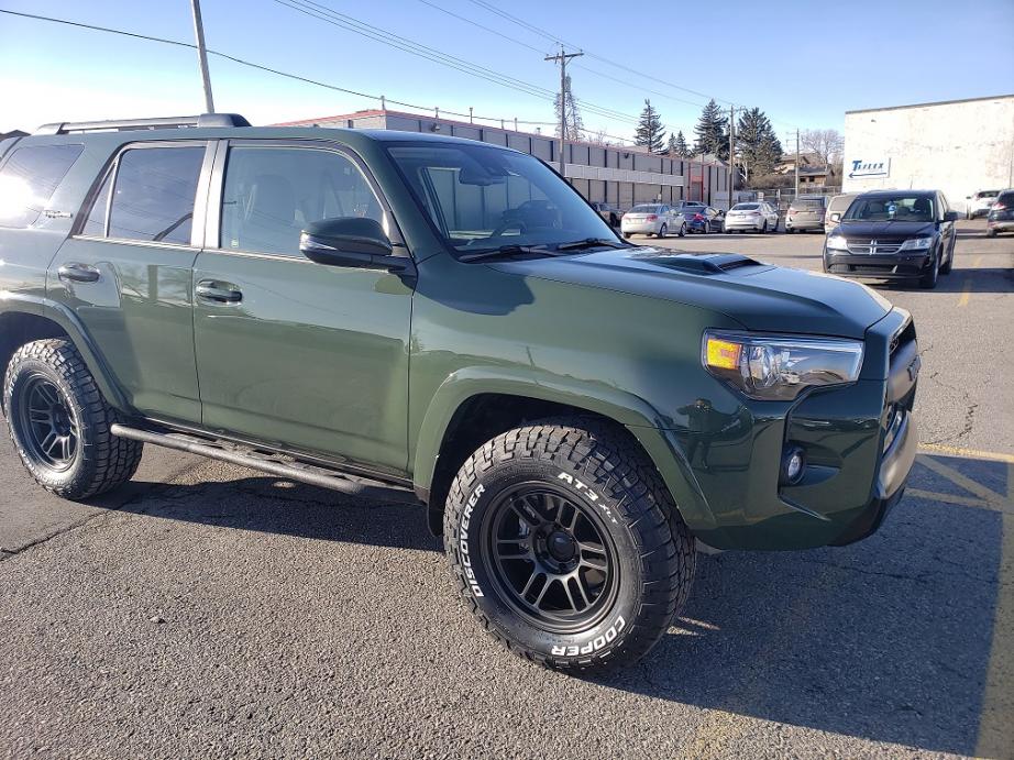

Enkei RPT1 (18x9) wrapped in Cooper Discoverer AT3 XLT. (285/65/18)

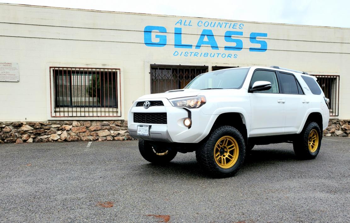

- Enkei RPT1 18x9 et0 (custom Metallic Gold)
- Toyo Grand Country A/T 285/65
- Toytec Boss 3" (set at 2.5")
- Nothing Modified / No Cuts or chops
- Tires Rub fender liner with wheel locked in reverse
