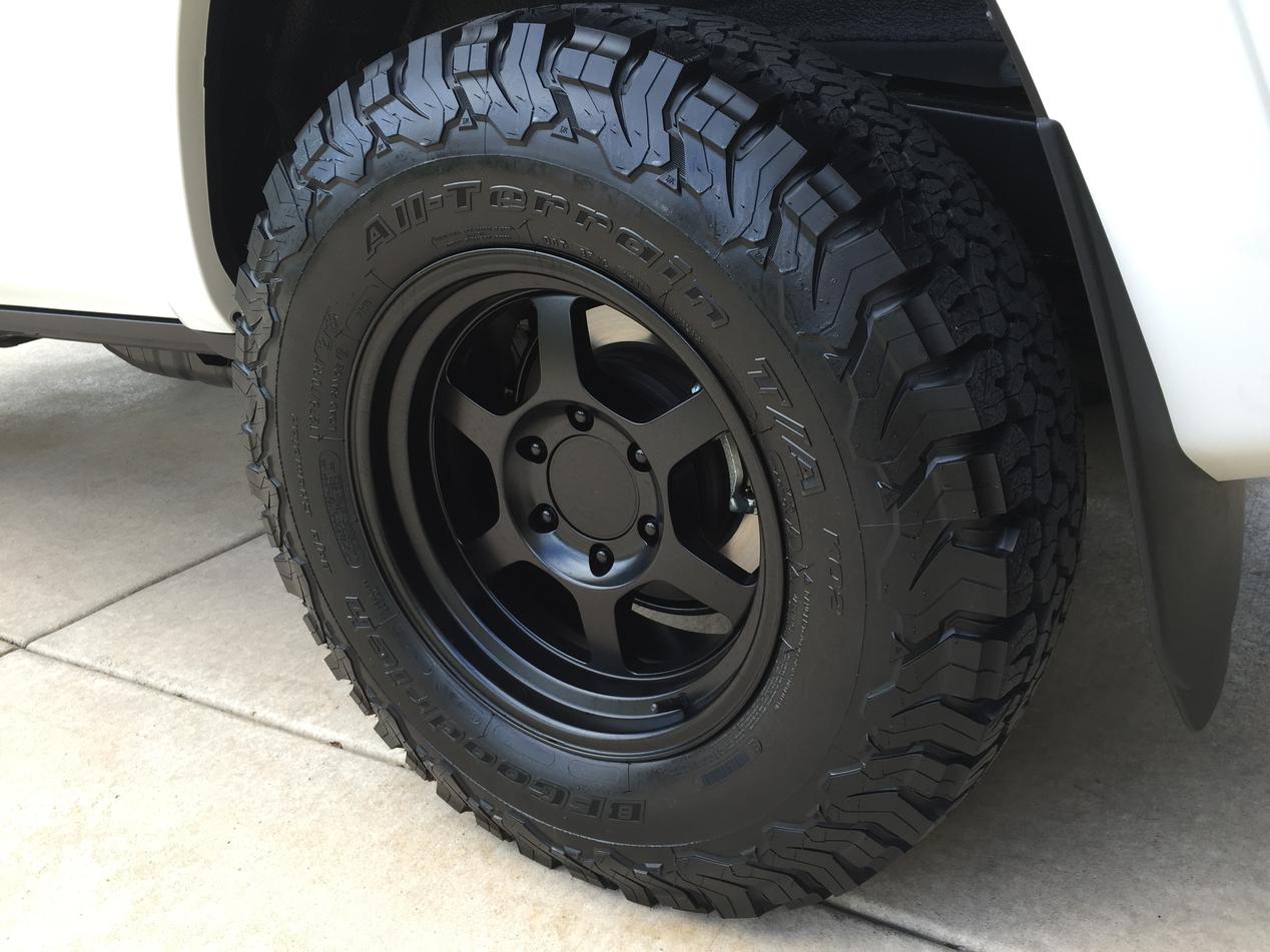

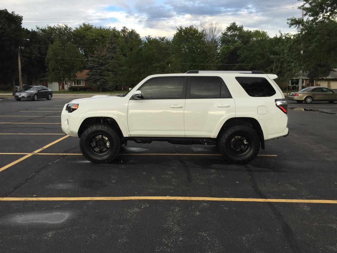

Countersteer type X and BFG 275/70/17
Bilstein 6112/5100
No rubbing

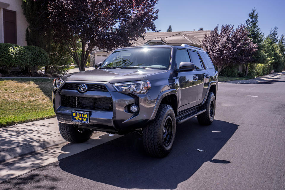

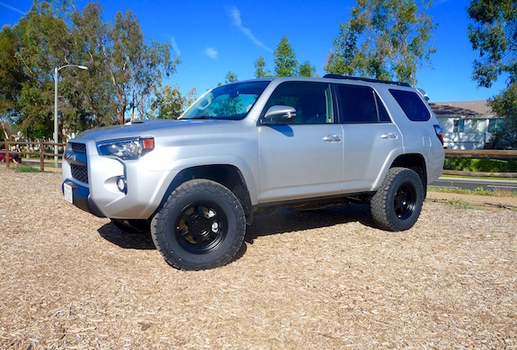

Mine are Nitto Grapplers G2s on Mickey Thompsons 17x9. I think with a 1" offset. Basic leveling kit for now on it. 3" in front 1" rear.

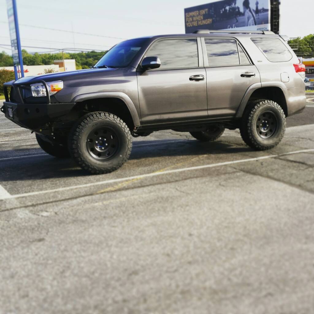

- American Racing, Baja, 17X8, no center caps, 0mm offset, 4.488 backspacing, weight-26lbs (Spidertrax 1.5 inch spacers all around)
- BFG KO2, E load, 285/70/17
- ICON Stage 2, Heavy duty front coilovers at 2.5", aluminum extended travel rears and overland rear springs
- No BMC needed
- No rubbing with pavement driving. I haven't have them off the pavement yet, so we'll see.
Edit: I'm rubbing on the body mount at full lock in reverse (on and off road). I'll eat my words. BMC is needed.

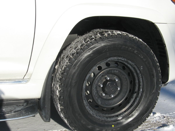

- Wheels: FJC Steelies
- Tires: Bridgestone Blizzak DM-V1, 265-70 R17
- Suspension: Stock w/ 4 X Bilstein fronts @ .85
New guy question but are FJC steelies the oem steel wheels for the Fj cruiser? I thought they didn't work due to disc calipers being different. This is exactly what i would like to use in the winter.
I got a set of 17x7.5 FJC steel wheels from the dealership last week and had Blizzak V2s mounted at Costco. No probs.
