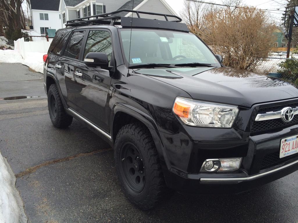

I'll re-post since my wheels and tires have changed:
- Wheel make, model, size, backspacing/offset: Konig CountersteerX [MENTION=85422]FNWheels[/MENTION], 17x8", 4.1" BS, -10mm offset. No spacers.
- Tire make, model, size: Cooper Discoverer STT 285/70
- Suspension: Specs in Sig.
- Body Mount Chop: Yep
- Tire rub: No. Not under full lock and/or full flex, nadda.
- Fenders: Front fender liner moved forward.
- Mud flaps: Removed fronts.

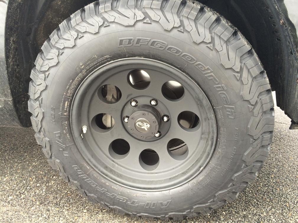

- Wheel make, model, size - Procomp Series 7069, 17x9 with 6 on 5.5 Bolt Pattern - Flat Black Machined, Part # PXA7069-7983
- Tire make, model, size - BFG TA/KO2 265/70/17
- Suspension - Stock
- Body mount chop - no
- Do your tires rub? - no
Just got these a week ago. Here are some general thoughts, mostly for someone in the middle of the "which wheel and tire combo should I upgrade to" research.
1. If you're wondering if you should go bigger, go bigger.
2. Black wheels seem to make tires look smaller than lighter wheels
3. If you have a Limited and think that going from the stock 245's to 265's will be a size increase it won't, you need to go 275 or 285 for any noticeable difference (Note: make sure you do your research if you go bigger). I missed this somehow, and might have gone with 275's...ah who am I kidding I want 285's.
4. Going with black rims will make your chrome trim stand out even more than it does now, I'm planning to plastidip soon.
Now to plan the lift...

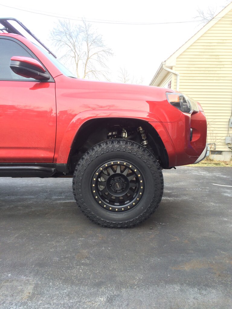

- Wheel make, model, size, backspacing/offset: SCS Stealth 6 in Matte Black 17x8.5, Backspacing: 4.30", Weight: 24lbs,Offset: -10mm
- Tire make, model, size: BFG KM2's 285/70/17
- Suspension: Icon Stage 2, Camburg UCA's
- Body Mount Chop: NO
- Tire rub: Slight Rub at full lock ( just a bit more to trim and it will be gone)

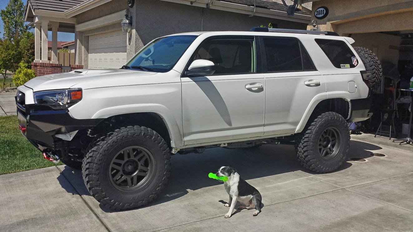

ImageUploadedByTapatalk1428352894.454833.jpg- Wheel make, model, size, backspacing/offset: Method Double Standard in Matte Black 17x8.5, Backspacing: 4.75", ,Offset: 0
- Tire make, model, size: discoverer st maxx 285/70/17
- Suspension: Icon Stage 5, Icon UCA's
- Body Mount Chop: Yes
- Tire rub: No

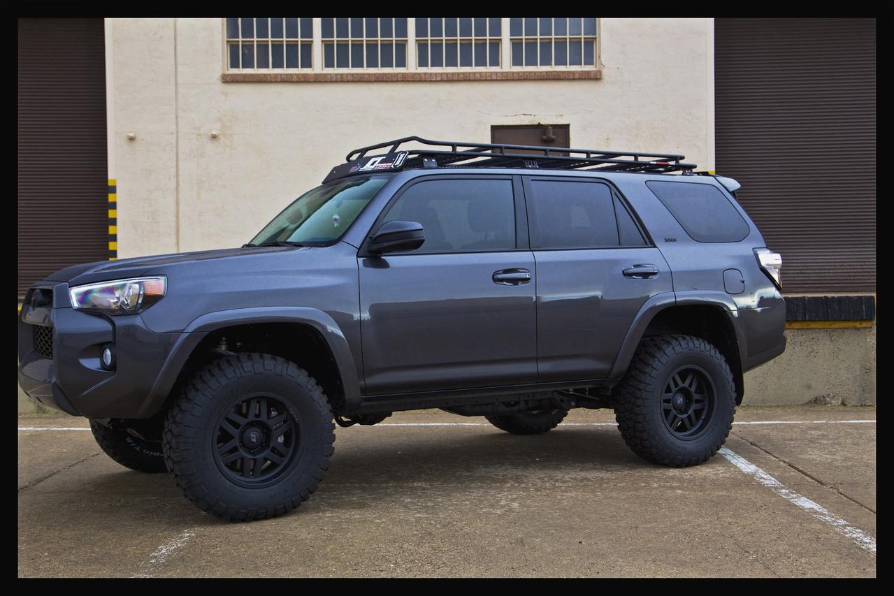

My current wheels and tires setup
Volk TE 37 18x9 0
BF KO 285/65r18
Stock Suspension No lift
It actually has more clearance then my 20's
The BF seems to run more narrow compare to my Cooper
Clears my body mount but I believe it very slightly rub the front liner in reverse but barely and only happens once in a while.
