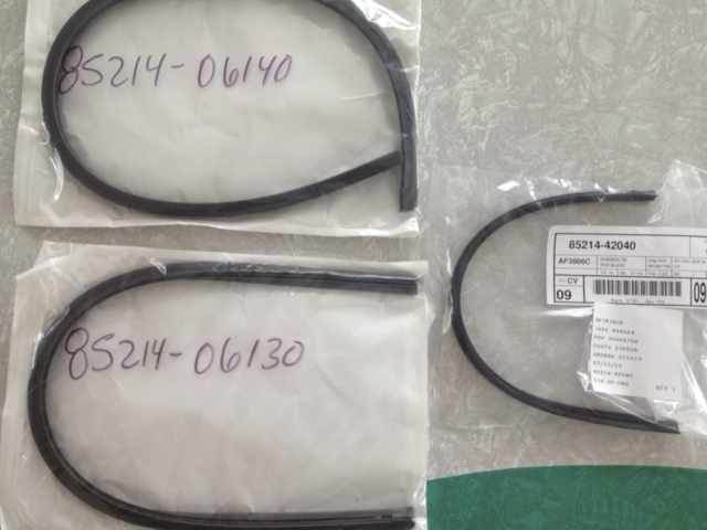

I just got the wiper inserts from partznet.com
The originals have lasted 3 years so far and I usually to need to replace every winter.
8521442040 rear $2.53
8521406130 Right $4.65
8521406140 Left $5.07
Are they easy to install? I've always bought the whole arm and have never replaced just the inserts. Do they just slip on and off? and how do you get to the rear wiper with it hiding under the spoiler??
I remember reading somewhere in the manual you're supposed to turn on the rear wiper, then turn off the engine while it's out. It's easier than it sounds since the lowest setting on the rear is pretty low frequency so it's not that hard to catch.
Really easy to install. Slide the old ones out, take out the metal rods from each blade, put the rods in the new blades, then slide back in. Rear wiper as mentioned is just turning the key all the way off while the wiper is down.
Bonus I asked my service guy to replace them when they do the driveshaft....easy. Thanks
