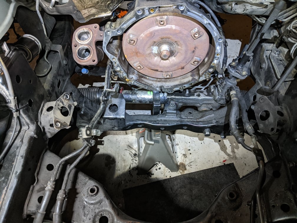

If your power steering hose is leaking...now is the time to change it. Plenty of room with the engine out!

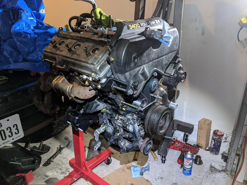

I think the oil pan was taken off at some point. It has white looking rtv around it. Did Toyota use FPIG from factory?

Mine has a whiteish/gray sealant as well. I believe it is sealed from the factory with this. I was going to reseal, but considering it isn't leaking, I decided to leave it be.

Yep all stamped steel oil pans on this Era of Toyota came with Gray FIPG from the factory. You can use permatex gray or copper RTV to reseal. If you do, make sure to peen the holes in the pan to get the bolts to pull on the pan.

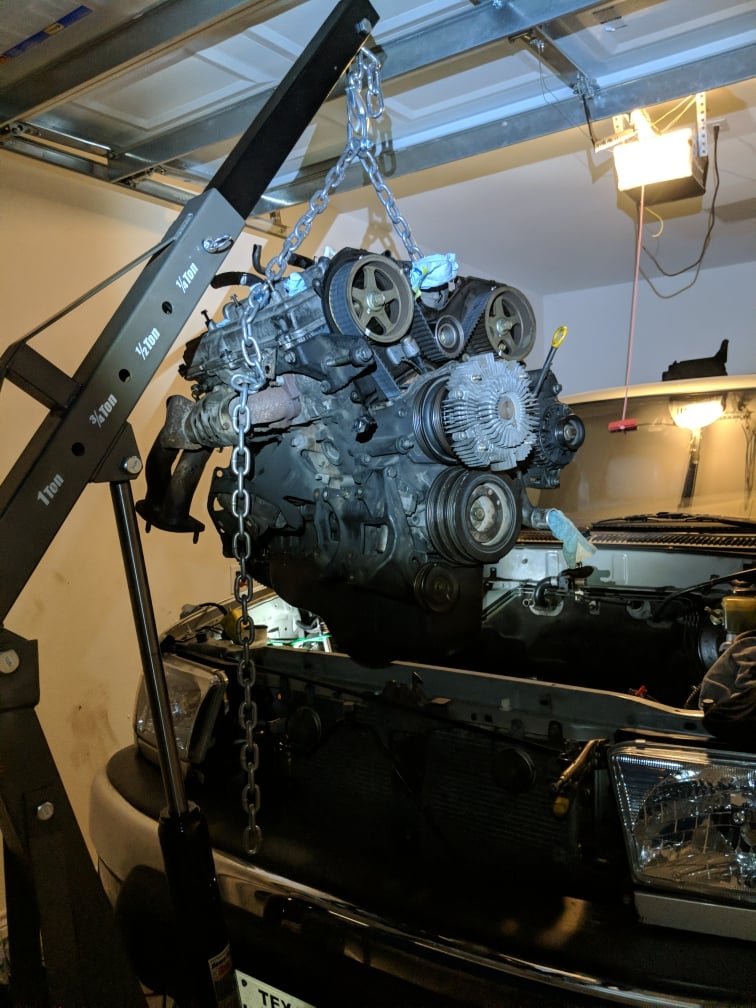

The engine came out with zero fuss. Like a freaking glove!!!
Broke the engine mount nuts and had it out in five minutes.
I took Charlie's advice and move the main hook up a few links.
Propped a jack under the bell housing to catch the transmission and shook the engine just a hair and the hoist just floated the engine. I didn't even realize it slid off the bell housing it was so smooth.
But I did g up the links to not pick up on it evenly and I let the slight torsion in the chain help me move it. After that it was slowly coming up albeit the passenger side head rotated forward at the end of it. But that's okay because all you gotta do is maneuver the hoist to counter twise and it will come out straight.

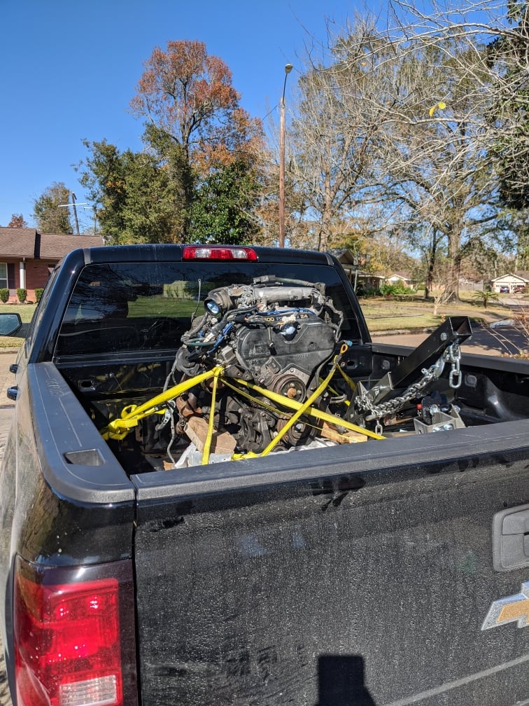

Got the donor engine with service records. I got an ECU and the harness with it. But it should be all plug and play with mine.

And just some advice for people who need to remove an engine from a wrecked 4runner... A 30 dollar harbor Freight reciprocating saw will be your best friend.
And breaker bars, an assortment of extensions (every Length you can get your hands on) And swivel sockets.
And back up ratchets of each size. The last bell housing bolt on the Engine we pulled was in a serious bind. I had to break the bolt by pulling the shifter out of the interior and putting extensions together so that the ratchet would come out of of the shifter hole and into the cab.
We couldn't break the bolt down below and we had a 1.5' long 1/2 inch ratchet. Mind you, my friend who is 6'-7" and about 275 didn't have enough muscle to break it under the truck.
Once I got the ratchet in the cab, my buddy held his hand on the ratchet to keep it in line with the bolt and I had to take all my 175 sweet lbs to break it loose. The ratchet was no more after that.
