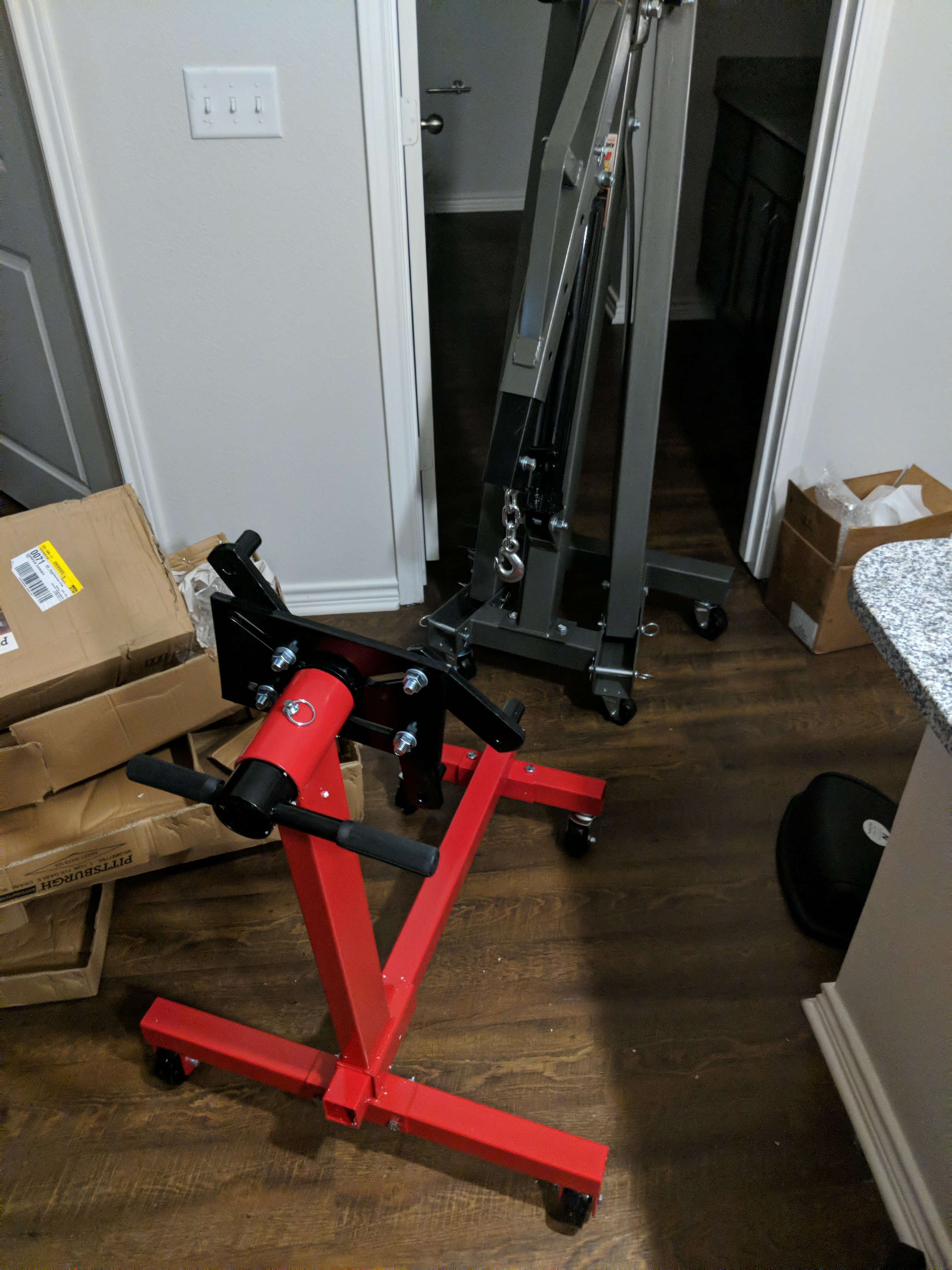

Hopefully I got enough extensions. Might have to go from 3/8s to 1/2 and back but I should be able to manage.
My tools of destruction are assembled and ready for battle.

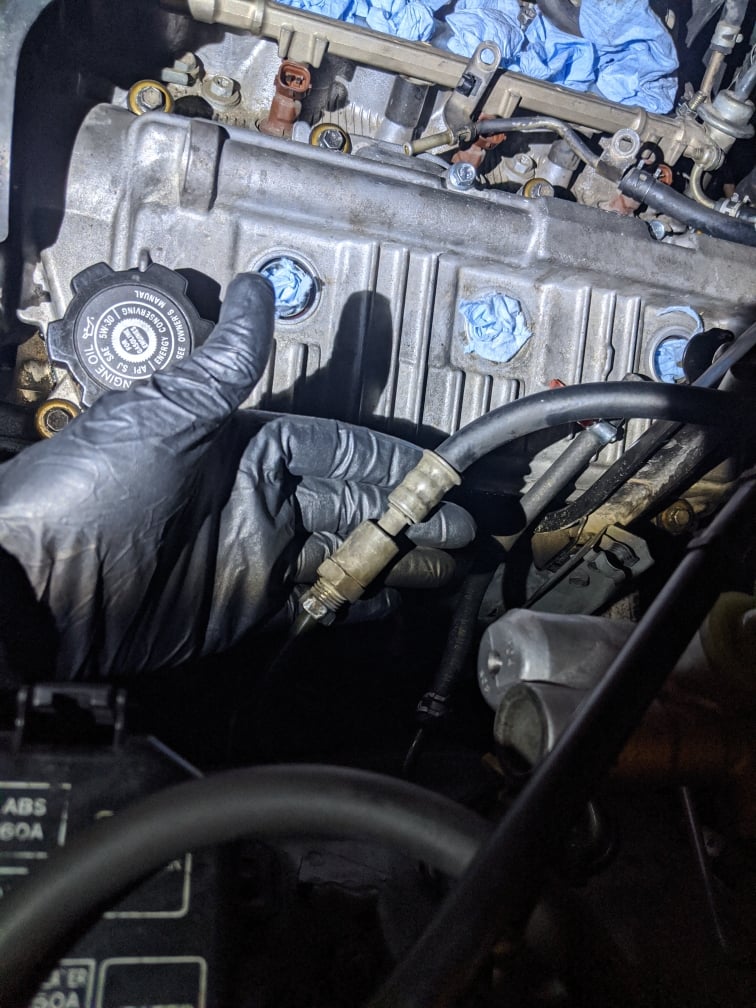

I'm almost chain ready. I got the bell housing bolts, 1 nut in the collector pipe and fuel inlet hose
My only concern is fuel inlet line. Idk why but every time I losen it it gets tight then loose. Now it's full bore tight
Any ideas? Anyone else have problems with this.

The high pressure send line on every 3rd gen I have ever disconnected from the fuel rail has always been sticky like that. Some resistance, even brand new ones from Toyota were like that.

It's been half and half on that fuel line fitting for me, some wind right out and some go on and off super hard. Line wrenches are a must when they are being difficult.

I too had the same problem with those dang tight fuel lines. I was afraid the threads were going to strip out. So I just screwed the fitting back ( I couldn't leave my rig down for a day) on. And orded the whole dang fuel line all the way back to the tank, and replaced it all from the fuel filter back when I did my fuel pump.
Just removing the gas cap released the tank pressure for me. Still, about 4oz of gas dropped when I cracked the fuel line.

I'm glad I'm not alone in the fuel line! Lol my goodness that thing is tight. I'll just keep going ham on it. I guess if it cracks it cracks. I got a big ass wrench on one side and the flare side has a flat nut wrench but I'll keep going it has to be close.
I'll run to harbor Freight this afternoon and just hacksaw that damn thing off.

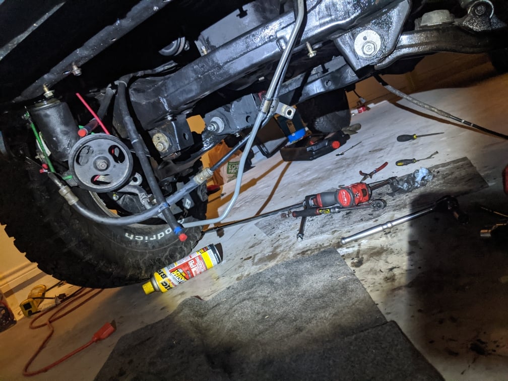

Anyone got any tricks for hitting the outside bolt on the collector pipe? I can't get a socket fulley seated. I was gunna go remove it from the hanger in the back and try and maneuver it but I think that would put the bolt in a bind
So as a back up in gunna go buy a universal joint.
I don't have my lovely stubby air impact 850 ftlb break away torque wrench [emoji24] it would decimate all stubborn bolts in it's path
I only got a 3/8 Milwaukee impact but I don't think it has enough balls to get it.

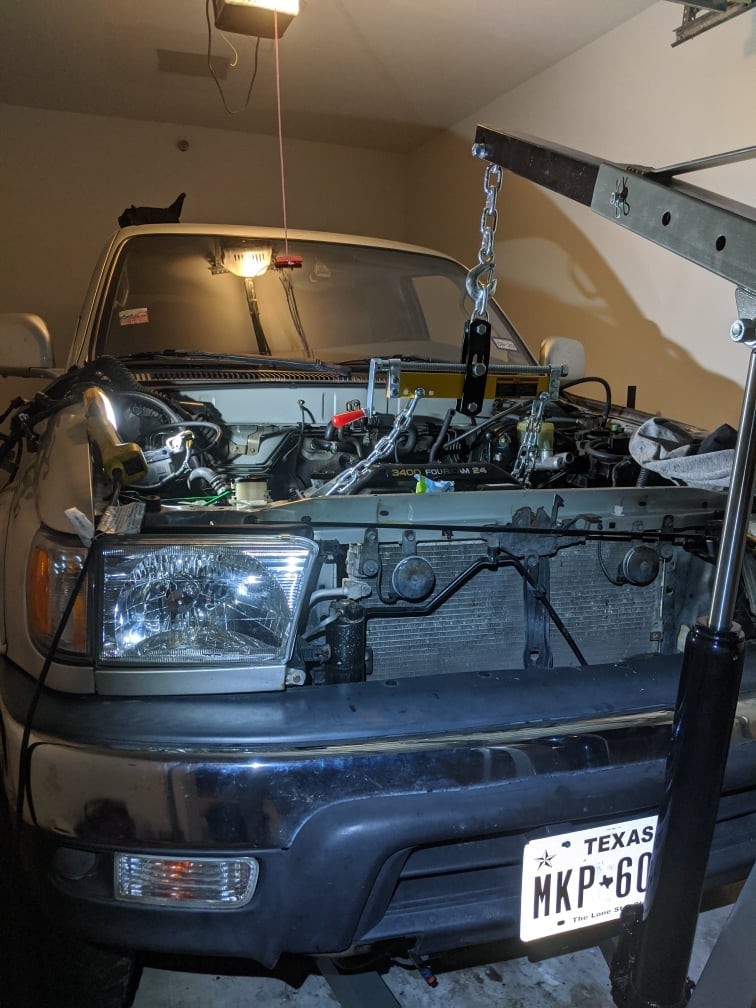

Engine is hook ready.
I got the fuel line loose. You guys were right just kept wrenching on it and it came off.
I got the nut off on the outside of the cross pipe with a 3/8 socket and it was a 14mm IIRC. You want to use a 3/8 because the 1/2inch is gunna make it harder for the socket to sit flush. What I had to do was put the socket on the nut first. Then grab 2ft it 3/8 extension and hammer the extension on to the socket. I would not recommend doing that any other way otherwise you run the risk of shearing the nut.
You can apply this method to the upper bell housing bolts. I used 56inch (4ft) extension for the upper ones. Put the socket on by hand first. Verify its flush. Then pound the extension into the socket.
I would recommend a big 1/2ratchet with some leverage or you can try a breaker bar. Don't like using those because they limit your ability to swing it freely when your in a cramp space and need to make adjustments.
The amount of extensions you have to goes up the higher you work up on the bell housing. This exlcuds the bolts for the starter
I had to use a deep socket and a half inch ratchet only to get the upper starter bolts off. I would definitely recommend getting a ratchet with alot of teeth to get the right engagement.
After you get some engagement with the ratchet take a hammer and hit the ratchet handle to break the bolt lose, you night have to do this several times. The power steering line is gunna be obstructing you. So it's hard to get enough power behind the ratchet with only 1/2inch gap which is why the hammer worked better.
A wobble would be probably be a good alternative. Not sure how much different the 4x4 setup but the above tricks worked for me in digging into the 2WD drive, 5VZ-FE removal.
Just if your in a bind and you don't have limited tools you can get it with the above method. It will worth Everytime. Mine Sledge solves everything.
She is hook ready. Gotta find where this m12x90 bolt is supposed to go on the passenger side....I could not find it. And I'm hoping I actually have a m12x90 bolt and not another size
And just FYI if your picking this out of a lifted 4runner get the biggest hoist you can find with alot of reach. I'm probably gunna have to jack up the rear end to get the hook in proper position. Maybe air out the front tires too but it's a home stretch now.

Shorten up the top chain by connecting to one of the lower links instead of the end link, that will gain you a few inches.

Broke the engine mount nuts and had it out in five minutes.
I took Charlie's advice and move the main hook up a few links.
Propped a jack under the bell housing to catch the transmission and shook the engine just a hair and the hoist just floated the engine. I didn't even realize it slid off the bell housing it was so smooth.
But I did g up the links to not pick up on it evenly and I let the slight torsion in the chain help me move it. After that it was slowly coming up albeit the passenger side head rotated forward at the end of it. But that's okay because all you gotta do is maneuver the hoist to counter twise and it will come out straight.
That was a hell of alot easier than I expected.
Thanks everyone for the help! Get the donor engine Saturday. Gunna do alot of TLC and restore this thing engine bay to it's oil free glory now
