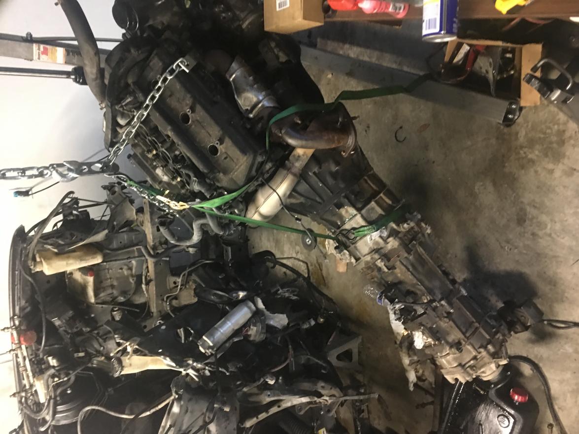

I had my brother and a friend helping in the extraction. After I got the transfer cast over the front diff I wrapped a chain around the tail and hooked it to the chain at the intake to keep the tails angle correct so I didn't have to be under escorting it the entire way out.
The next time will be easier.[emoji12]
All I had was a ratchet strap from Lowe’s. Worked okay but it could not come close to leveling it. This was with the front diff out and I cut off most of the front of the 4runner. It’s a donor
Don’t know why picture is sideways

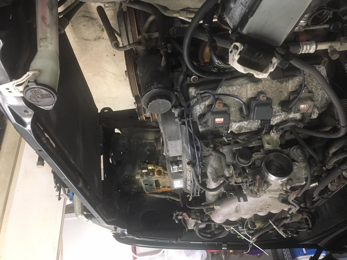

Manual 5 Speed Engine/Tran Removal Together
Removing the hydrolocked engine on a 1999 SR5 SE. Runner has 451K miles on it so I am going to remove transmission for inspection. Is it possible to remove both engine/transmission as one unit without removing A/C condenser and cutting any structural members?

Instead of buying wobbles to reach the bell housing bolts, and struggling to get to the cross pipe with where the body sits on the frame
If I want extra room to work with and avoid tight spaces and using wobbles, couldn't I just unbolt the body from the frame and jack the body up?
In my head, I would only jack up one side at any given moment. I got couple of 4x4s for a fail safe to throw in.
Break the bolts on the starter, bell housing and cross pipe, lowerr down pass side, then jack up driver side to get the rest of the bell housing bolts.
Sent from my Pixel 2 XL using Tapatalk
I think it’s easier to buy a swivel socket. You will have to remove the steering shaft to lift the drivers side.
This.
Just buy a 1/2" swivel socket (a good one) and be done with it. You'll need a bunch of long extensions but getting the top bell housing bolts really isn't that hard once you figure out the angle/approach to take.
