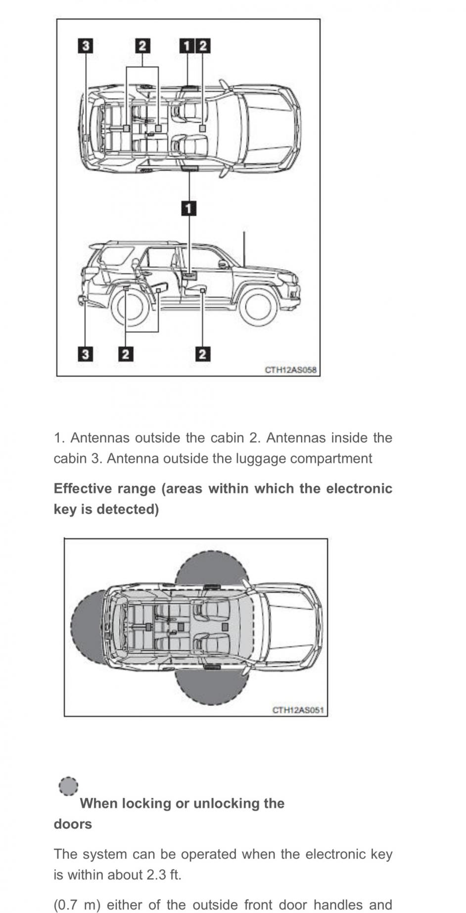

I think I figured out the problem but not sure about a fix. I'm not mechanically or electrically inclined at all. Its the smart key antennas that have a ridiculously crappy range. I attached a picture of antenna locations and range.
If I get out with the key and move to a rear door or by the time I get to the trunk door, its not longer reading my key. Which causes all the beeping. If I leave the key on the driver's seat and do all that, no beeps.
Makes no sense since I can unlock it from far away. It reads the key then but walking around the runner it can't find it.
So my questions are: Would installing a remote start system do anything for this? Can two more antennas be installed in the back two door handles?

Follow-up:
Found this page that explains it perfectly.....
Toyota 4Runner: System Description - Smart Key System(for Entry Function) - Service Manual
About a 1/4 of the way down, it says this......
"Key Cancel (See page )
The following key functions can be canceled:
Entry unlock/lock
Entry ignition
Entry back door open
Key lock-in prevention
Warning"
The Warning is what I'm targeting. About half way down this is the exact problem (below) and with the above, it can be cancelled. Not sure a dealer would do that though.
