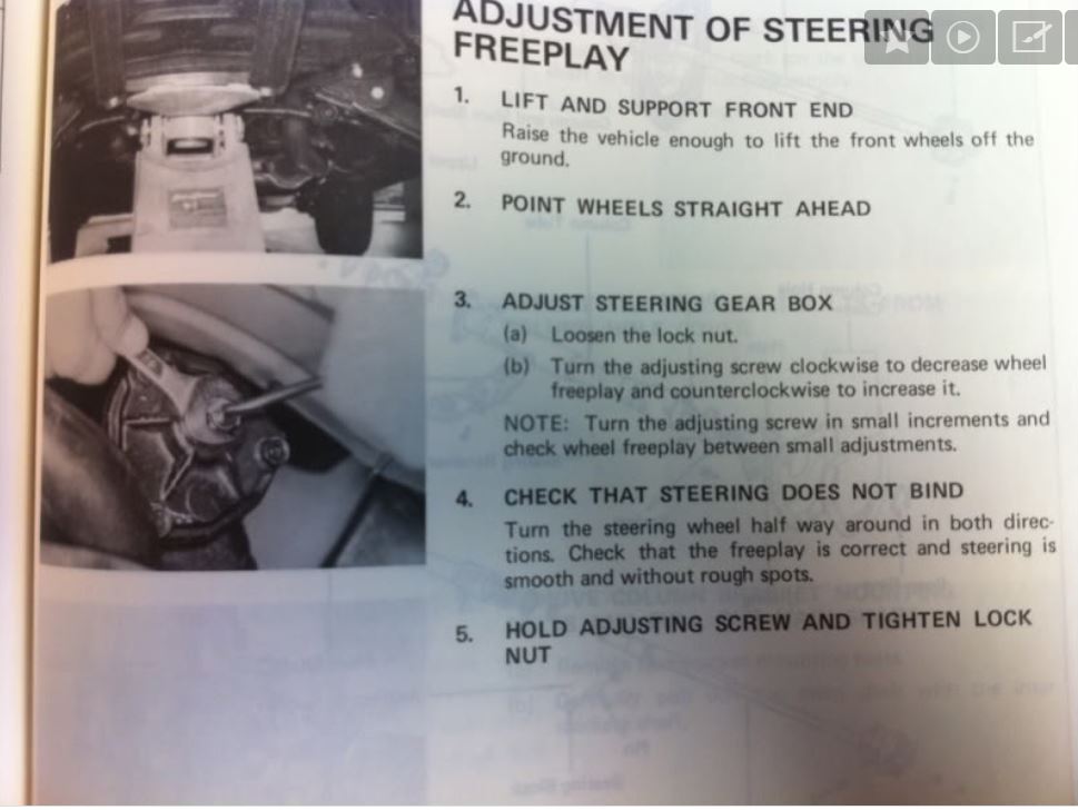

The steering is a bit sketchy at higher speeds, not sure if this is a characteristic of the solid axle? I've heard crossover steering fixes this but that's another thing that's not legal to do so I've learnt to deal with it.
that sucks that you can't convert to cross-over (high steer) it is a huge improvement over the stock push pull steering.
Things to check that could improve your steering would be to check the usual stuff -(which you probably did) would be tie rod ends, bearings, drag link,
There is a nut and screw on top of the steering box that you might be able to tighten the steering up a little
Yeah, if it was easily reversible I would do it, as if I get picked up by the cops without an Engineers Certificate, it would be put off the road for good.
The steering was a lot better when I first got the car, so I'm guessing it may be the drag link adjustment. I'm halfway through the rear brake job at the moment so will check that once it's back on all 4's. Thanks for the tips!

Did you get your steering sorted?
If not can you post a picture of the steering setup? I'm curious if it's similar to the Y link on my XJ which I went through top to bottom to get it working correctly again.
With that being said, my issues related to a couple worn out parts (it's an 88 I bought for 1500$ from some sketchy folk).
1.) Steering box was toasted, it has the same adjustment process as you indicated in the picture you posted but that's just tightening friction on the worm gear and is not a resolution for a worn out steering gearbox. Mine had an 1/8th turn of play in it and at high speeds/hitting bumps it's pretty horrifying.
2.) My Hubs were bad, like fell apart in my hands bad. So they wobbled causing it to resonate through the steering linkage causing death wobble.
3.) Finally all the bushings were toast especially the TREs. I went to a larger Diameter tie-rod and OEM ends and it did the trick. I have looked into spherical ends (jonny joints) and would have gone that route if I had a reamer handy
I have read a couple times on here about people recommending steering stabilizers to help but from my experience, while nice, they are just a bandaid instead of a fix.
