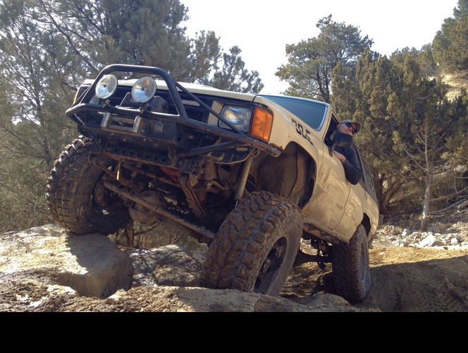

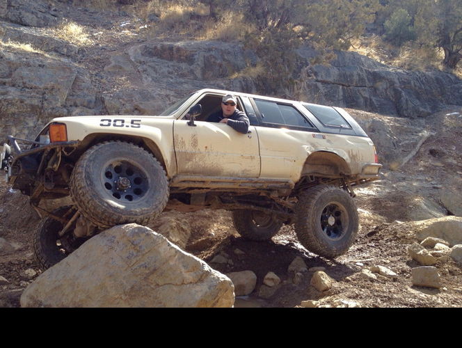

Having said that, you're looking at this 4Runner, and it's a steal at $4500. I almost bought that truck myself when the original owner was selling it, and I thought seriously about it again when the current owner put it back up for sale. I know the guy that built that truck, and he's an excellent fabricator and builder. I'm going to be sad if you buy it, because the guy who is selling it wants to get a Jeep, but to answer your question... yes, if you're looking for a truck that's already built, that's a very very good deal.
Ok here we go. Thanks Silentyoda.
KidV knows his stuff better than I do, and personally knows the guy that built it and the reason for the current owner for selling.
that being said, I agree with him, it's an absolute steal!
