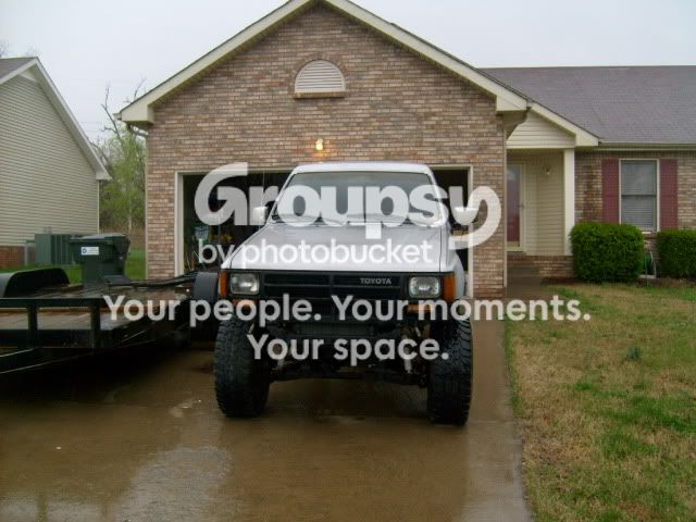

As the 4runner sits now I put in a 5 inch TG lift in the rear:
S6300373.jpg~original
I took the axle apart and cleaned everything up. Sanded the axle down to the metal and repainted it. The guts are stock (for now).

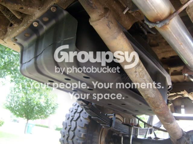

While I was working in the read end I couldn't stand to look at the old nasty gas tank. Plus, I had to pull it to grind and weld the new rear spring mounts. So It got a good cleaning, and sanded down to the metal. I re coated it in a rubberized undercoating. Now it looks brand spanking new :)
S6300374.jpg~original

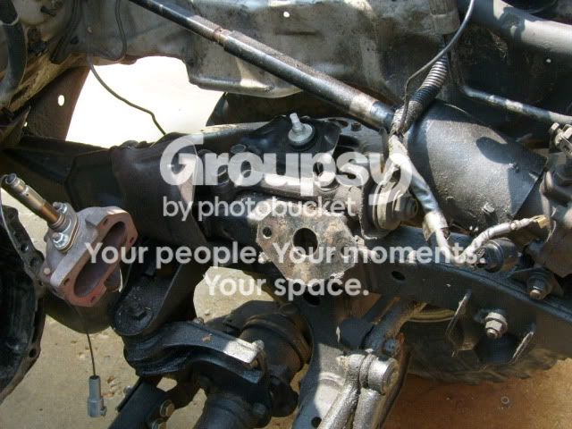

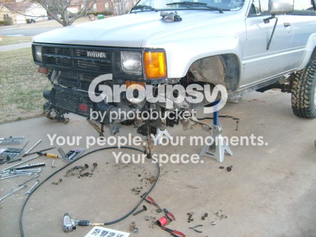

4 inch rough country IFS lift in the front (only till I do my SAS):
S6300191.jpg~original

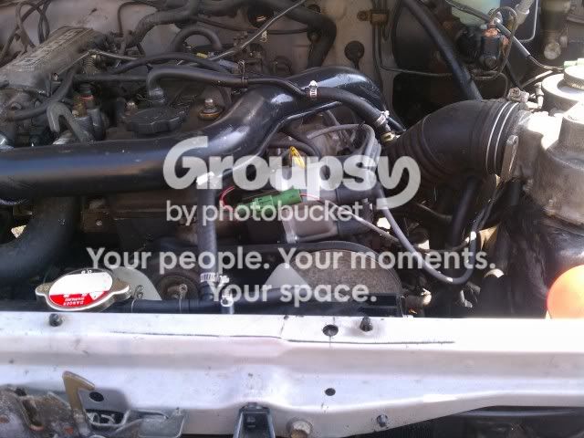

Yes, the p/o had an intercooler on a t4 turbo that was too big for this motor, not to mention any time I gave it gas the ECU would cut the fuel. That turbo didn't last long. I put a stock turbo on it ASAP!
S6300318.jpg~original

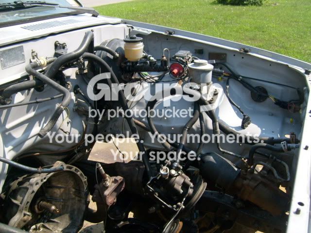

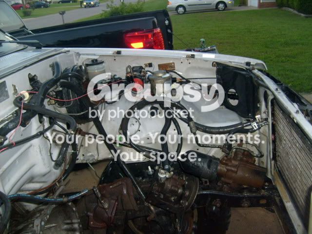

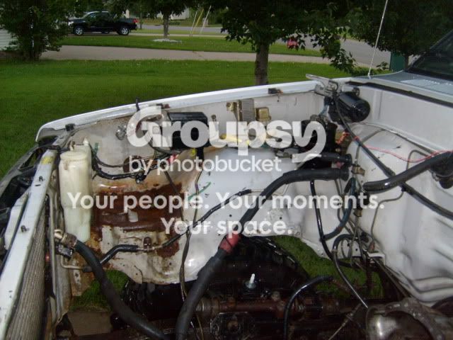

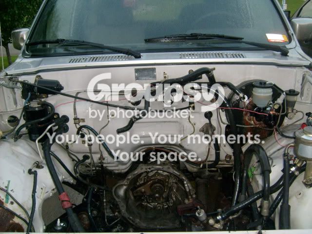

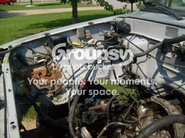

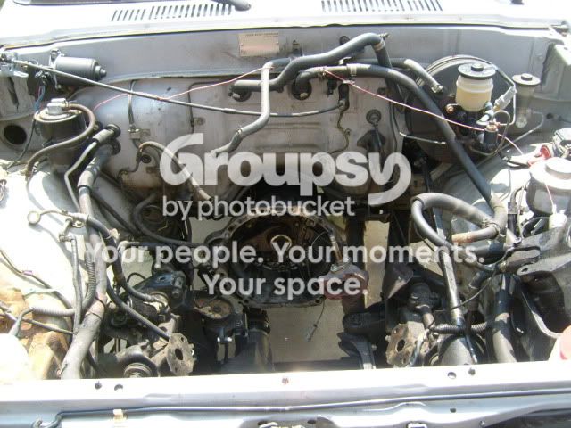

Engine bay as it sits right now:
S6300358.jpg~original
S6300359.jpg~original
S6300360.jpg~original
Today I'll clean the snot out of the whole area and make it all new and pretty.

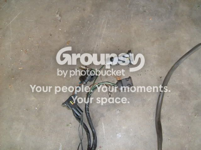

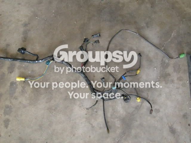

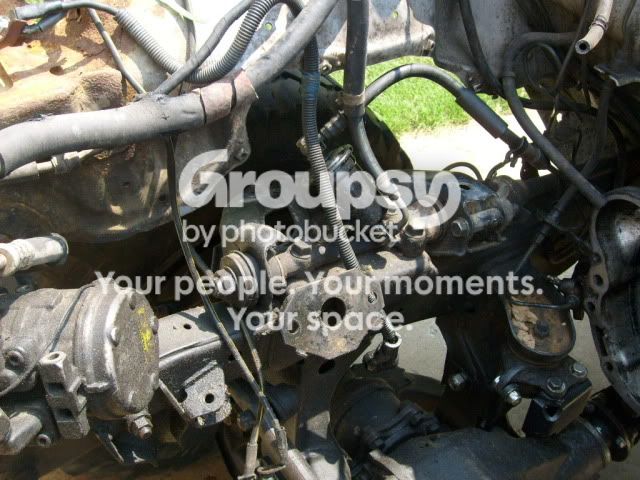

The wiring harness:
:barf:
S6300361.jpg~original
S6300362.jpg~original
The plans here are to clean the whole harness and re-wrap it in some new loom. The plug for the fuel injector is rigged by twisted wire (thanks to the po), so that will get soldered and cleaned up.

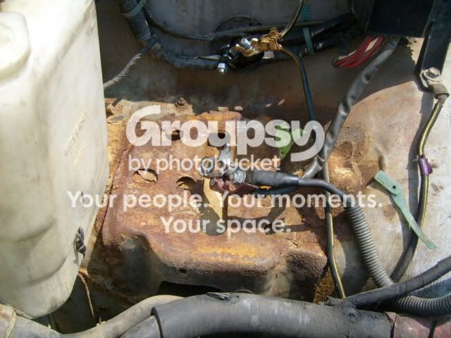

And a rusted out battery tray from a po's bad battery:
S6300357.jpg~original
I'll find a replacement from someone who is willing to cut that section out from a parts truck and weld it in.

So I pretty much have nothing but busy work until next week when I get my motor and parts back from the engine shop. So, I pressure washed the engine bay and the undercarriage of the 4runner 3 times after letting it soak a few times with a ZEP industrial concentrate de-greaser.
It's not perfect, but it is MUCH better:
S6300375.jpg~original
S6300376.jpg~original
S6300377.jpg~original

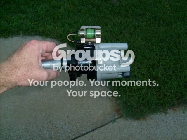

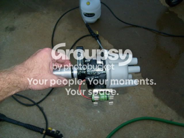

I also cleaned the snot out of the distributor and put some paint on it:
S6300378.jpg~original
S6300379.jpg~original

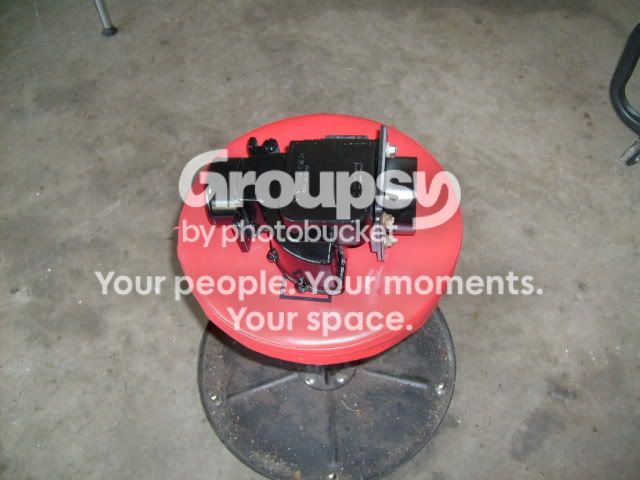

But I scrubbed the engine bay again to try and get it better. I also picked up a n/a AFM, cleaned it up and threw on a nice coat of gloss black.
S6300382.jpg~original
S6300383.jpg~original
S6300384.jpg~original

What lift, front or rear? The rear was a lot easier than the front. All I had to do for the rear was cut the stock leaf spring mounts off of the frame and grind the frame smooth, then weld on new ones for the longer springs. Do a little cutting, sanding, welding on the axle and I'm good to go.
The front was a pain in the @$$!! I was taking hardware off that hasn't been off in 25 years, I had to replace a couple of steering knuckles because they were impossible to get off. Overall on the front, it wasn't too bad but it was still a pain in the arse. If you have air tools it will be much easier.

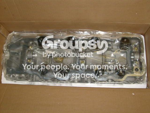

Well... I haven't got much done lately. I've had a fever since saturday and I think I finally broke it. So I spent some time in the garage today! I picked up my block and connecting rods from the shop today, I got my rebuild kit in on Monday, and my Street RV head in yesterday. I wasn't happy with the hot tank job that was done on the motor so I taped the snot out of it and plugged all the bolt holes. I'm going to carefully sand blast the block before painting it.
I am however very happy with how all my little parts came out from the hot tank. They will be getting painted tomorrow.
I needed to order a new crank shaft, and I also ordered an LCE Header but they are on backorder for 3-4 weeks. Too bad, I was excited about driving my 4runner sooner!
Here's what I got for the porn so far:
New head, there's a box beside it that has a 268 cam in it too :)

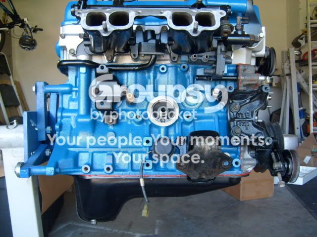

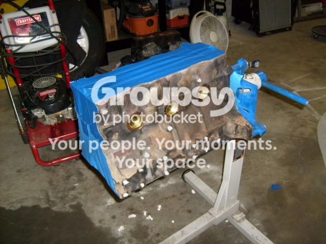

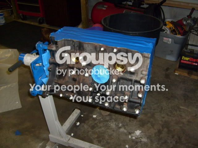

The block all prepped and ready for sand blasting then paint:
S6300388.jpg~original
S6300389.jpg~original

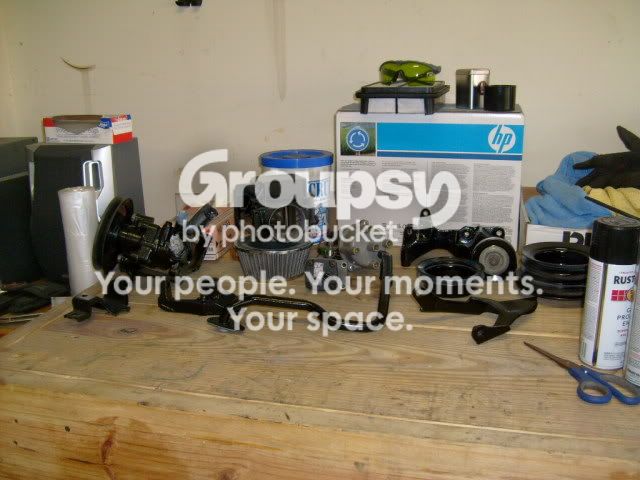

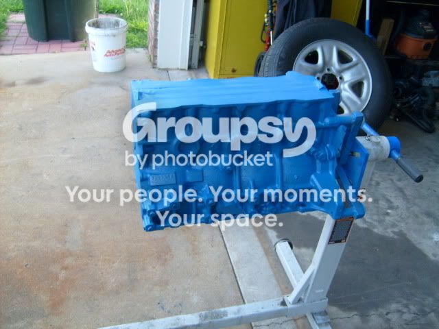

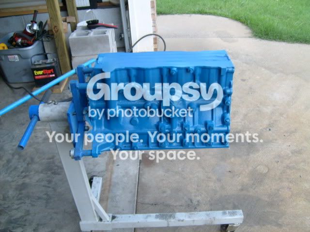

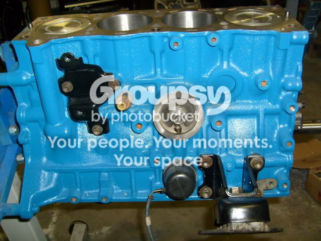

I'm not in too much of a hurry, I don't have my crankshaft yet so I cannot do too much in the way of assembly. My pile of painted parts on the bench is growing and I put some high temp paint on the block. The block is fit for a smurf :)
Pile of cleaned and painted parts :)
S6300392.jpg~original
Pretty fuel rail :)
S6300393.jpg~original
And the blue block!
S6300390.jpg~original
S6300391.jpg~original

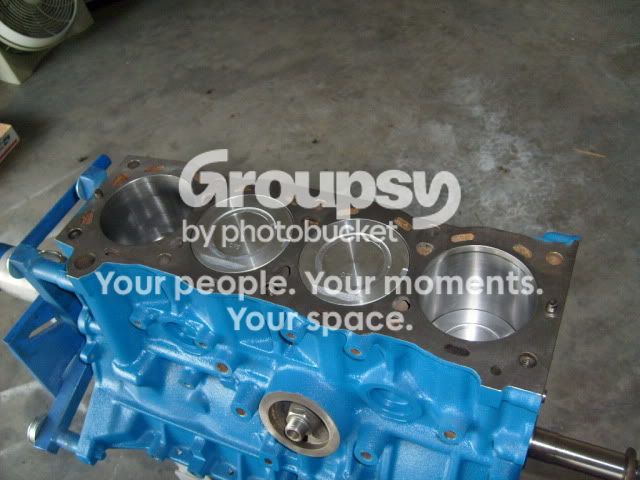

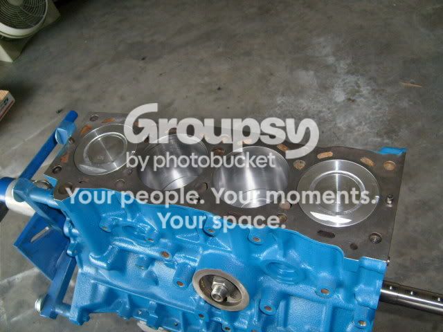

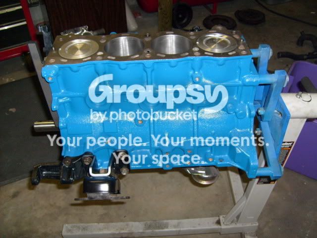

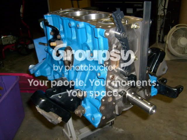

So for the last week or so I have been waiting on parts to come in the mail to start putting this motor together. I got the new crank in but then I had to send the over sized main and rod bearings back and get standard ones, had to wait for them. Thanks to Ted at engnbldr he shipped the new bearings right away, before I sent him money for shipping or sent him the over sized bearings. Thanks Ted! (fiy: engnbldr is by far the best place to work with to get parts or answers about the 22re!)

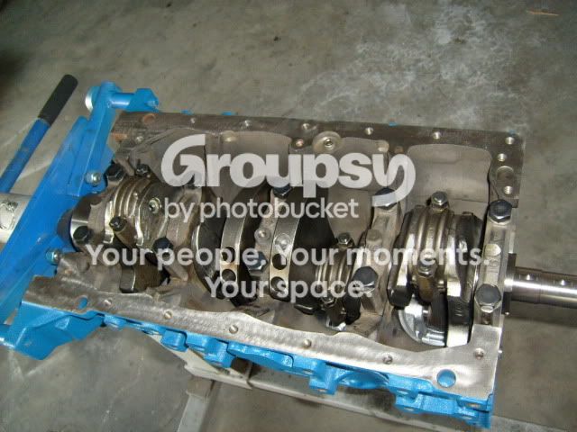

Anyways, I got some assembly done today. I put the crank shaft, pistons, and a few external goodies bolted on. I took some measurements of the quench on the pistons and I am very happy with the results!
Quench Measurements:
Cyl #1: .017
Cyl #2: .018
Cyl #3: .020
Cyl #4: .017
According to an article that I found that was written by Ted at engnbldr, anything within +/- .006 is excellent! Mine is +/- .003! So far I am happy with the work that was done by the machine shop!
Anyways, enough talk, here's some porn:
S6300394.jpg~original
S6300395.jpg~original
S6300396.jpg~original
S6300398.jpg~original
S6300397.jpg~original
S6300399.jpg~original

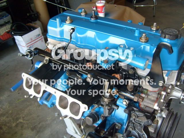

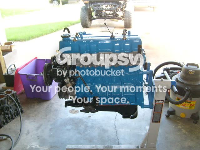

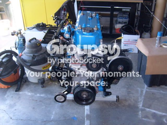

I got a bit more done... it's been hard to get time to work on this thing! Anyways, at this pace I'll have the motor in tomorrow. My headers are on back order from LCE, but I should have them by the 20th.
Here is what I have so far:
S6300406.jpg~original
S6300407.jpg~original
S6300408.jpg~original
S6300409.jpg~original
I need to get some hardware and some plugs for the thermostat housing. This WAS a 22rte motor (except the block) so the thermostat housing has two un-needed spots for sensors. Hopefully I'll have this motor 100% ready to be dropped in by tonight, then take tomorrow to install it and finish everything up. :)

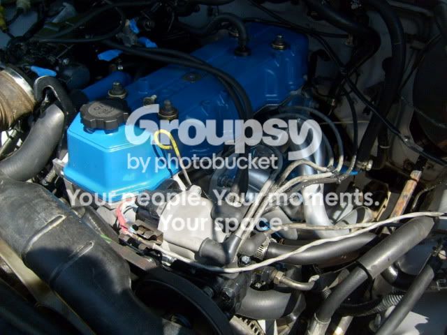

It's been a while since this has been updated but I've finally finished everything!
Just a little bit of filling in the blanks... I got the motor installed and put on the LCE Headers, welded the old exhaust together. I had to use a 2.5"/2.25" reducer for the LCE header. I also fabricated a new mount for the AFM because I got rid of the box style air filter and assembly. I am now using a cone filter.
Here is the AFM bracket I built:
S6300424.jpg~original
And the finished result:
S6300425.jpg~original
I just finished the first 100 mile oil change and valve adjustment. All I have to say is WOW!! This is far from a race car but it has a LOT more power than my old RTE motor that I had in it previously. With the few performance mods that I put in it (bore .030, RV Head, 268 cam, LCE Header), I can definitely feel the power that this little 4 banger is putting out. My 4runner is on a 5 inch lift with 33's and stock gearing and I have no problem getting up to speed or maintaining speed going up hills. I haven't even ran it hard yet and it's definitely making me very happy!!
