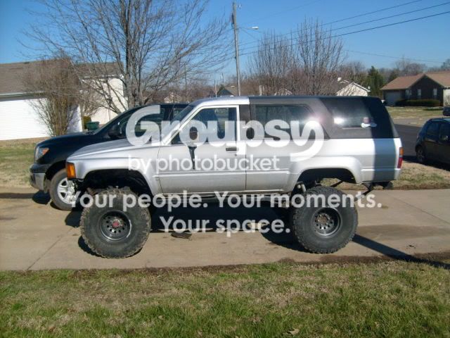

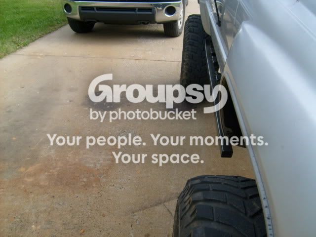

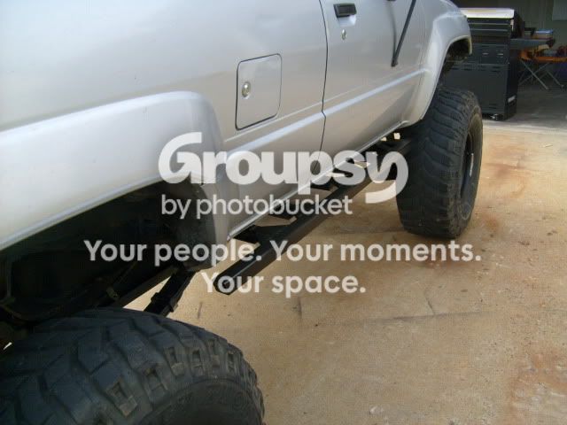

So I built some rock sliders using 1 3/4 HREW square tubing. Total length is 66 inches so they are pretty much flush with each fender. They stick out about 4 inches from the body so they're flush with the edge of each fender.
Front view:
S6300431.jpg~original

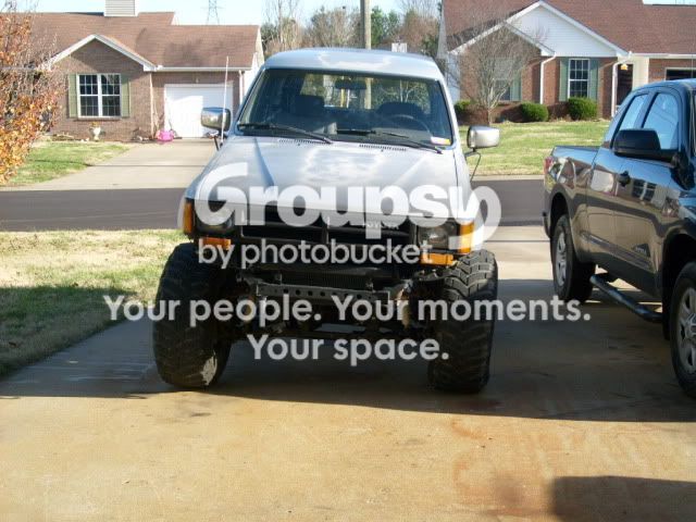

Rear:
S6300432.jpg~original

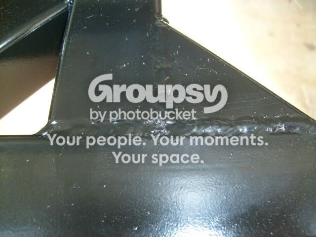

Welds: (not the best but I'm no pro at welding... good penetration and definitely strong welds)
S6300434.jpg~original

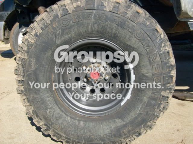

I also added some 35x12.5x15 Mickey Thompson Baja Claws on some 15x10 steelies:
S6300433.jpg~original
How much did the tubing run you?
I bought 2 sticks of 12ft 1.75" square 1/8" wall tubing, along with a 4 ft stretch of 4"x3/16" flat stock to use as pads against the frame and capping the end of the tubing. I used all but 3 feet or so of the tubing and used about half of the flat stock. Total between the tubing, cutting discs and paint I spent right around $100. The steel alond was about $70 or so.

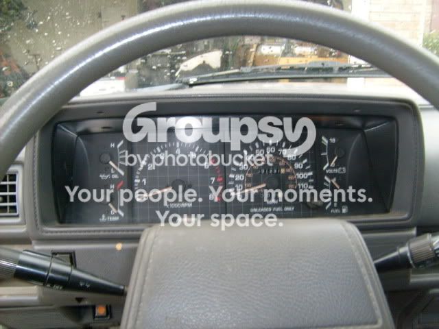

I recently added an SR5 cluster... nothing special, but it's nice having a tach and an oil psi gauge instead of just an idiot light.
S6300464.jpg~original
Nice job on the cluster swap. Having a tach is defiantly nice.
Thanks! I agree on the tach, that was my motivation to do the swap. Having the tach is also what led me to realise that my motor was bogging down at 4k rpm. I thought before that I was just hitting fuel cut due to redline.

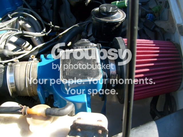

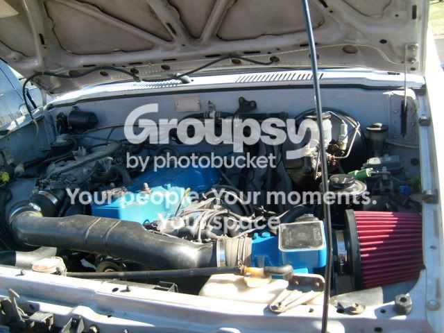

First, I replaced the knock sensor, o2 sensor, water temp sensor and got another AFM and painted it to match the engine bay. I also got an awesome deal on a cone filter so I replaced it as well.
The new AFM and filter setup, the idle is much more consistent and no more fluctuation.

I was also running steel wheels and I switched to some aluminum ones. I thought the steelies were robbing too much power for rotating mass. I got some polished aluminum rims and sanded them down to nothing. Then I used some self etching primer and hit them with a metallic charcoal top coat.
S6300521.jpg~original
S6300520.jpg~original

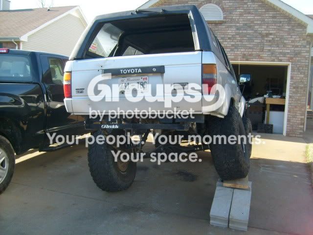

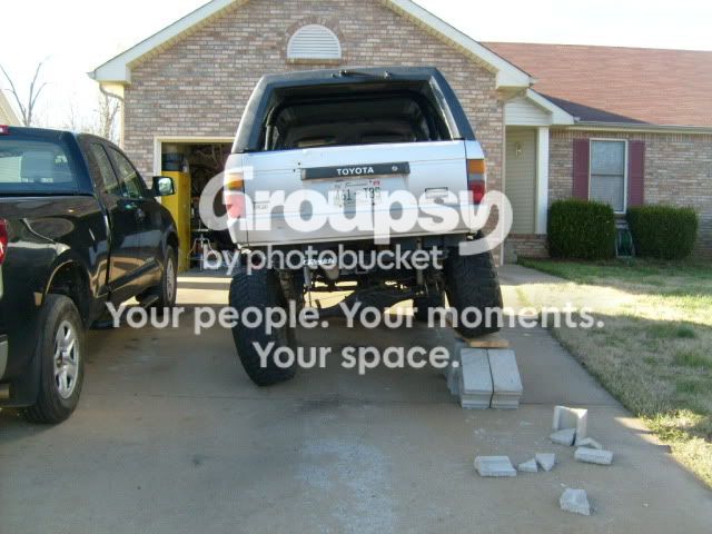

I also needed to more the rear axle forward a bit to get rid of a rubbing issue while flexed. So, like a photo whore that I am... I took a few poser pics. The flex isn't too impressive in this picture but it still gives a decent perspective of what it can do :)

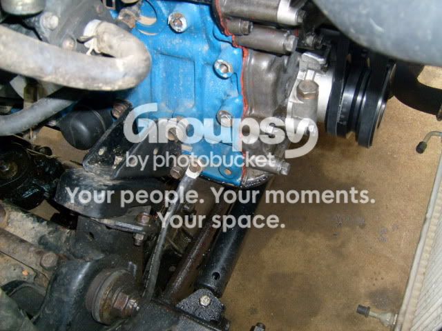

I also have a bit of an oil leak coming from the oil pump front main seal where the harmonic balancer goes in. The balancer has a groove worn in and the seal can no longer do its job. So... I ordered an under drive pulley kit from LCE. I'm also going to delete the AC system. Between the light weight balancer and no more AC condenser, that should free up a bit of power. More pics to come once installed :)

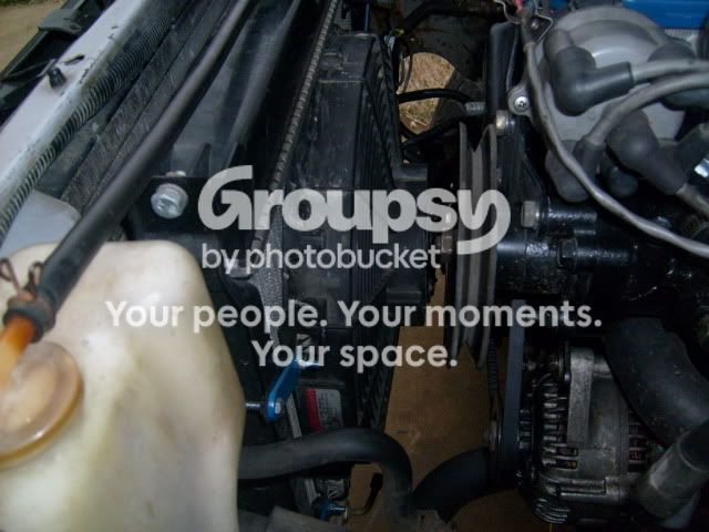

Time for an update... I installed my LCE under drive pulley kit, deleted the A/C system and the belt driven fan, and installed an electric fan using a permacool unit and a 16" hayden fan.

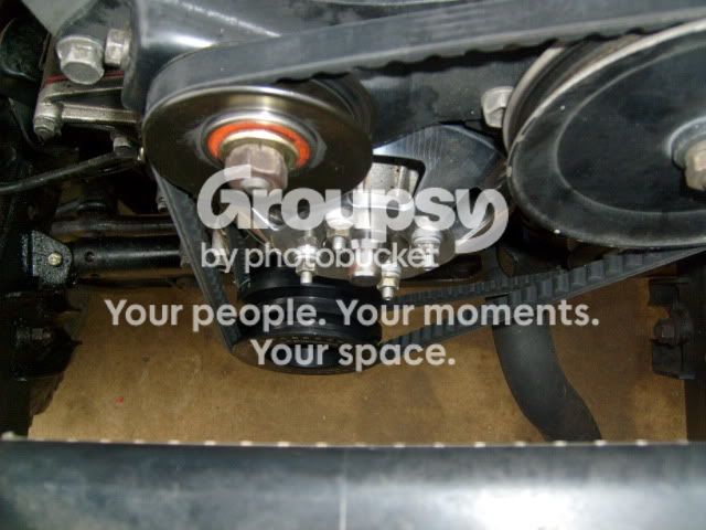

Pics of the under drive kit:
S6300524.jpg~original
Buh-bye air conditioner:
S6300525.jpg~original

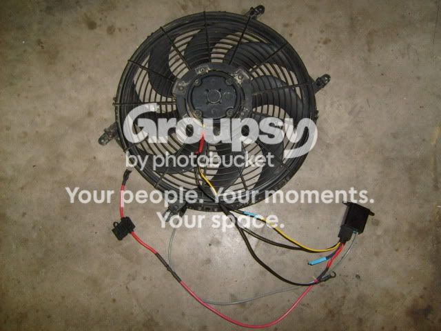

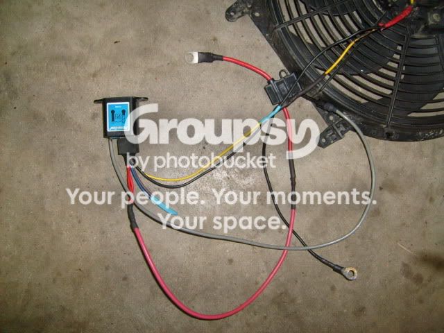

Here's the fan with all the wiring cut to length.
S6300526.jpg~original
All connections soldered and heat shrink wrapped.
S6300527.jpg~original

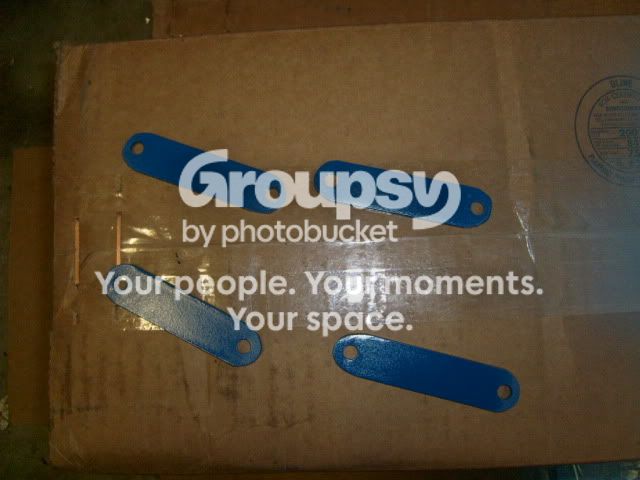

Built some quick brackets to hold the fan to the backside of the radiator. And of course, they had to be painted blue :)
S6300528.jpg~original

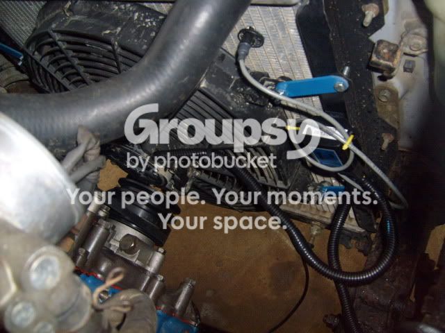

Fan installed:
S6300529.jpg~original
All wiring wrapped in split loom tubing:
S6300530.jpg~original

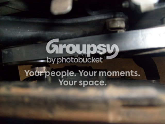

For now the permacool unit is attached to the radiator using velcro. I'll keep an eye on it and if it seems as if it doesn't hold up then I'll build a permanent mount that will screw to the core support.

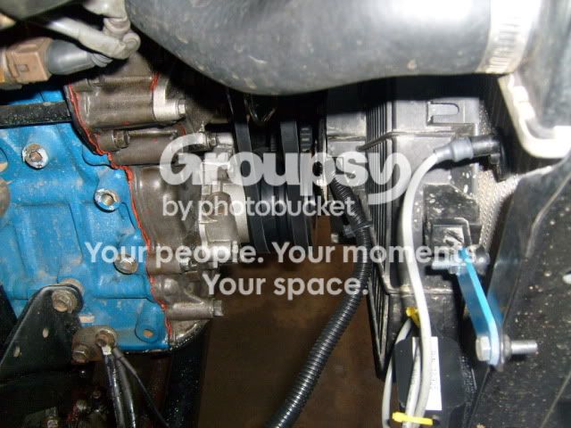

It's a little tight but everything fits well
S6300531.jpg~original
S6300532.jpg~original
So far everything works very well. The radiator hasn't gotten hot enough to turn the fan on (thermostat is set at 180*) but I used my heat gun on the sensor to get it hot enough to turn the fan on.

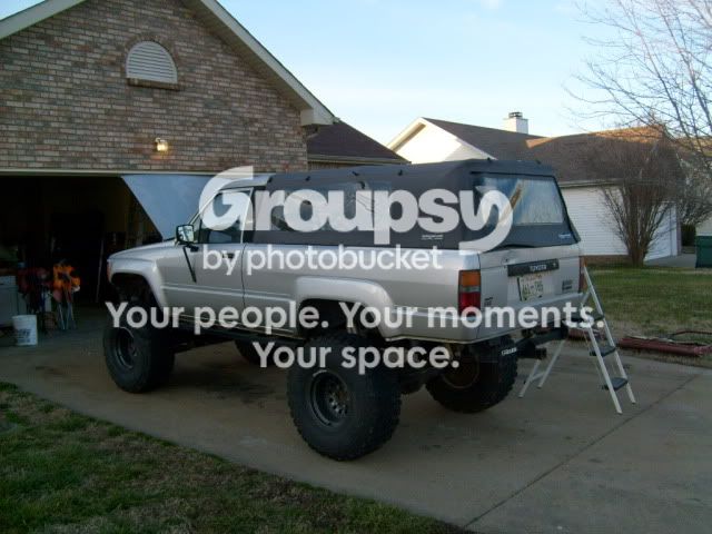

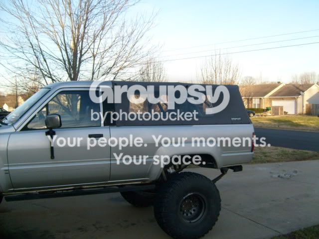

I bought a soft top in the classifieds about a week and a half ago. I just needed some dry weather to install it. Here it is :)
S6300539.jpg~original
S6300540.jpg~original
The hood is open because it's getting a set of flow matched fuel injectors... Thank you LCE Engineering! My other injectors were leaking pretty bad so they had to go!

What a smooth truck, someday when I repaint ill prob go to silver... really looking good, how is the softop in rain?
