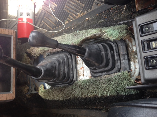

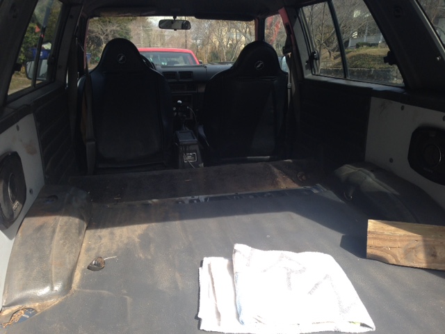

-Find some sort of carpeting/flooring solution. I'd prefer something that maintains some insulation but is very easy to clean.

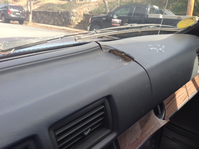

-Fix/replace cracked dash pad

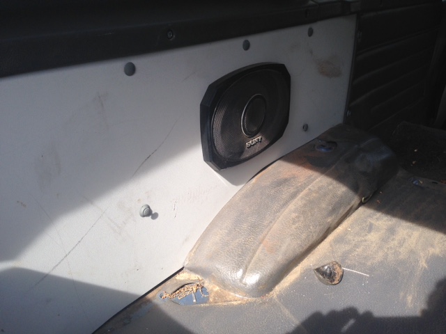

-Find and install missing interior trim pieces, Driver's arm rest, shifter bezel, dome light lense/switch. Might want or need to go custom/DIY on some of these.
-Install factory roll bar, seats, and seatbelts. I've got everything but the hardware which I suppose I can pick up at lowes? Rear seats are in decent shape but look nasty even after a thorough cleaning.
-Fab some DIY storage panels for the rear.

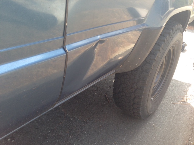

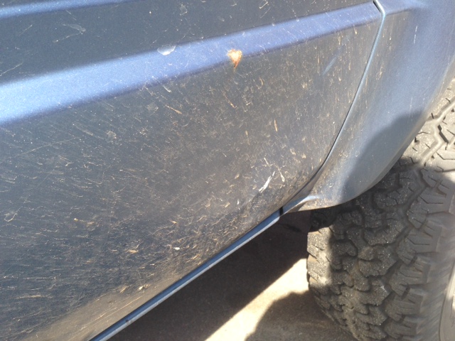

-Pull two softball size dents behind driver's side door and on passenger side door. Anyone know what is involved in getting to the back side of these panels?

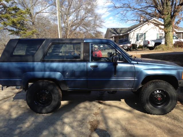

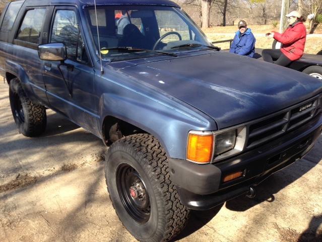

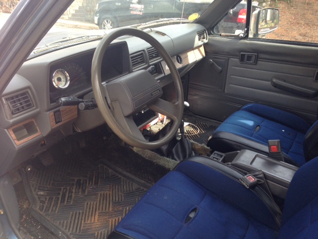

That is one clean yota! I bought my 87 4Runner when I was 15, and it was mint. Now, she's angry and decrepit! I love the shag carpet, by the way! All you need is a big fuzzy hat, a cane, a fur overcoat, a nickel plated 1911 pistol and to walk with a limp :flamethrwoer2:

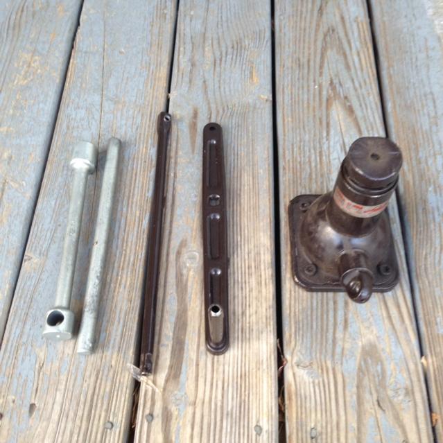

Spare tire: mine came with the spare plopped in the back of the truck. I want to put it back underneath. Looks like the hoist thing to get it up/down takes a special tool for it to work. I don't think I have this tool unless it is stored somewhere weird underneath the truck. I just have the little green toyota tool roll with the brown jackstand and tire iron.
Is there anything I can use in lieu of the factory crank? Or dod I have to go to the toyota dealership and buy one?

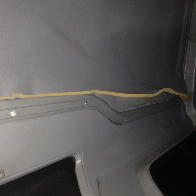

Headliner:
It looks like it's in great shape aside from where it's coming off in the pic I posted. Is it game over or can I glue it back? I tried last night but I couldn't stretch it enough to get it tucked back up under the edge.
Headliner:
You use the tools supplied with the jack (string them together) and you insert it through a hole just above the rear bumper. Seeing that you don't have a bumper (FYI) you'll see the slot it goes into if you look long enough. Then you rotate and crank it down. The previous owner probably removed the bumper and tire for more clearance.
The headliner can be glued, but if it has shrunk due to age or moisture I'm not sure if you can ever get it back. You could try applying some heat and try and stretch it, but that might loosen the entire headliner and make things worse.
Thanks for the info there. I think my tire kit must be missing some pieces or have non-original pieces because none of them fit the slot for the tire crank.

The stock piece to lower the tire is a rod with a hook on the end (same hook you use to spin the stock bottle jack). The hook fits into the slot on the lowering mechanism. Pretty easy to fab up something else to shove in there if you can't find a stock piece.

Spending has begun, just ordered a dash cap and a vinyl carpeting kit from JC whitney. Hella H4's in the mail. Another $325 worth of stuff, ufff. That should be it for pricey parts right now unless I can find a bumper I like.
I'm going to do the vinyl up front in the passenger compartment and roll on bedliner in the back. People seem to have had good luck with herculiner here but are there any other good alternatives? Maybe something a little bit smoother?
Going to take a heat gun to that fake would crap that's stuck on the dash. I also tried to drop in the seats today but realized that I didn't get the center bracket for them (4bolts). I need hardware for them and the cage. What do the tops of the seat backs latch to?
I liked Als Liner. I rolled it on in 35 degree temps and it set up fairly textured, but if you wait until it's warm enough and spray it instead of rolling it it'll be a lot flatter. You can also order a vinyl additive that makes it even flatter yet.
Updates: Either I'm missing a piece for my spare tire crank or I'm the world's biggest idiot. Will have to pick something up that works because I really want the spare back under there. I think there should be one more brown piece to slot into the bits I have.

I mentioned this on the carpetless thread but I think I am going to try "monstaliner" coating for the cargo area. May or may not coat the passenger area under the vinyl. Have not decided.

Last question for the moment, has anyone used a molded plastic dash cap to cover a cracked dash? Seems nearly impossible to find a replacement pad and I want to cover up that nasty split. Can't stand the carpet ones though.

Just got a quote for "commercial pricing" through maaco to get the two big dents repaired, the top painted black and the truck painted factory blue. I may drop it off with them on Monday.
I need to get mine in for paint eventually, what'd they quote you?
It was a bit complicated and I don't have the quote in front of me. It was $940 total. That's with two big dents repaired, $150 to paint the top satin black, and stripping the hood and the roof down to bare metal and re-priming. The paint level was the urethane paint with integrated clear and UV protection. I think that's upper-mid level. 5yr warranty I believe.
Paint itself was quite cheap, the damn dent pulls and "reconditioning" of the hood and the roof cost an arm and a leg. To give a little perspective to get the dents PDR'd in house for cost was $425.
you are missing the long piece with a "hook" on the end of it. it is also used to operate the bottle jack.
this piece is stored in the driver's side rear compartment, where the rear washer fluid bag is (and the bottle jack is supposed to be).
