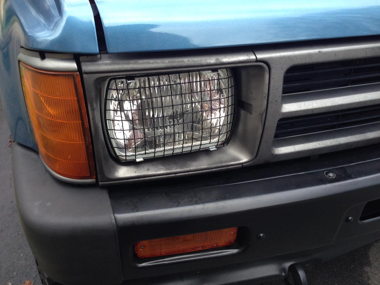

In the meantime I ignored the important stuff and popped on some hella lights and sweet little dick cepek stone guards ($9 on ebay). I Like the look and I hope they'll protect the glass lenses a bit.

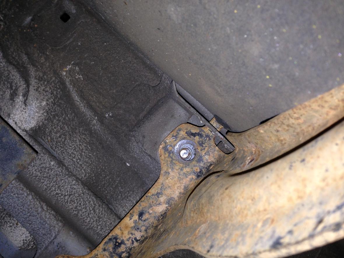

Picked up a stock rear bumper and skid last weekend (thanks ajohnson!) Was bolting it on yesterday with some slightly rusty hardware and one of the bolt heads sheared off with very minimal force. I cleaned the threads with a wire brush and was using a small 3/8's ratchet and it just broke off like it was made of cheese!
That'll teach me to buy new hardware.
There are no exposed threads, it's nearly flush with the hole. Anybody have a good bolt extraction technique to share? Preferably one that does not involve a welder.

Thanks for the link, saw a few and heard of a few different techniques through searching and talking to people around here, just wanted to see if anyone had any ideas I hadn't heard of! I just haven't had a ton of luck with extractors in the past.
