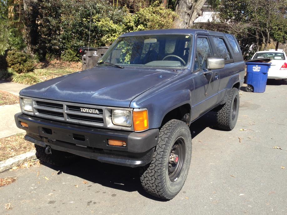

Dropped the truck at maaco, kind of holding my breath until it's done on Friday.
Hope they get the color right! Last "before" shot.

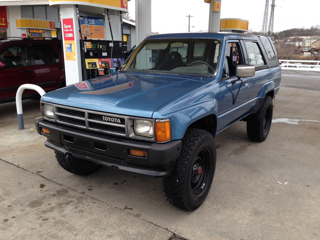

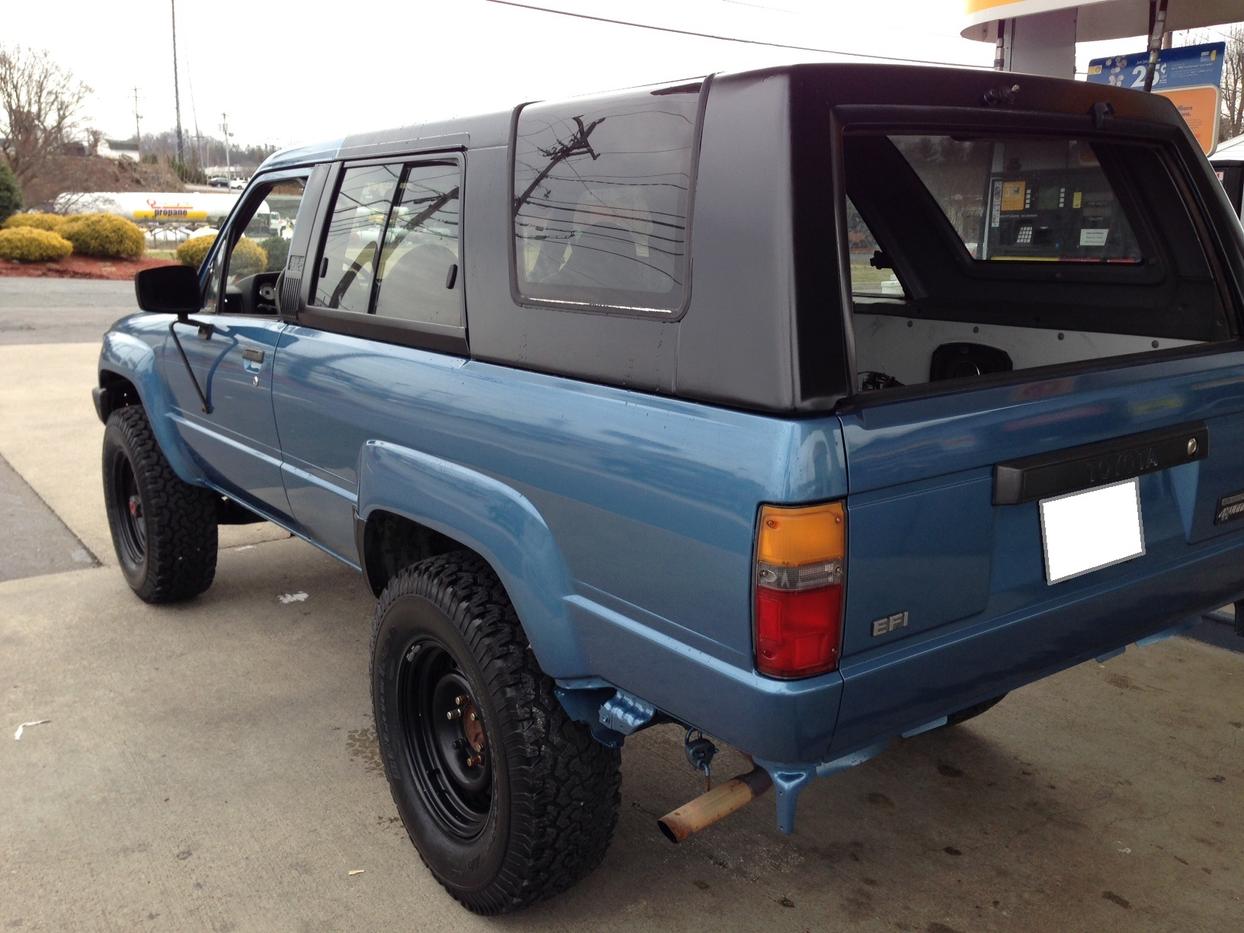

Truck is back from paint! I'm pretty happy with the results. Two large dents removed and fresh paint for the body and top. The blue looks ever so slightly brighter than the stock paint on the inside but I still think it looks pretty darn good for the money.

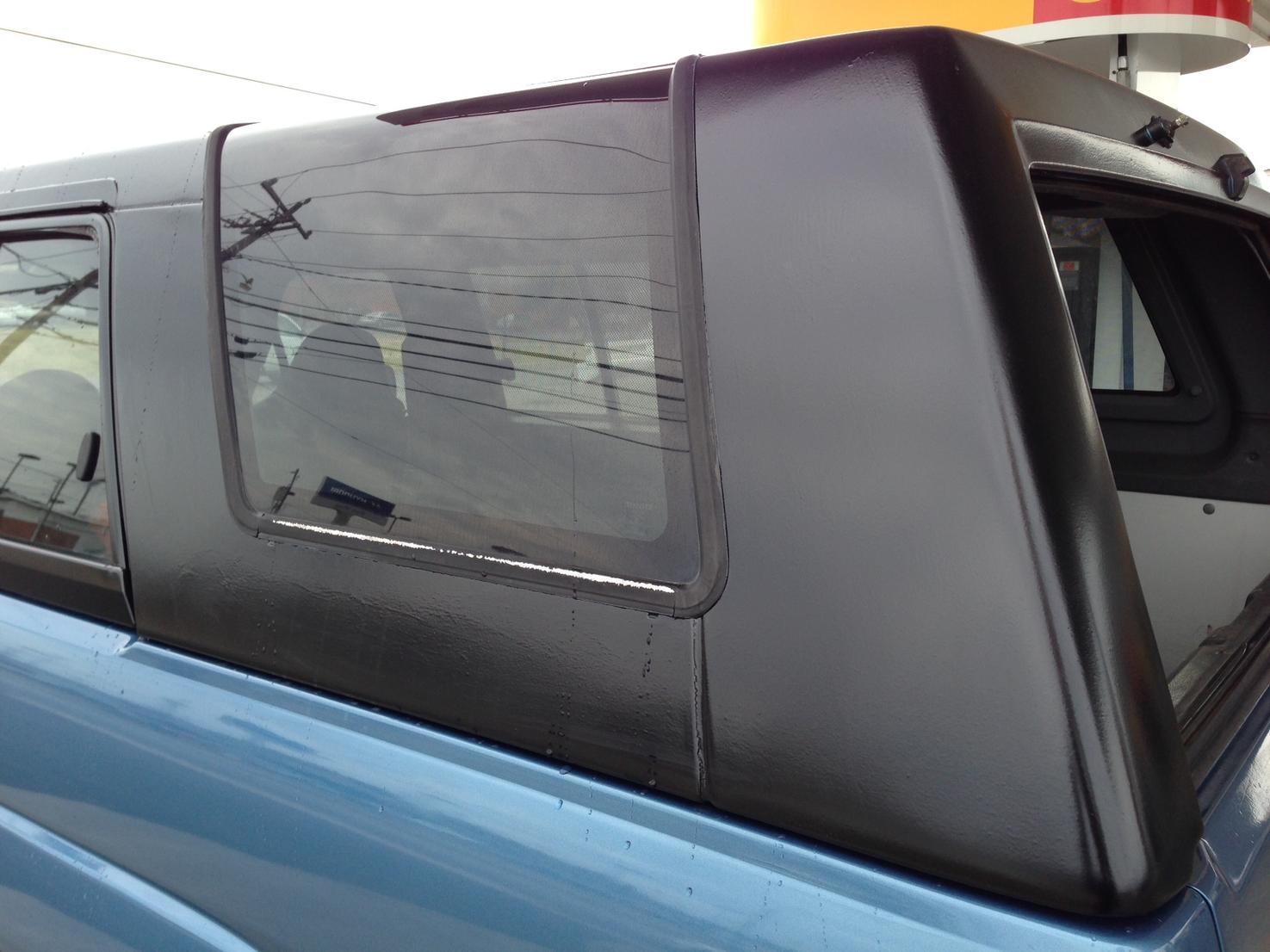

Not so sure about the sheen on the top, looks ok but I may eventually put some bedliner on it. They said they did the best they could but the fiberglass was in such rough shape before they couldn't get a perfect finish on it. I think I got my money's worth at $120 for the top.
No rear bumper stands out worse now that it's all cleaned up. Need to take care of that ASAP. Also the windshield trim is pretty awful need to fix that as well.

P.S. the things that look like paint runs on the top are actually just water/watermarks. Finish is actually pretty decent.
Need some rear bumper recommendations here. The metal portions for the factory bumper are everywhere but the plastic corner and "extension" pieces are nowhere to be found.
