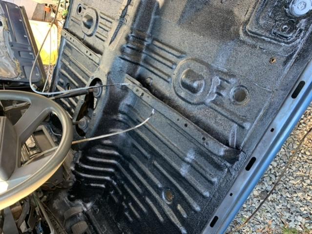

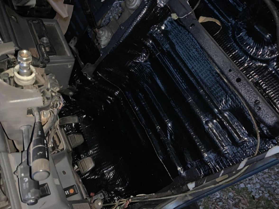

Worked on the floorpan today. Removed all the asphalt sound deadening, cut out the rust hole, wire wheeled, and cleaned. Then I applied rust inhibitor, primer, and raptor liner.
Still have a hole in my floor but rusty edges are gone, will grind it all down again and weld in a patch but for now, I hopefully stopped the rust.

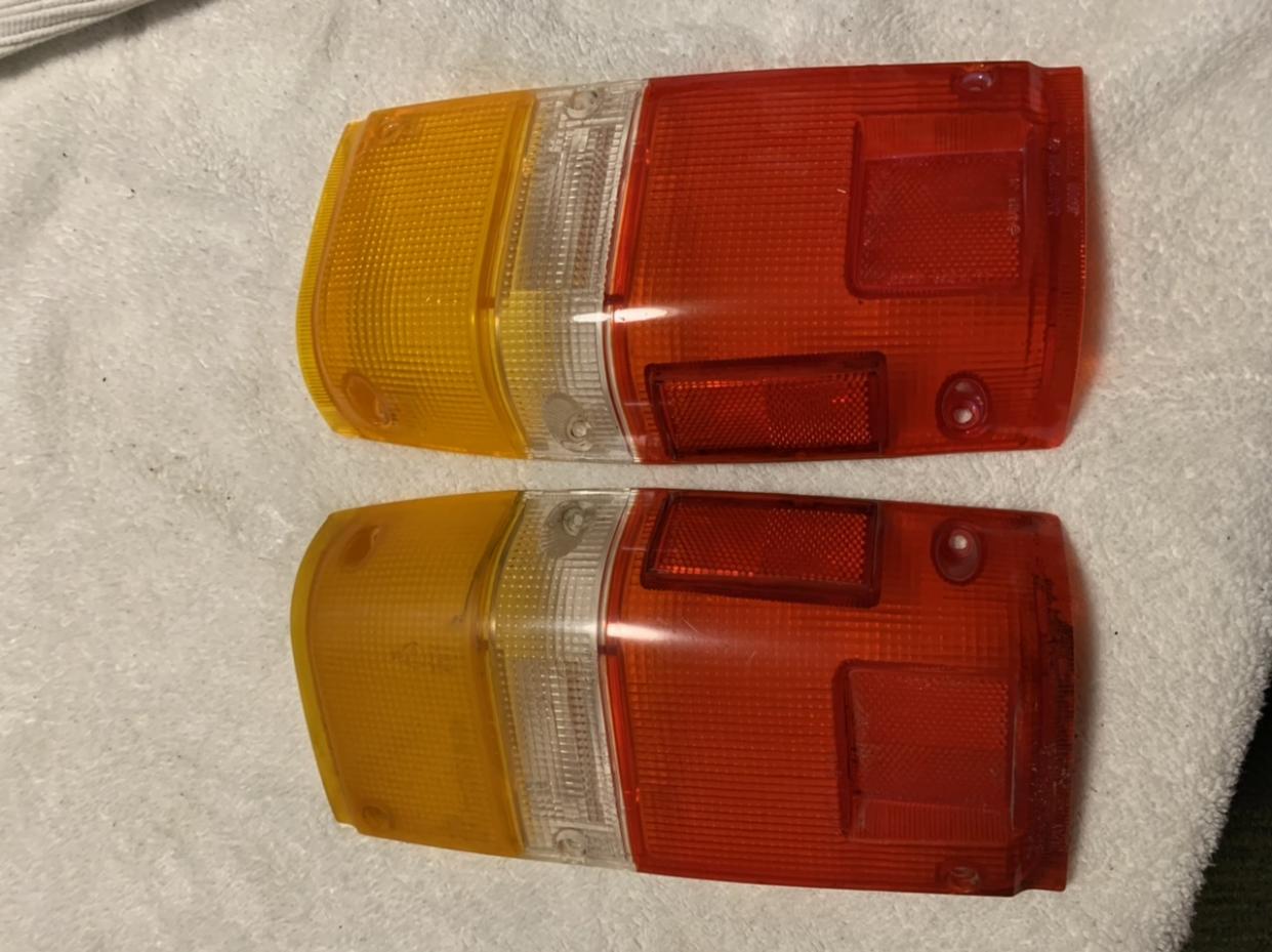

Little side project. Polished the tailight lenses while I was watching tv. Little 3m kit worked great. No more haze.

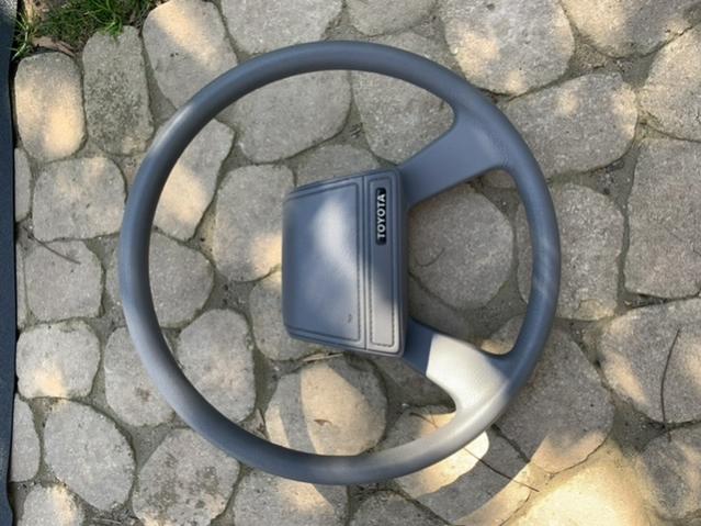

Started refinishing interior parts with sem classic coat. It looks great and I think is a good match for the original color but the contrast between old and new is so great, I may have to do all the interior plastics!

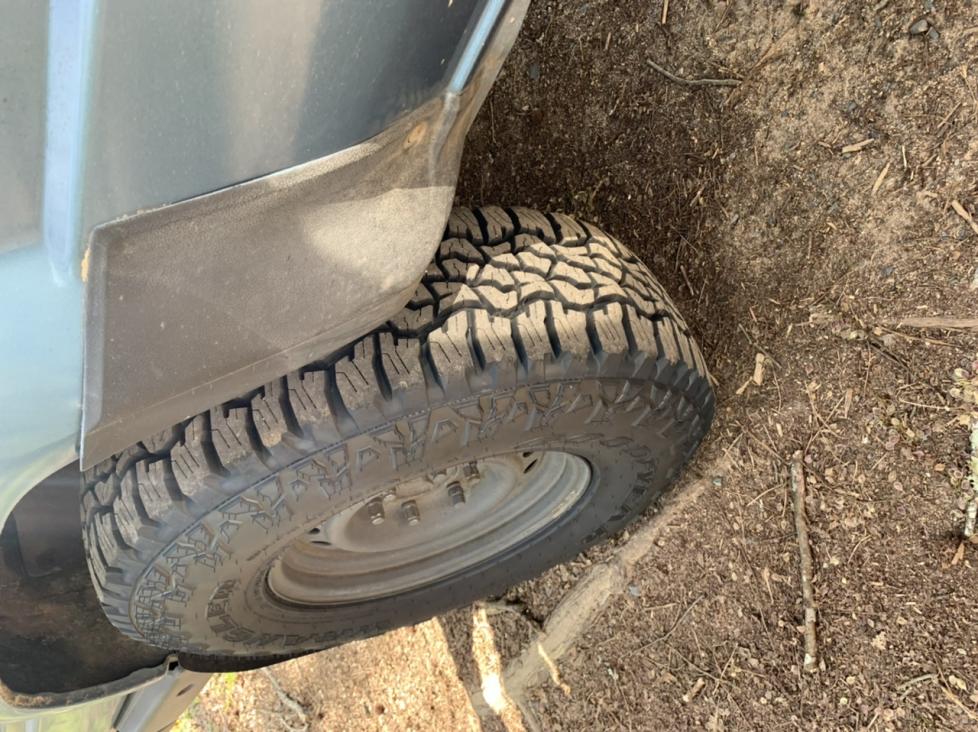

Finally got Discount to swap the 235/85/16 firestones to 265/75/16 Goodyear Ultraterrains. Decided to make the switch to go from an E sidewall to an SL for a better ride. Weight is supposedly the same at 40lbs ea.
In the short ride home from the shop, I noticed that the ride is certainly improved. I definitely miss the look of the pizza cutters but oh well.

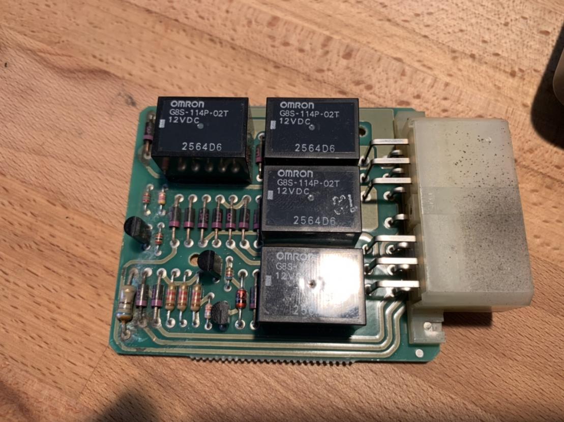

Stupid rear power widow no working again,I think I’ve id’d the burnt out resistors on the board but have trouble figuring out how to source replacements. Anyone ever repair one of these boards?
Pics of the new new tires (again). Pretty pleased with the looks and ride quality so far. Haven’t really tested the traction yet.
Any luck with the resistors? Sorry I've been absent. 3.4 Swapping the wife's 90 pickup so I've been up to my ears in wiring
I haven't started yet, still trying to source the correct resistors. I think the issue is one 680ohm resistor and two of the purple and black "3k" resistors. The 680 ohm is pretty easy to find but the 3k ones I find online look nothing like the ones on the board. Wish there was an electronics repair store nearby to help with this sort of thing.
It's getting to be soft top season anyway so I'm tempted to shelve everything and put the canvas back on. It's either that or I'm going to have to get my AC working soon to prepare for the incoming blazing heat of the summer.
So I have since found out the purple and black ones are diodes but I still don't know how to source the correct replacements.

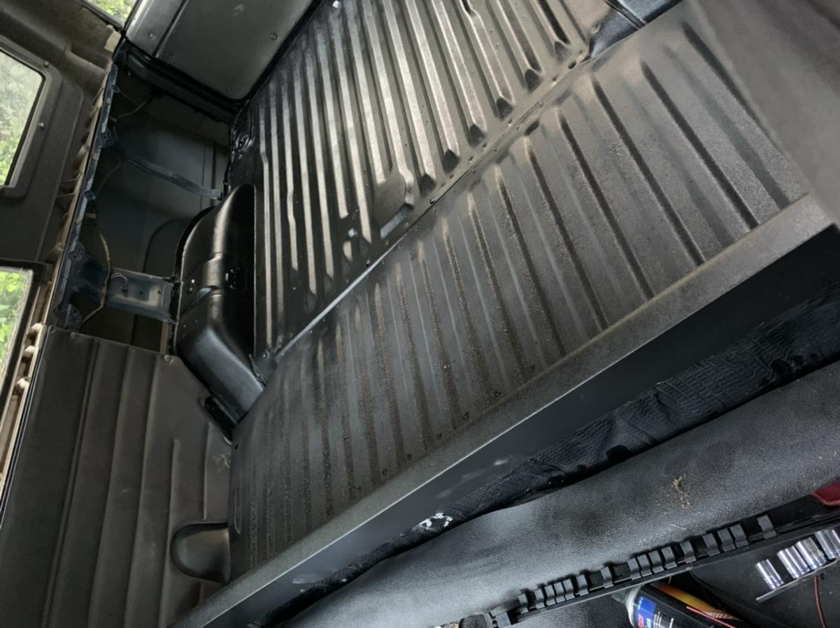

Raptor liner

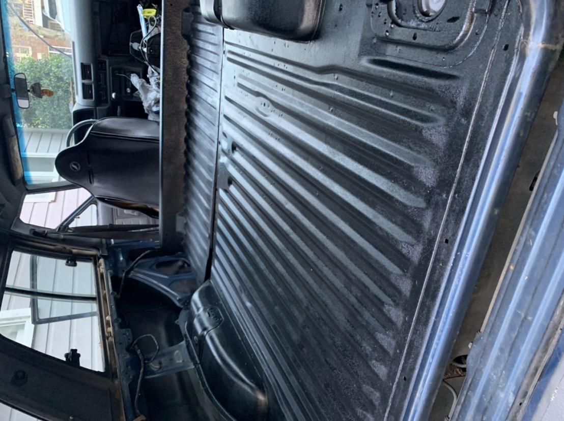

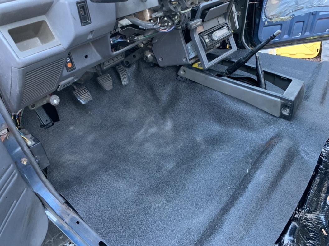

Hit the rest of the tub with raptor liner. Stuff is a ticking time bomb to work with once you mix it. You have to work very quickly to use it all before it gets too sticky and starts tearing apart the roller. Might have to purchase another kit for a 2nd coat to get the texture consistent. FYI the sheen is more consistent after curing, wasn’t fully dry in the pics.

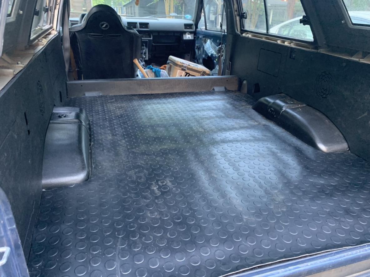

Project indestructible interior continues. I added ABS panels from key panels. They are kinda pricey but well made.I added a foam seal the edges to thwart rattles and keep most of the moisture out. I also cut a custom load space out using leftover nitrile flooring from my shed. I’m pretty happy with the results. Now I just have to make some kind of edge guard for the tailgate.
