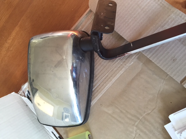

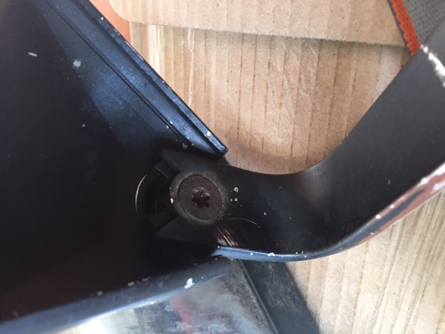

My mirror bolts don't seem to be factory, (sae sizing?) and are dripping rust all over my paint so I decided to remove them and slap a coat of paint on.
Had to remove the door card as one of the captive nuts were spinning but I got them off the truck ok. Now I want to remove the mirror from the bracket. It's a large torx bolt and I've soaked it in penetrating lube for a few days now. Still won't budge even with a pretty good amount of torque.
Am I missing something here? Is the mirror removed some other way or do I just have a super stubborn bolt?
