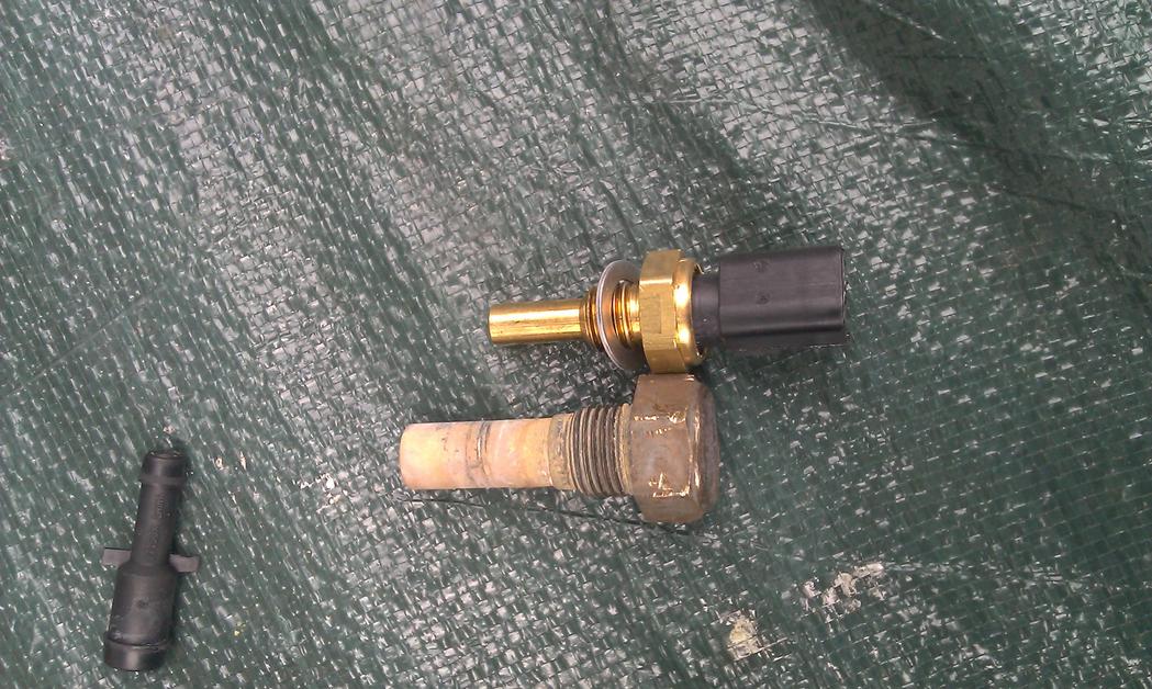

wow nobody knows why my truck has strange temp sensor broke coolent temp sensor and went to auto part store to replace the part that 3 stores had were completely different pics included. Dealer only?
threads are different size. found random sensor at advanced auto that had a shorter insert and maybe right size threads but more of them, deeper.
lost responces and am still wondering why my truck has strange part.
still hard to verify, most pics don't tell thread size, or show connector grooves. Mine are across from each other not offset at all. What are the ramifications for running any distance like this?
4fishrunner, your truck has 2 coolant temp sensors, 1 for the gauge and 1 for the EFI.
Which do you need, and are you sure the parts stores are looking up the correct one?
You may have to try the dealer, and if you do, have the VIN and build date handy, it can make a difference.

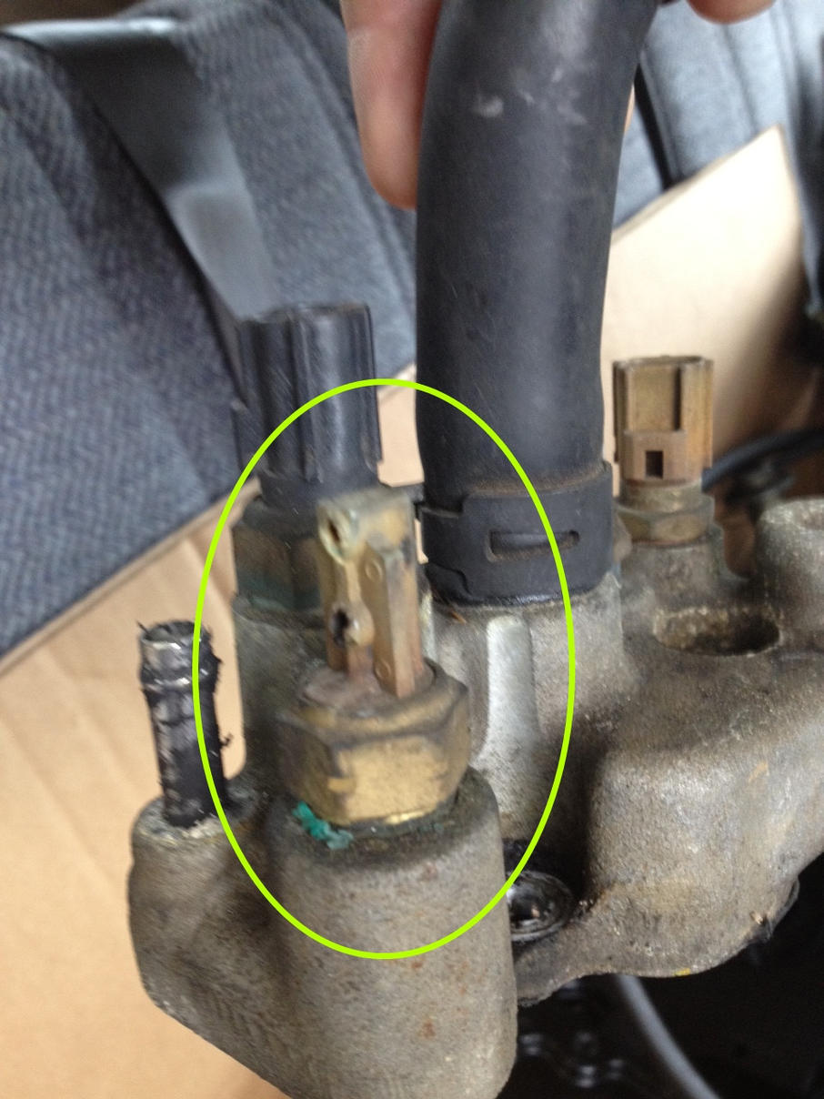

The question goes on three names for same part
Rockauto sent me the wrong part, so i went to dealer and they said part number is this, and it is called COLD START MODULE, $200. looks right, took part number to computor on Rockauto site they call part EGR Vacuum Solenoid, called manufactor they call EGR TIMEOUT SWITCH or thermal time switch. am going to Pull A Part as after seaching forums nobody has had this problem ever so maybe a used one will work. Oh yeah, says this part is only to 1993 and mine is a 94! must have been built in 93.
The Beat goes on!!!!:bash: att shows part, large sensor next to water hose not circled one.
salvage yard efi sensor, installed new sensor from rock auto, truck still runs rough after warmed up. no codes until drove it hard punching it when it ran the rough, finally got a cel 14 and 25. cleared code to see if I got it again easy. No way, can not get code again, truck still not right. any thought?
