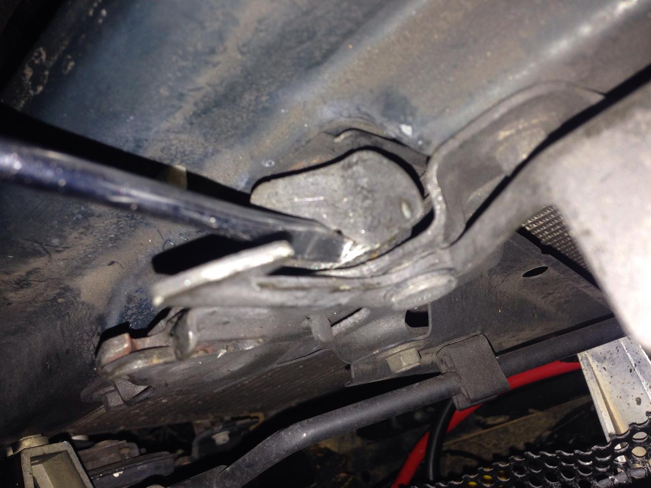

Think u have the same problem as me. When I get off work I'll take a pic and show u what I have to do. It's very simple. Take a screw driver and push that lever that is stuck in place down then try it
Spenedwrds is right. Small screwdriver and pop that little lever/latch back. Even when properly lubed mine still does it and my old 3rd gen did as well.
In my case a good amount of Super Clean sprayed in the mechanism cleared out the grime and the latch immediately worked again though I did followup with a lube after. That was 2 weeks ago and still working right.
Put a screw driver in this spot. Push down and it should pop. You'll here it. Then shut the hood and it should work
