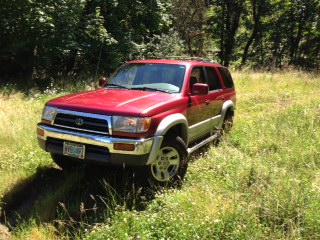

Its been a while but I am back.
Shortly after that first post I replaced the radiator cap. Apparently my mechanic didn't replace that and I didn't think of it. The old pressure release radiator cap wasn't working properly and too much pressure was being created. I replaced the cap in January and I haven't blown any coolant since. The old girl has over 200k now and runs as good as she did when she was new. :)

I'm glad to hear that's working out for now. You should be aware that if a faulty radiator cap was causing enough excess pressure in the cooling system, to cause a headgasket leak, and replacing the cap stopped the headgasket leak, then the seal created by the headgasket is tenuous.
The plastic caps on the top and bottom of the radiator, or the rubber hoses would give up, before a properly sealing headgasket.
I hope it holds up for years, but keep an eye on it.
